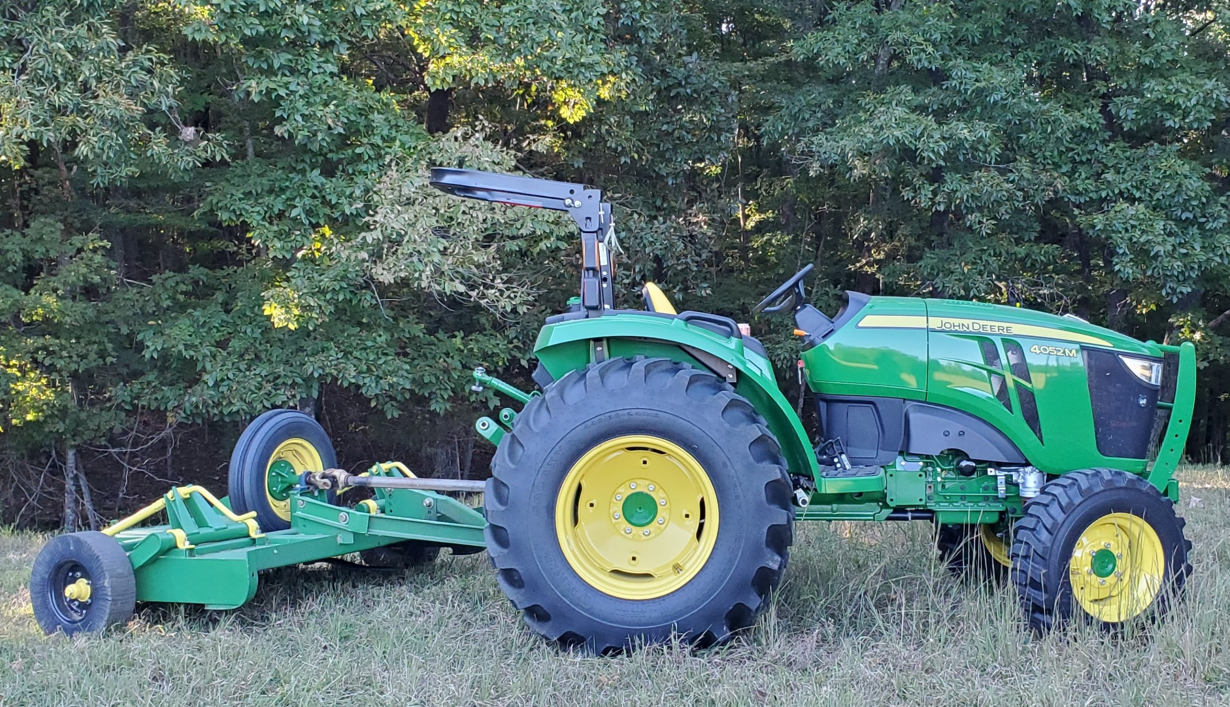

Well it does appear that replace those 2 parts helped as we have ran it twice now with no issues. We just ran it 6 hours straight and when I shot all the components with the heat gun, they were 160ish-190. Not a single one was over 200. I would say it was definitely overheating! Hopefully this will be a good tractor for us. Here is a pic of the tractor with the bushhog. We did paint the bushhog to match the tractor!

I see from your photo that there is no loader mounting frames on it. WHen did the loader get removed? Was it before you originally took delivery? If so, my guess would be that the dealer didn't connect hydraulic lines properly or maybe didn't remove an internal pipe plug when loader valve and joystick were removed. This would have caused the hydraulic pump to stay in relief which would have caused the overheating and also extra fuel consumption. Does fuel consumption seem better now? Probably have better power also.
/ New 4052m Hydraulic temp light.
#39
Hi! Sorry I just noticed this. Yes the loader was removed before we got the tractor and yes the fuel consumption is half of what it was. We did not notice a difference in power but then again we were not using it hard. We just mowed for 8 hours with it and used a little over half a tank. Before we were using 3/4 of a tank in 3-4 hours. Also, we shot the same components again with a temp gun and nothing was over 200, I think the hottest we found was about 190.
