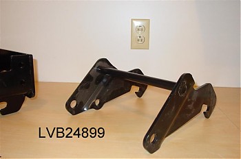

It's a really nice day so I figured I'd try to mount the 62" mower under my new 2320.
I quickly realized I do not have the front bracket to mount the mower. The salesman told me all the stuff I need is there to mount it but he is WRONG, I need the LVB24899 bracket to get it hooked up.

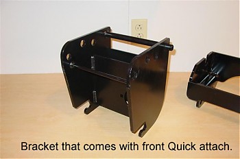

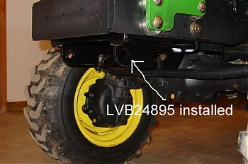

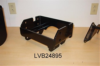

The rear PTO shafts are generic, and often to long so they need to be cut to fit properly-sounds like they cut your to short OR you added an iMatch after the fact which move the tiller rearward about 4". You can but an extension shaft for about $20, but they need to get you a new shaft.
1. Since you have the front QH (quick hitch) for the snowblower, they you should already have the LVB24895 bracket, it mounts up between the frame rails with the same 8 bolts that hold the brush guard. To mount the MMM you will need part # LVB24899, it hangs in the LVB24895 bracket and provides the support for the front draft arms of the MMM. Without the QH, there are just two simple brackets mounted-but you have to remove them when you attach the LVB24895 that holds the QH.

I found good pictures, posted by Green4me on MTF:

I also found the part # of the bracket that I need (LVB24899)
I told the salesman about the issues and told him I have the part# for the bracket, he said he does not need the part# and they have a bracket for me that he forgot to bring with him.
He said he would try to figure out the issue with the shaft.
I have my fingers crossed.
