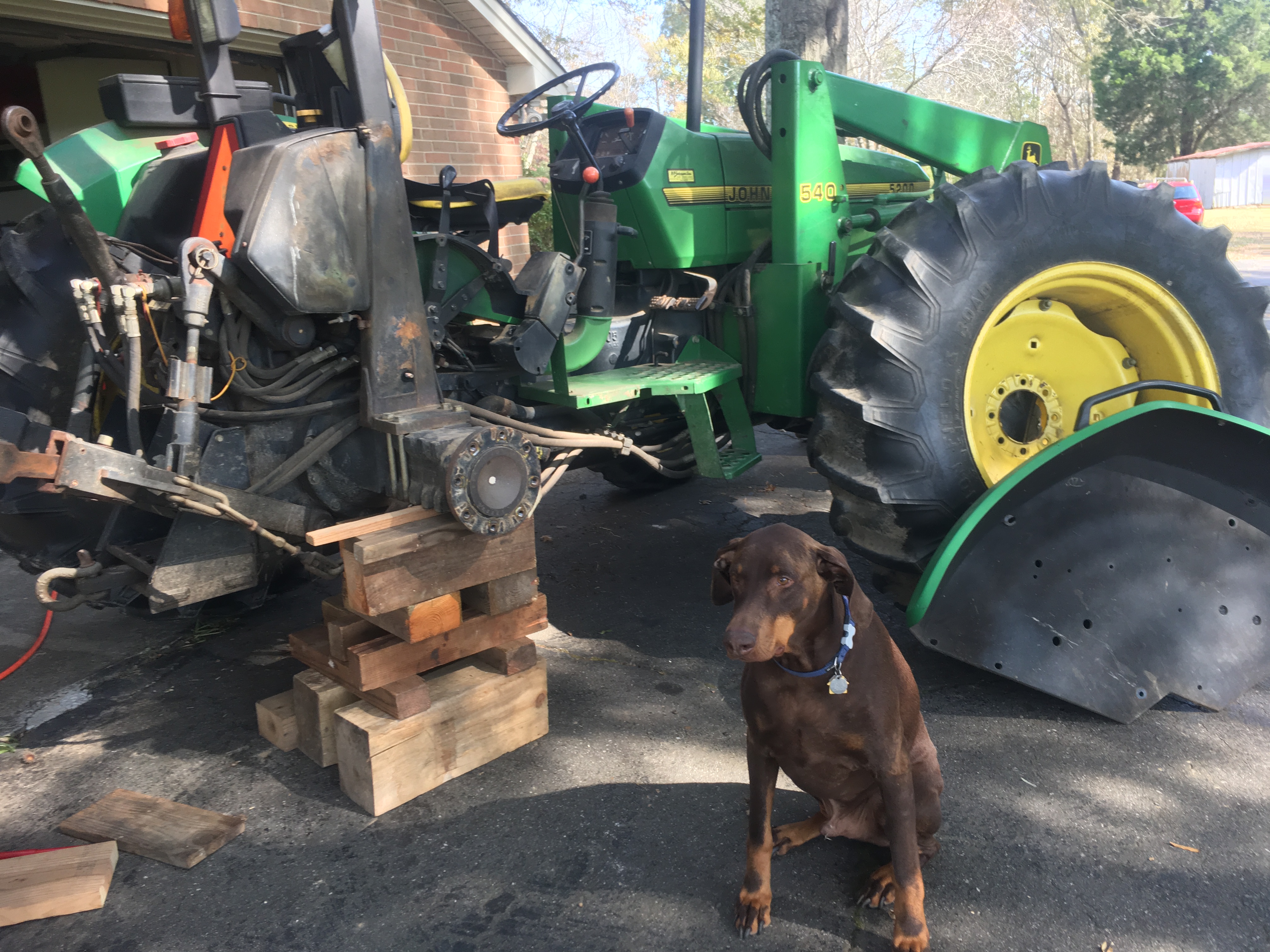

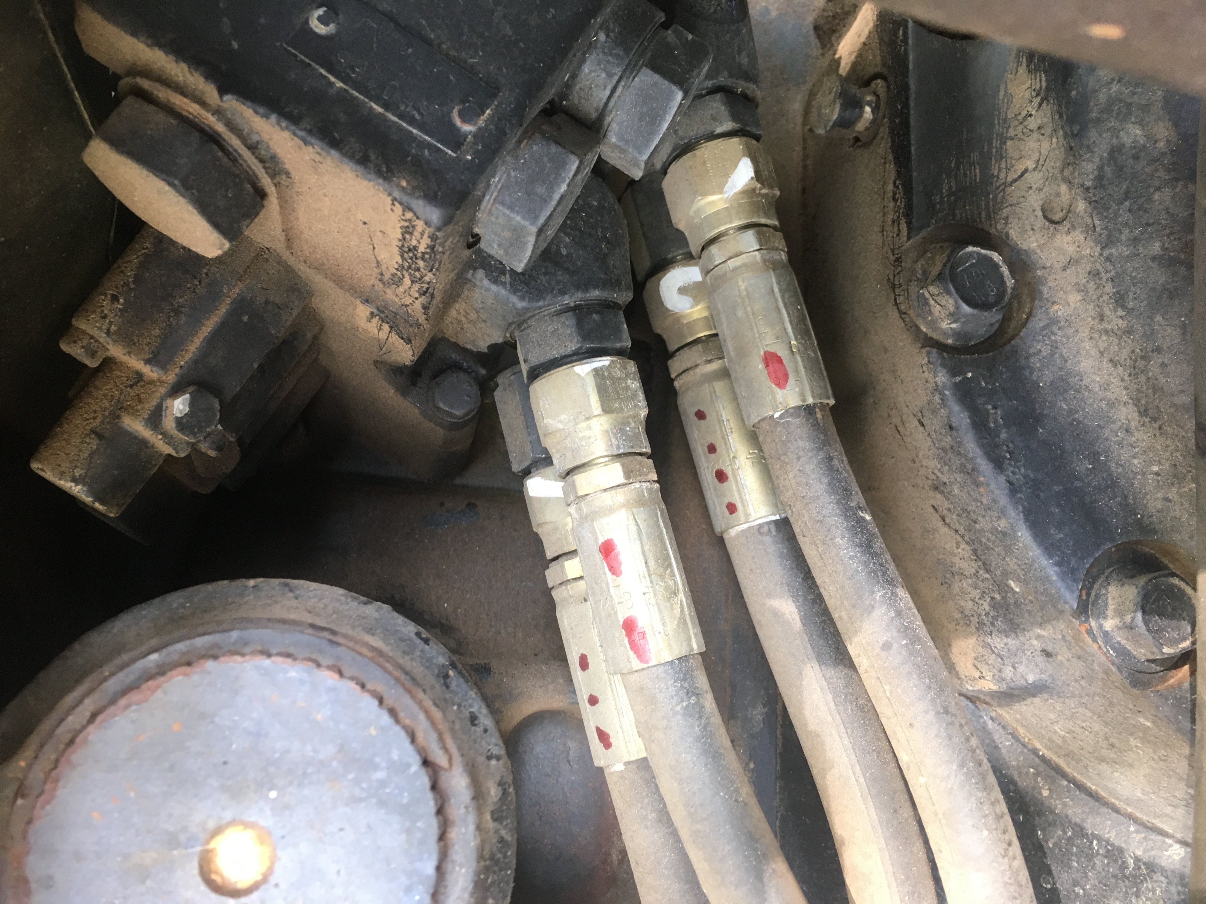

I just finished a third SCV on my 5200. It wasn't easy, but the Deere instructions and parts were first rate. Everything fit.
You might ask the dealer about the kit for your tractor. It'll be less cost than buying individual parts.
