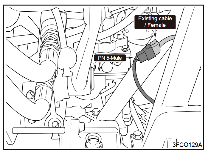

My factory 3rd function kit was supplied and installed by the dealer. :mad: I don't have the paperwork/instructions.
I recently purchased and installed the rear work lamp. Turns out, the dealer used the lamp wire bullet connectors as power for the 3rd function.
There are several connectors on the 3rd function harness. Is there a dedicated connector in the tractor factory harness, or do you just tap into any hot lead?

Not a great reference guide, but this is what Kioti shows

on my dk45 i just tied into an existing circuit in fuse box, than i added a rocker switch so i can shut the device down when nothing is attached so i wouldnt deadhead the circuit.
It takes very, very little power, so you can just hook into that circuit for both devices.

I found what I believe are those connectors, but they appear to be the 3rd function main harness to the sub harness connection, not a separate supply.
I'm 2 weeks into a hip replacement, so I shouldn't be crawling around outside. I'll dig into it some more after Dr releases me to more activity.
I was hoping there was a connector under the inst panel. When I installed my cruise control, I think there was an extra connector. Might be for linked pedal? If not, I may still reroute to the fuse block. Good tip on switchable power supply.
