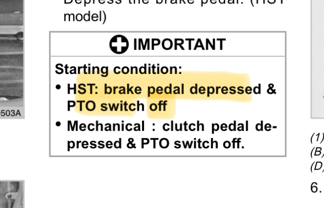

I’m not familiar with your model, but looking through the owners manual for it, I couldn’t find where putting it in neutral was a starting requirement, only that it’s recommended.
Twice, the manual lists only these two prerequisites. 🤷‍♂️
It does need to also be in one of the Neutrals.

Don't have the manual in front of me but for my model starting in neutral is required, states this in the manual and experience it on the tractor - it will not start unless in neutral. And if I get off the seat it will shut off unless it's in neutral.
If the seat switch is intact, getting off, must be in neutral and parking brake engaged.
To start, must be in N, seat depressed, and brake on (it doesnt care if parking brake or brake pressed), and on mine, clutch in.
To be honest, I feel the brake on, and Neutral, when getting off, is a bit redundant, and annoying, if gettinf on/off a lot. Its not the end of the world, but it is annoying. If you by pass the seat switch, it never realizes your off the seat, so both are neutralized.
Start up, I could see N and break; or clutch, and ignore the seat.
But, as i pointed out, dog jumping up and hitting the forward peddle kinda changed my mind. When from a no brainer to remove, to, ehh, maybe, maybe not. Worst part, for me, with seat switch, standing up to do delicate moves. Be nice if you had 30 seconds. Someone on a post once, mentioned they had installed a seat safety over ride switch, that you could press and it eliminated the seat, engine kill, for like 30 seconds or 5 minutes or something.
