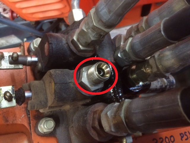

As I see it, the valve itself has oring fittings on it and piece sticking out of the valve (circled in red below) is an oring to BSPP (or whatever it is) adapter.
If he goes on the valve side of the adapter, he can use a cheaper/easier to find oring tee and then re-use the existing oring to BSPP adapter:

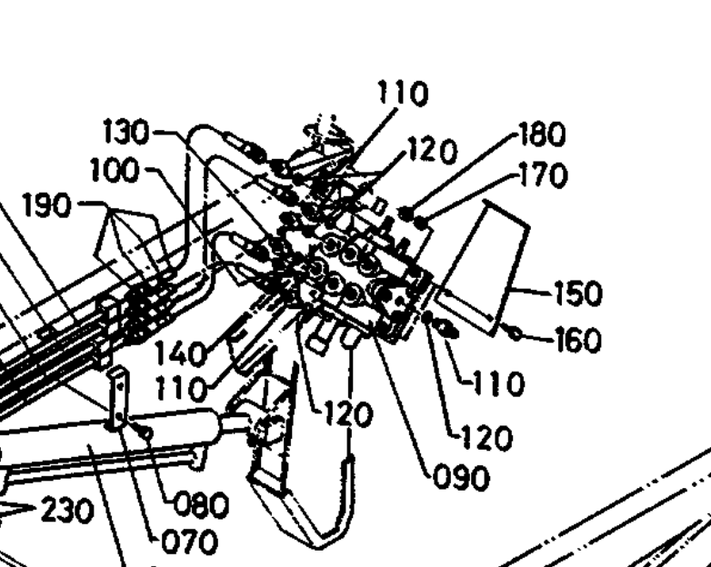

Here is Kubota's parts breakdown for that valve:
Parts 110, 120 and 130 are as follows:
PNNameQtyWeight
11070726-61130Adapter50.121
12004811-00140O Ring60.0022
13070726-61150Adapter10.176
Part 120 (the orings) are between parts 110/130 and the valve.
As such, I am 90% certain the fittings sticking out of the valve are Oring to BSPP adapters.
