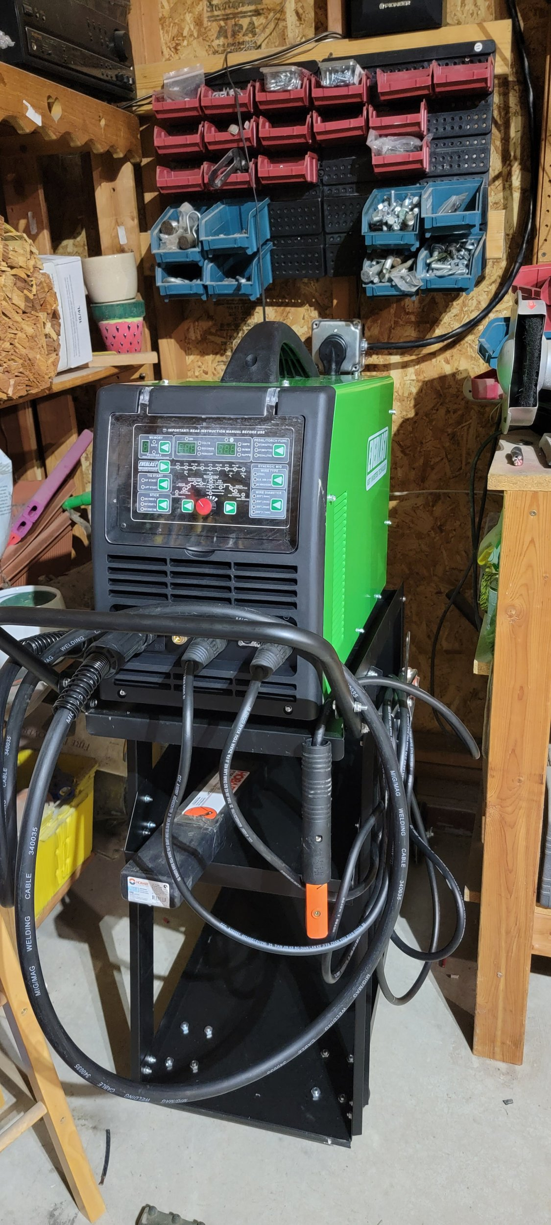

Wanted to update this thread. I took the advise posted here and decided to run a 100amp sub panel into my garage, with a 60amp circuit off of that for my new welder. I did some research into how this is accomplished and soon realized that I'm in over my head. I can run the wires, but hooking things into the panels is beyond my knowledge. I called a residential electrical company to provide a quote. Two weeks later, they finally showed up. Looked at my project and said "Oh! This is really easy!" and then quoted me $4,127 for the project!
At this point, I've already priced the components I need, and the total was just over $700. I denied that quote.
Fortunately, my friend who is a retired electrician was able to help me. I purchased the components and spent the afternoon this last weekend installing the sub panel. Got the circuit ran and all is well. Last night, I finished putting together the welding cart from Everlast and put my new Everlast PowerMTS 251Si on it!
Thank you to everyone who commented and helped me figure this thing out. I cant wait to get to work and get some projects done!
   / Need Your Thoughts On A New Welder #47
As a general note. The new panel was a great idea and great investment especially at the right cost. Does your welder come with a plug and cord? If its hard wired and comes 10 cord or better then a 60A is fine but if you use a 50A recept it should have a 50 breaker. There are some machines it really wouldnt be an issue but really a 50 outlet should have a 50 breaker due to machine design.

Yeah, the only reason I went 60amp is because of availability. I may downgrade it when I find a 50amp, but everyone was sold out around here. I contacted Everlast, and they said a 60amp will be just fine. The welder itself has a breaker on it too. Not sure the rating, didn't look that close. I think I'll be fine. I hope I'll be fine. 😬
   / Need Your Thoughts On A New Welder #49
Probably is. If it has a number 12 cord sposed to be on 50. Its not that big a deal, I only mention it cause its a subject with lots of confusion and a lot of opinion that isnt very code compliant.
