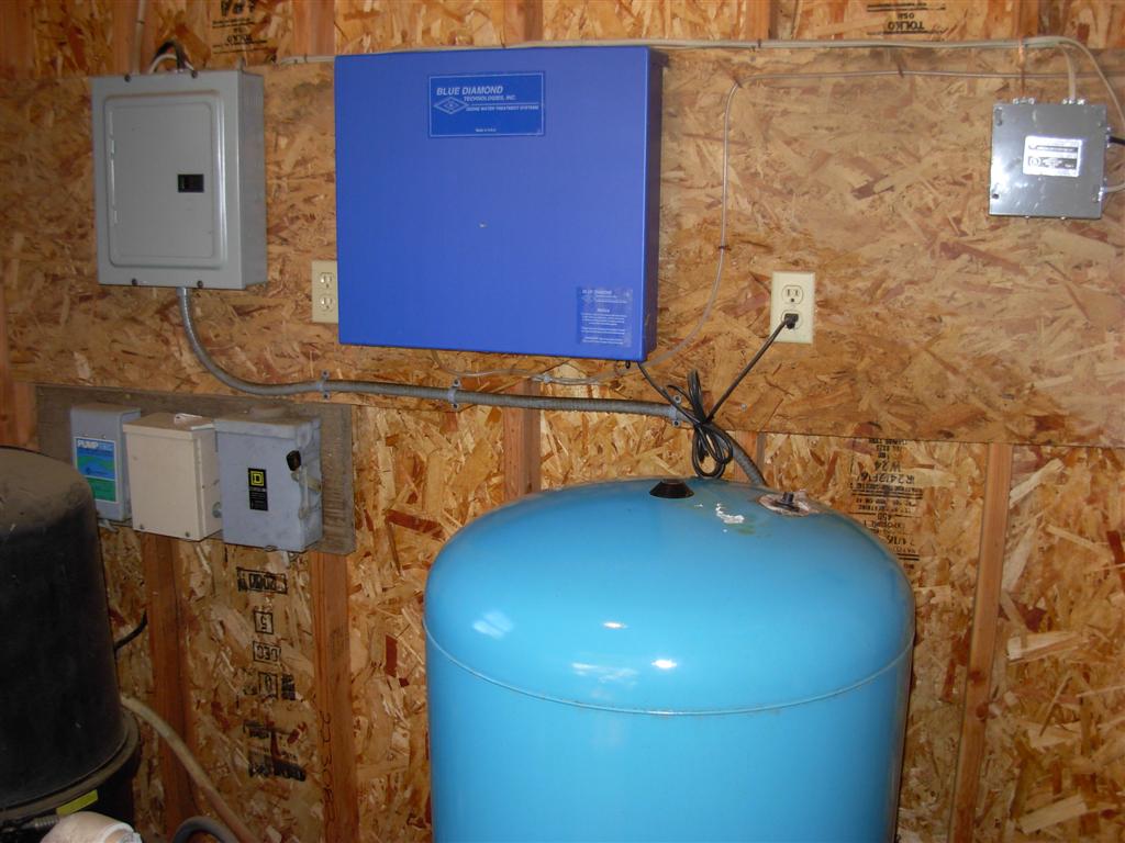

I put together an Ozone system that works great. The Ozone equipment I purchased but the overall system is my design.

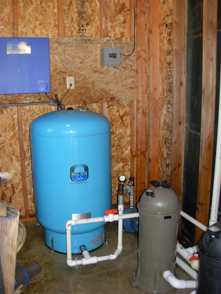

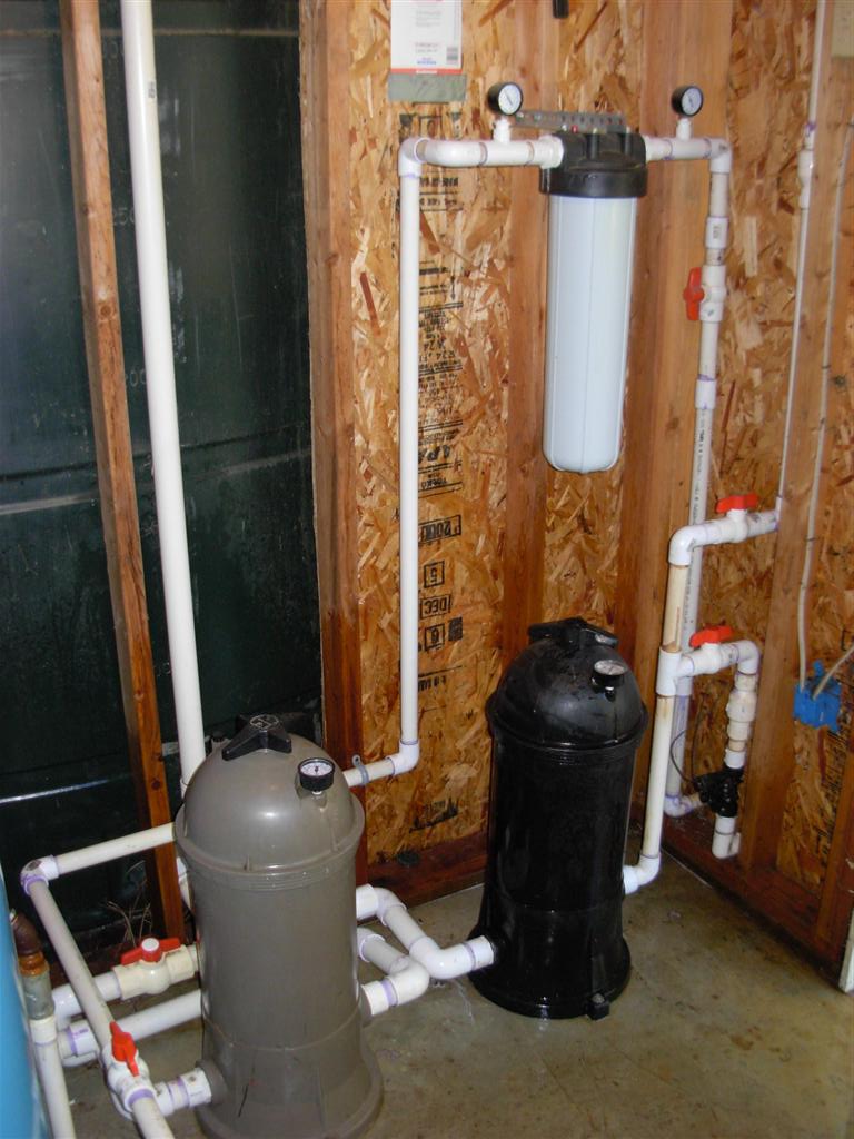

All my water comes from two wells. The water has always tested satisfactory for levels of bacteria.
The problem with the water from my wells which is common in this area is that the water has a lot of different minerals in it. Unfortunately I never tested it to know exactly which minerals and quantities of each, but I didn稚 need to run any test to see the water was cloudy, and the clothes coming out of the washer would have what looked like rust spots/stains on them, the water smelled bad when you took a shower, and you would never want to drink it. At first I tried putting filters at the kitchen sink plus reverse osmosis and filters on the washer but all that was just a big PITA constantly changing filters.
Ozone is an oxidizer which is more powerful than chlorine and has many benefits over chlorine. Ozone equipment suppliers will include a CYA disclaimer statement in their websites that their equipment is not to be relied on to kill bacteria, and the reason for that I think (just my opinion) is because a poorly designed or maintained system could be ineffective and they don稚 want the responsibility. Since my bacteria levels are ok already, that痴 not a concern. What I wanted was to deal with the minerals and it does that very well.
One feature that was important to me to design into my system was minimal maintenance, the least often I had to deal with it the better. Ideally I should clean my filters every 4 month but I never get around to doing it that often and it works fine. The water is crystal clear and taste fine, although I still prefer the taste of bottled water.
