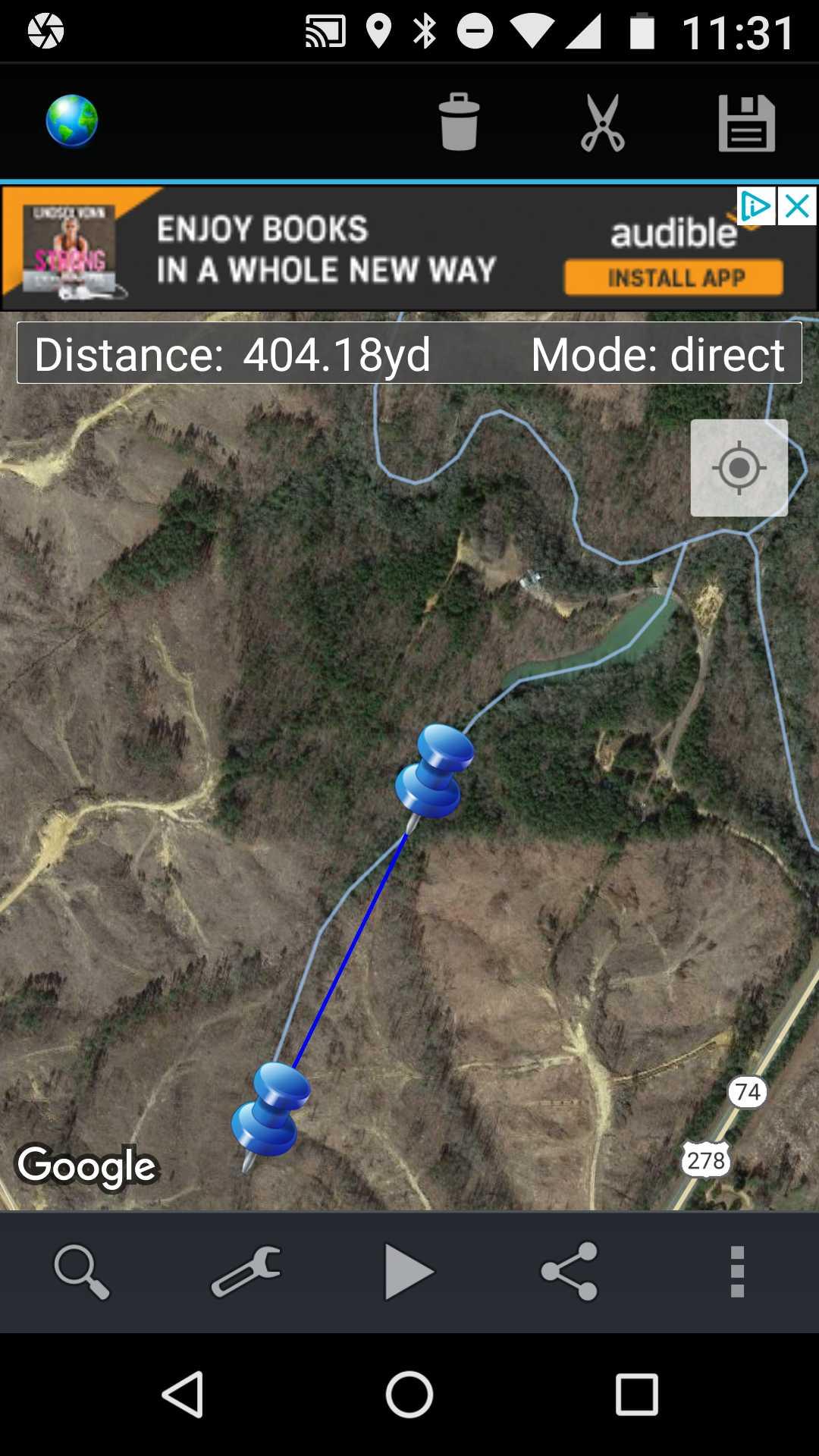

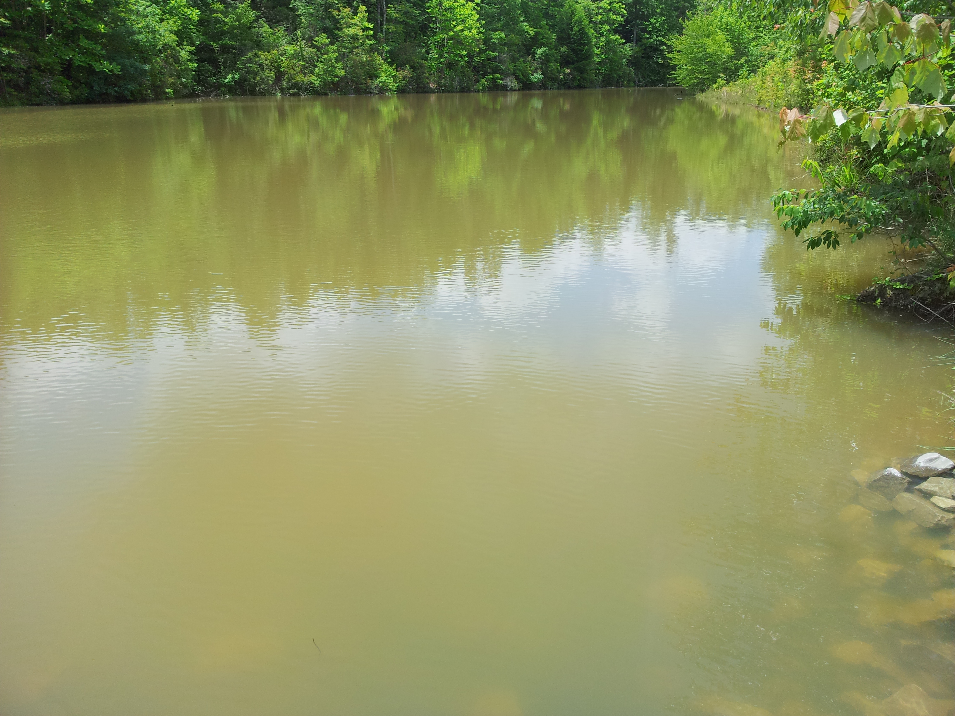

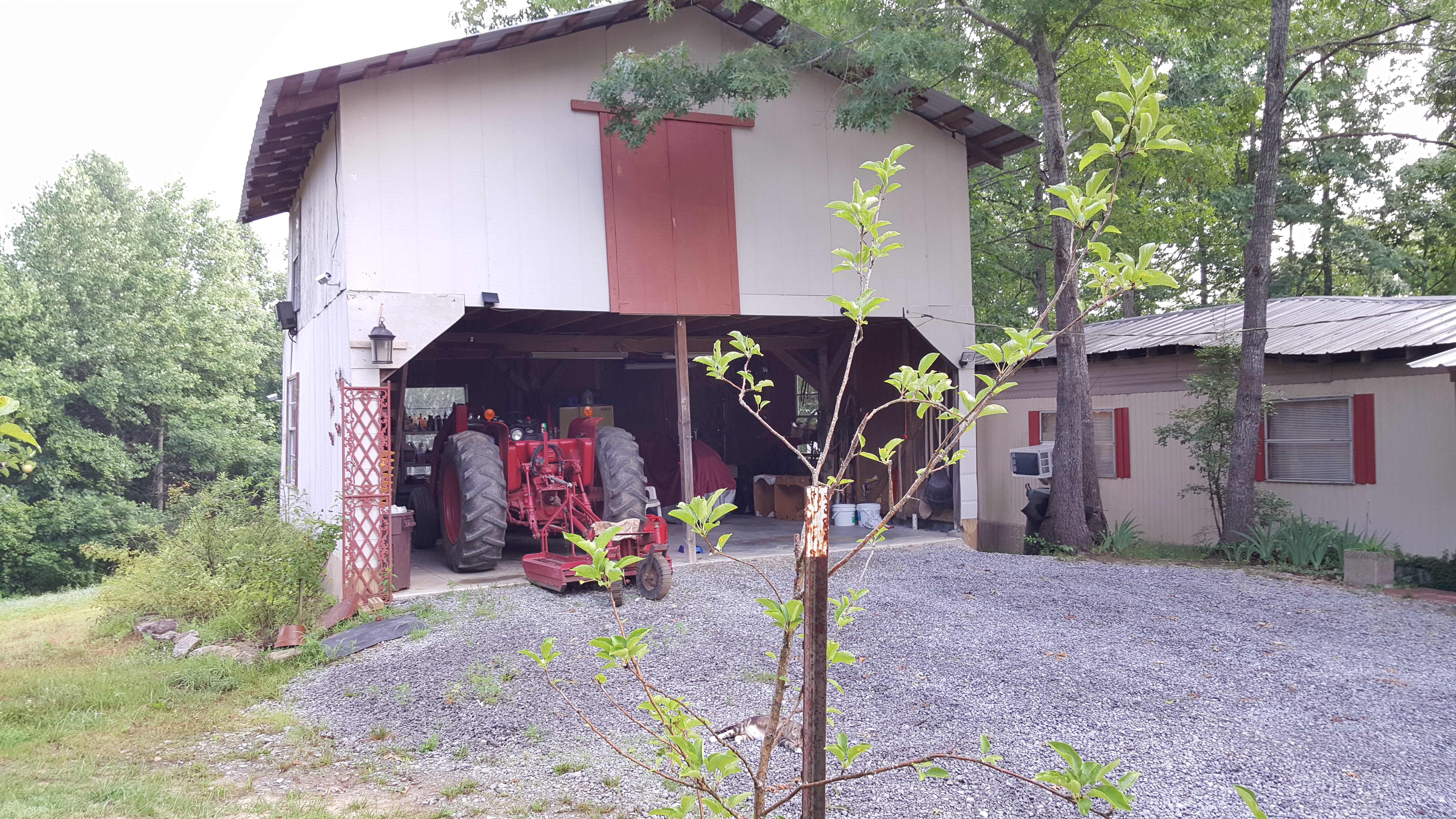

According to a phone app. the distance between my barn and the closest part of the pond is 277 ft. I figure I can run underground power down there easy enough and bury next to it a pex pipe thus utilizing a submersible pump to push the water up to the containers with a float to cut off waterflow once containers are full and turn off pump each time we depart.
Now I must figure out needed wire gauge for the 280ft electrical run and the right size of pex pipe necessary for quick effective refills...or I can even utilize the 3/4" tubing I already have at hand. Decisions decisions LOL!

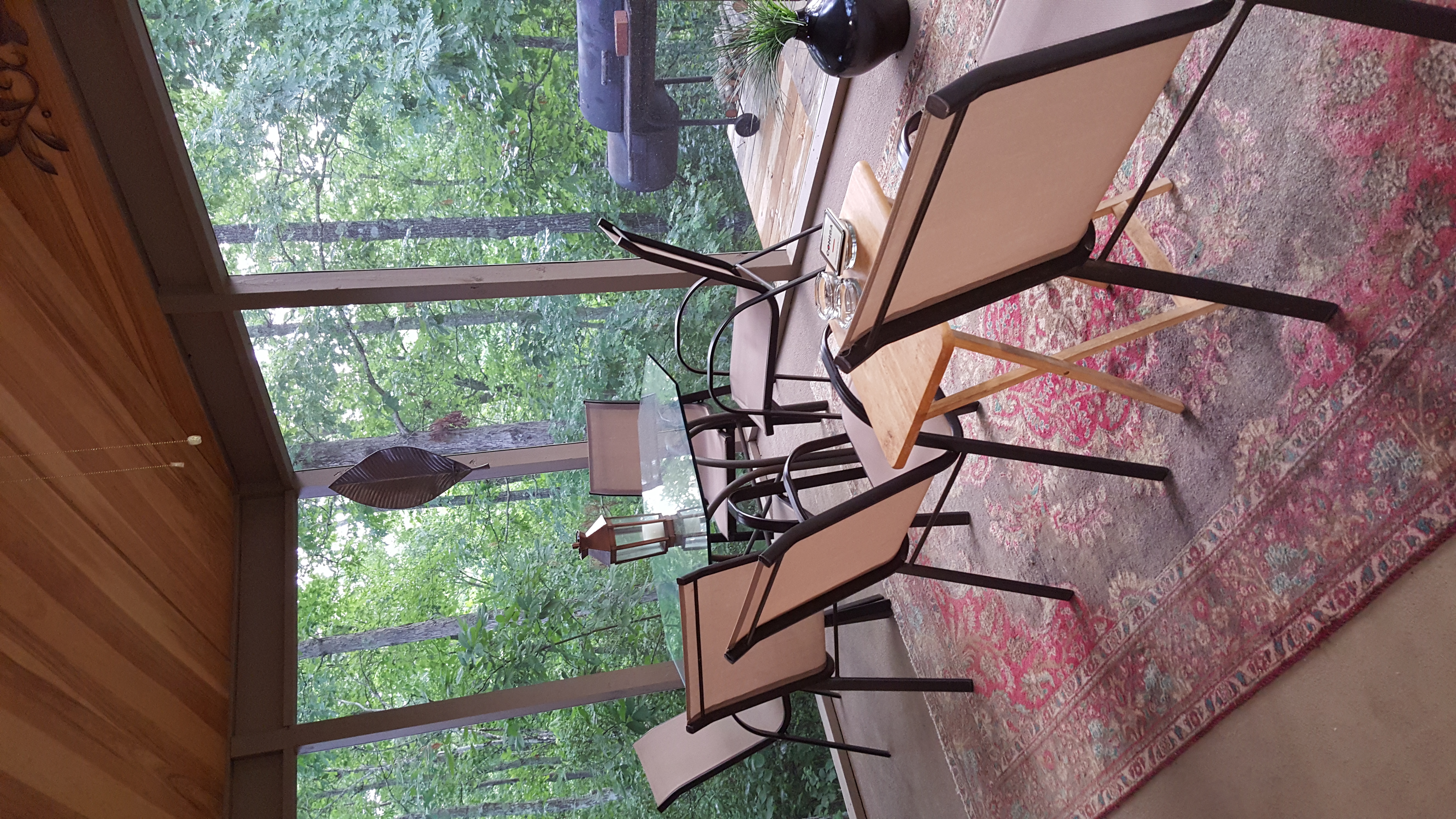

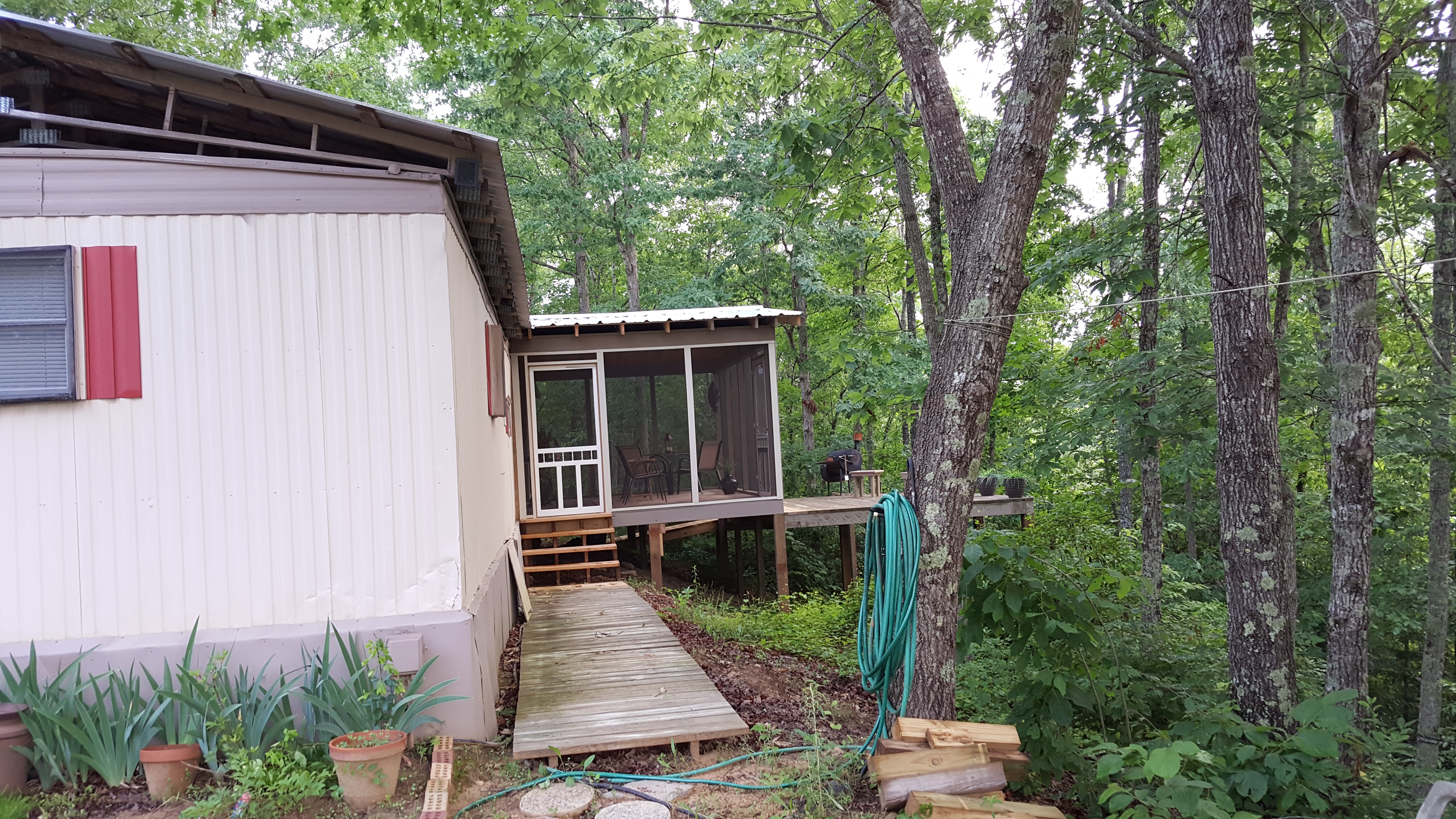

Pretty views. Keep in mind to allow for wire running up or down from the BOTTOM of the ditch into your control panels or boxes. Also your ditch may not be as straight as you prefer when your done. It all adds to the length of the wire.

The water line is on this side of the mobile home View attachment 538853

No idea why anyone would want to pump frog p|ss out of a pond for use . Start off with a sand point near the buildings. .

Buick, thanks for the good morning frogpiss chuckle....and as for the fish, they do more than poop in it that's why I drink single malt LOL!
Still studying/figuring before I jump in with both feet. A second problem which I've not mentioned is balancing the filter with the 2nd pump that'll push the water to the house, plus I'll have to come up with a way to evacuate all of the water, or keep it warm, within the house in the winter months because there's not heat in the place when we're not there and the last thing we'll need is breaking pumps/peripherals.
