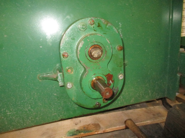

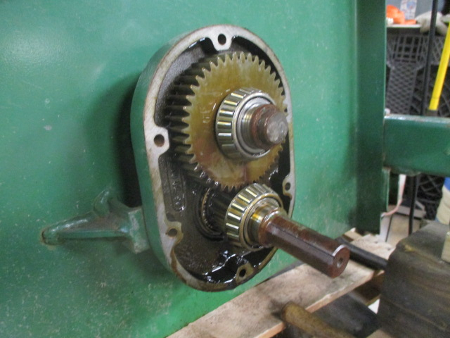

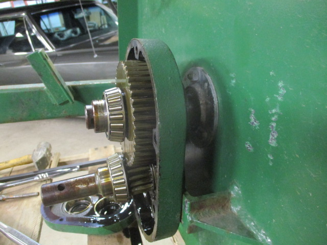

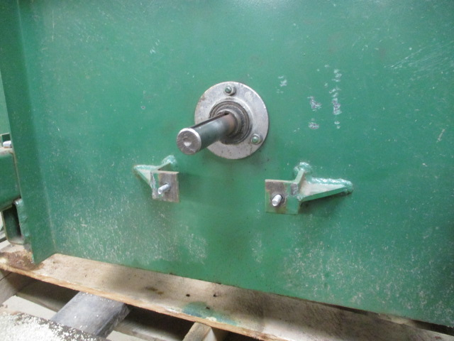

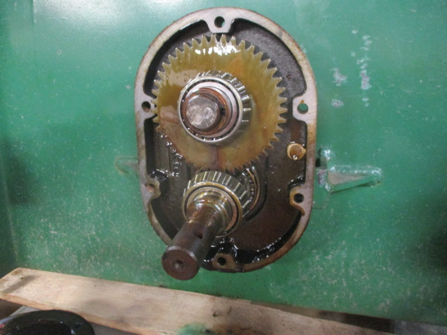

I purchased a Hanson 52" snowblower attachment with no or very low hours...
My Ransomes Jaguar PTO shaft rotates in a clockwise direction....that goes into the Hanson gear box and comes out counter clockwise....
I need the output to be clockwise so the blower fan and auger spin correctly...
Check my pictures...I opened up the gear box and I need suggestions on how I can get that clockwise direction...
Should I pull the gears and go with a couple of sprockets & chain?...can that be done?....will it hold up for residential use at just my home?....
Is there a different gear box I could purchase to get the job done?...
I wish it was a one to one ratio because I would just mount the PTO directly to the fan/auger shaft....
I'm open to any ideas...
Thanks, Mike

You need 3 gears or chain/belt drive to reverse it.
I would also examine the pto drive to see if it could be reversed easier.

Looking at the photo of the open gear box I believe you could simply couple to the upper shaft that the larger gear is mounted on.
That would be providing the speeds are matched OK.
As it is presently there is about a 40-50% speed reduction as well as a reversing function.
I'd presume that the blower is a modified standard 500 RPM blower modified for front coupling on a small CUT from a crankshaft drive.

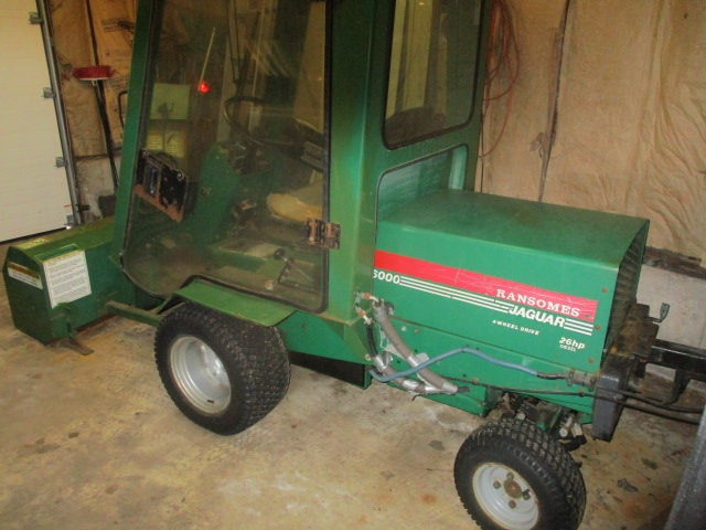

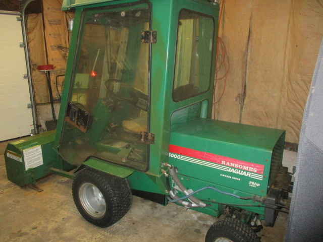

Here's my Ransomes....mine is a Jaguar 6000...
The hanson blower I have on the machine now is tired and the fan is way undersized for the shoot...Somebody at some point just stuck a fan on that they had on hand....
Would a couple of pulleys and a belt handle the snow load without slipping?
I haven't looked at how easy it would be to change the direction of the PTO from the transmission....
Mike
The unit seems to be an 'add on' affair.
The gears really reduce the speed of the input to the fan/auger.....that would be easiest to do is attach my PTO directly to the upper shaft.....wouldn't that spin way too fast?

I found the Ransomes PTO RPM at full speed....it's 3500 rpms....what does this rpm have to be knocked down to for the snow blower?.....I don't have and I can't find what the Hanson rpm speed should be....
Sprockets and chain will give me the proper direction and the sizes of those sprockets will give me the proper rpm at the fan...
Mike

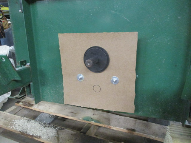

I'm the original poster here....I have a PTO on my Ransomes that spins clockwise and the original gear box reverses that to a counter clockwise rotation....
The newer snow blower I bought needs a clockwise rotation for the blower fan to scoop and throw the snow out of the chute.....
What's the worse that could happen?....I jumped in to try and come up with a way to get this blower to work.....
Sprockets and chain looks like the way to go.....

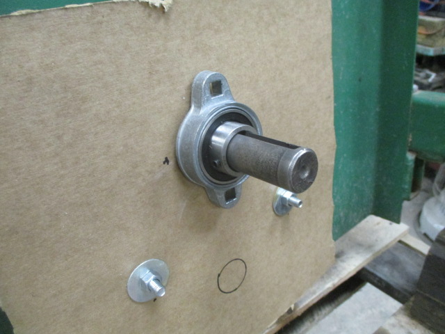

I started with a piece of cardboard as a temp-let that I'll be able to transfer to a piece of steel plate to hold the sprockets, gears and the chain....see pictures

More pictures of the work.....I transferred the cardboard templet to the steel plate....started to mount the bearings on the front and the back of the plate...4 total needed...they are flange mounted bearings.....
Mounted gears....1" bore....1/4" key....hooked up the chain.........Sprockets, bearings and a 10' length of chain were fairly cheap...with the sprockets I used, I think it might have been $100, maybe a little more

I was concerned about the speed of the fan & auger....I looked at the old blower when it was off the machine....
I hand spun the input shaft and for every time the fan went around once the input shaft spun (2 1/2) times....
I thought....I have to duplicate that speed with the sprockets and chain......I measured the old gears and tried to come up with the right size sprockets....
After some trial and error, I'm close to the speed I need....the new speed is just a little faster than the old blower.....
How long will my setup last?.....my machine just does one large paved driveway.....fingers crossed it won't grenade on me the first storm.....

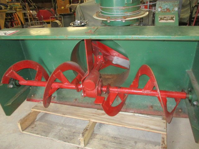

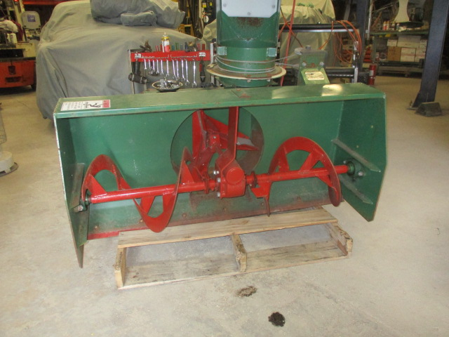

While I got you guys, I'm sure this has been covered before here in this forum.....the auger, are both sides matched in rotation?...
This new blower came in with the auger sides set at different rotation points (see pictures)....
On my old blower the auger was set at the same point on both sides (see pictures)...
Mike

Also while you guys are looking here, can somebody weigh in on the auger being lined up with each other or not.....or does it even matter.....
Thanks, Mike
Thanks, Mike
Most blowers require 180deg./ alternate. Had mine lined up on my Bercomac by mistake and it was noticeable.
