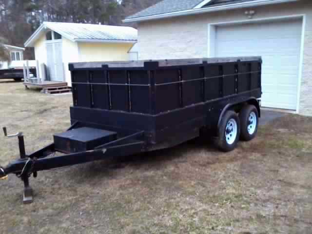

I have a older hydraulic power unit that I would sell. I have 50.00 in it. The control valve is attached to the pump, push of power up, pull for gravity down. You would just need a cylinder.
I can send a picture if you might be interested in it.
I've built two dump trailers, and several others.

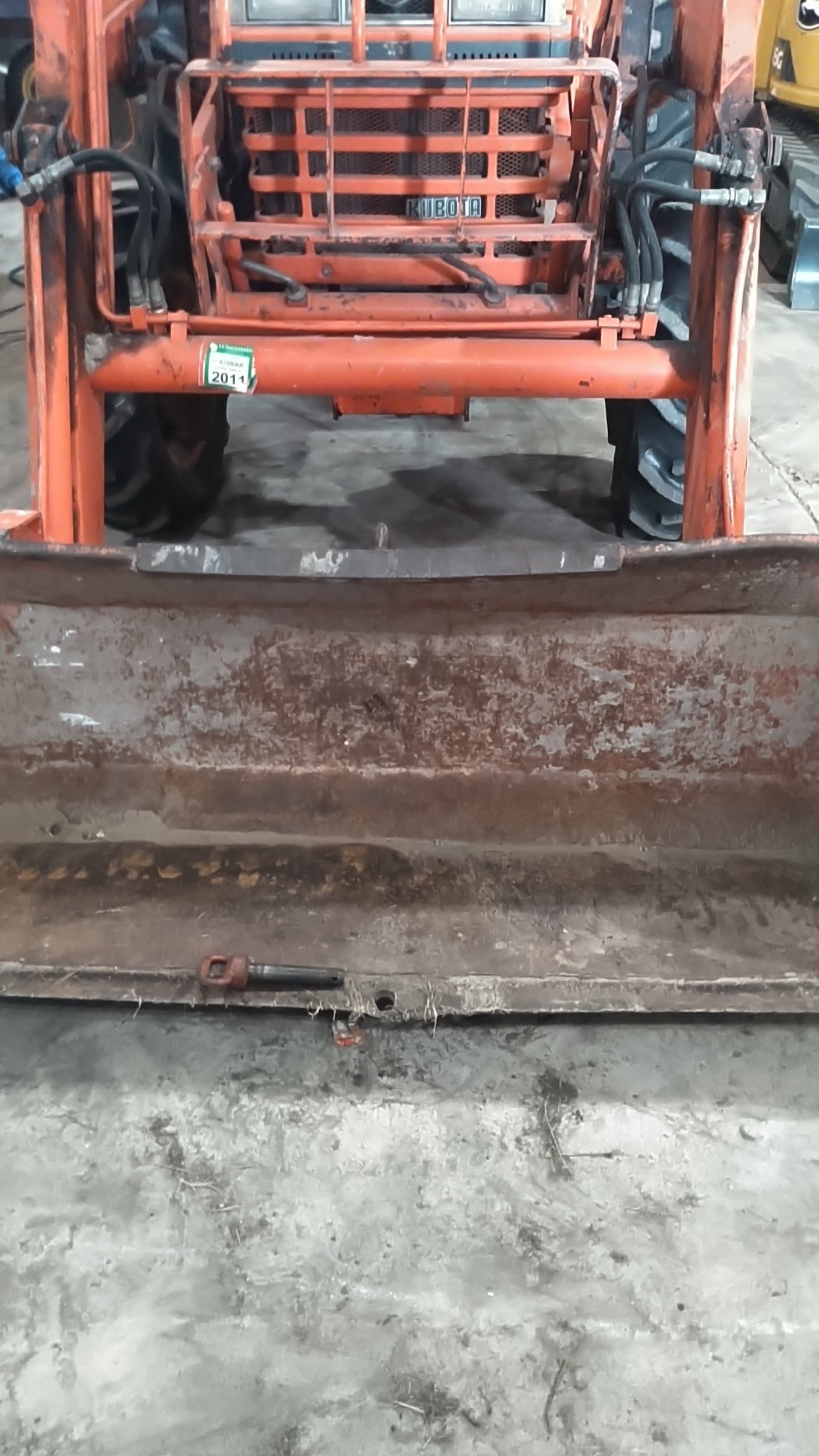

Brief update after searching half heartedly for a cheap used two way hydraulic cylinder that still works, and eventual time of building an actual legitimate dumping mechanism on a trailer that cost me $50 which cant be used on public roads anyway decided to continue to use this as a push trailer pinned to the loader bucket to dump it. Will be welding and drilling a hole on another piece of steel on top of old cutting edge on bucket for reinforcement where I pin it. One more thing, I would not use this method on hilly or uneven ground with out probably first constructing a rotating coupler on trailer. Thanks for the insight.

Building a swiveling coupler on the trailer tongue to help prevent twisting/ bending of bucket/ loader arms when operating on unlevel ground. More to follow when time and documentation using electronic contraption allows. Definitely can live with laying a $50 trailer on its side in a worse case operating error scenario.

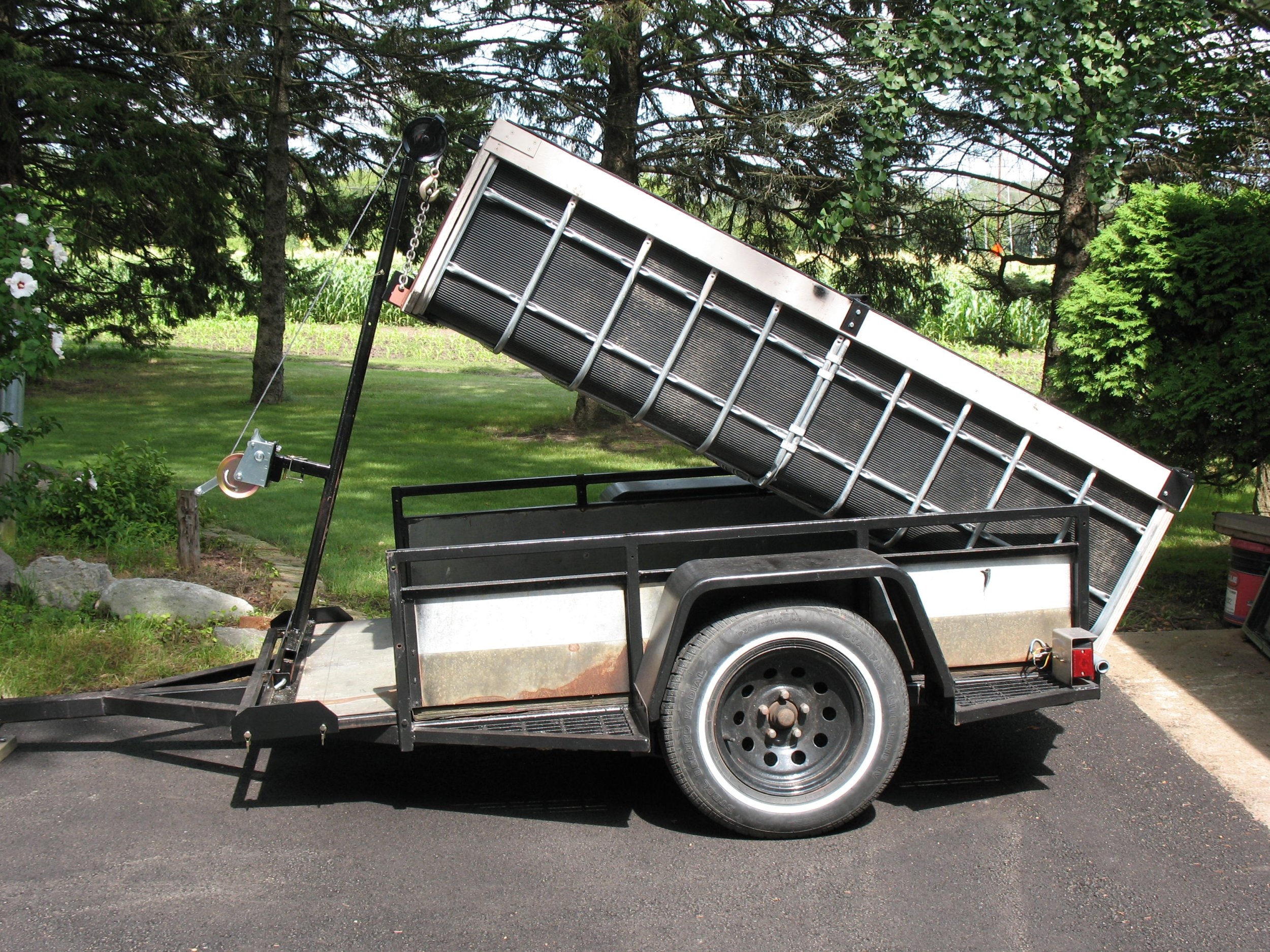

I have made inserts for two trailers I have for hauling brush and leaves. The pole can telescope and winch receiver will accept either manual or electric winches.
