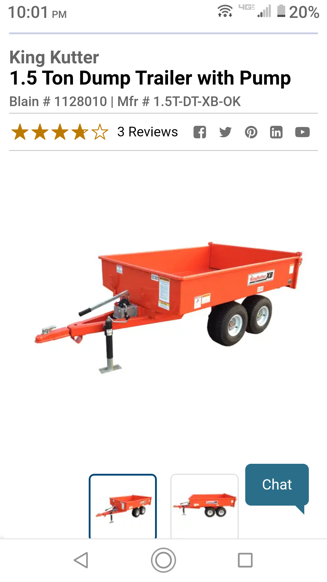

If I could find a used one of these at a reasonable price I'd leave the current trailer as yard art lol

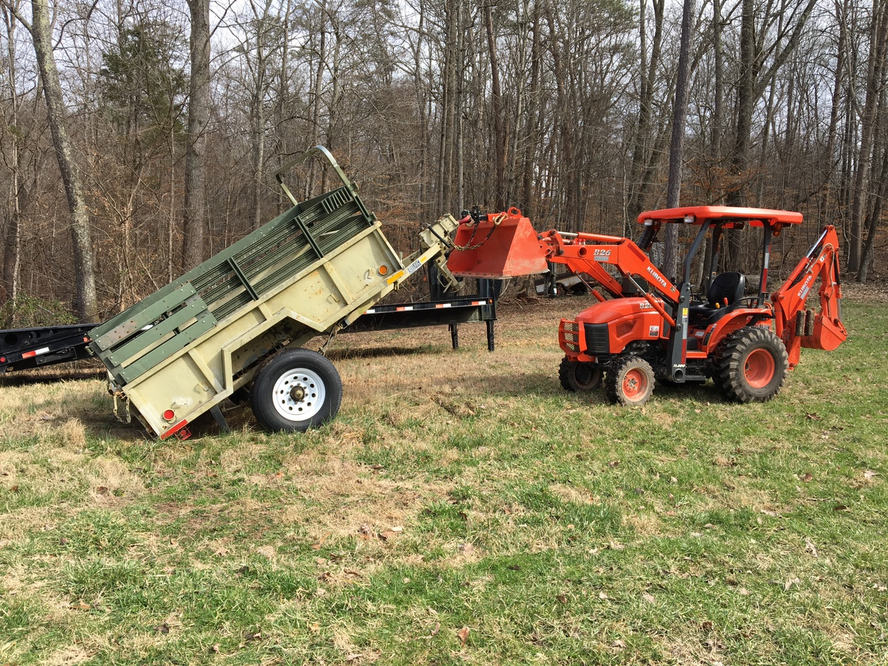

Pintle hitch and tractor loader makes a handy dumper for the farm. Ball hitches don’t have the articulation. Moves compost from pile to garden and blueberry patch. Easy to push or pull backward with mirrors.
Brings home loads of horse stable cleanings to add to the compost pile. Dump with FEL.
Both surge hydraulic and manual mechanical brakes adds safety to an off road trailer.
   / Need simpler ideas to make this is old trailer dump again. #29
A ball hitch will do it, you just have to dump bucket in sync with your boom lifting.
