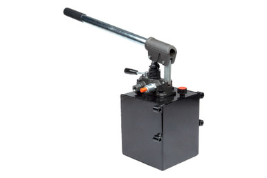

Off in another direction...... Manual hydraulic pump, and a ram....
If I went with a double acting hydraulic cylinder I'd plumb it into my splitter on the rear remote of my 4150. I've thought about that also.

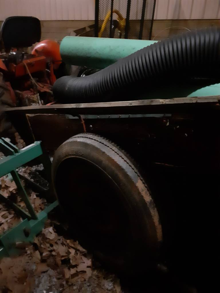

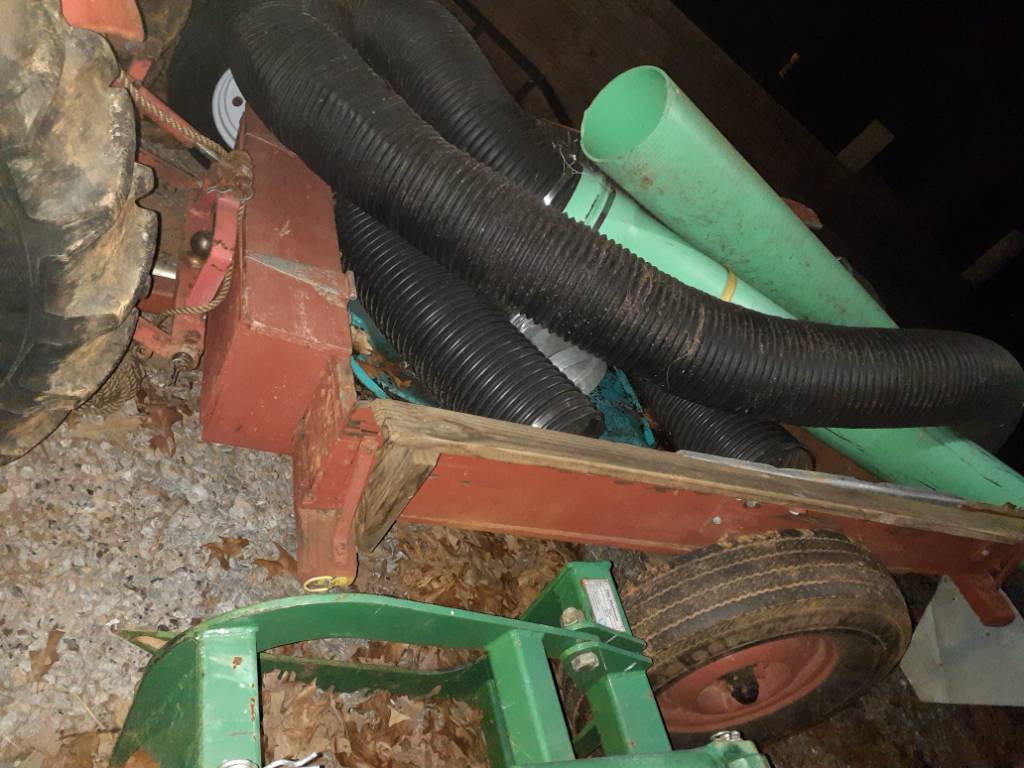

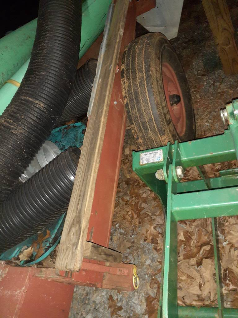

It looks similar to the trailer my grandfather made in the 40's, using a 30's Chevrolet straight axle. It's full of pipe & leaves, I took pictures now, but he made a steel bed for it over wood so gravel, mulch, etc. we could easily shovel out. It doesn't tilt but me, I wouldn't want or need that.

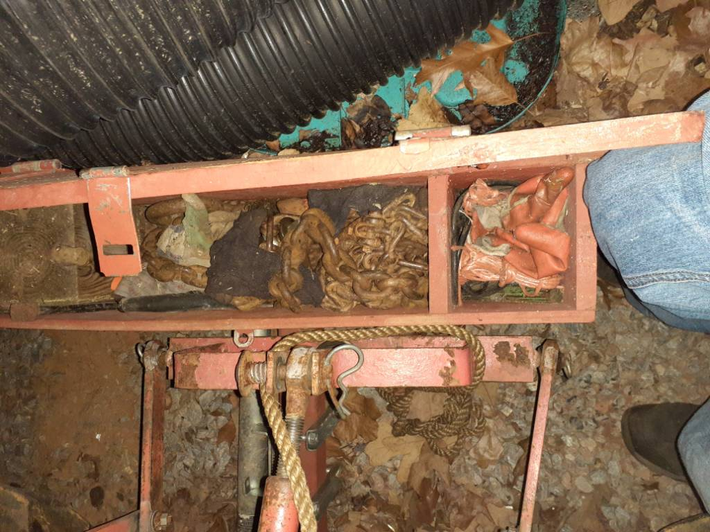

If it was my trailer, using what I had laying around, I'd weld or clamp (bolt) it so it couldn't tilt. The sideboards on my grandfather's trailer are great for rolling stuff like limbs off sides. That's where we sat riding on it. One thing I did make for it was a box up front (picture I'm holding lid up), great for chains, gloves, pins, etc. I clamped a wheel-jack onto tongue.
When all through I'd brush paint it.
It's a handy trailer.
