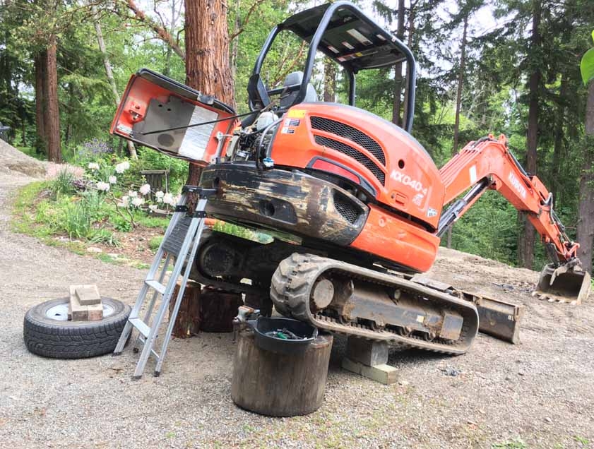

Tried that….
In this pic you can see that I tried a Jerry can. 🤣🤣 I was in the middle of this when the owner got the call that a master tech was willing to work on it - so he quickly collected his machine (while I was mid-test in the Jerry can stage). So I never got to follow that to the end.
This problem totally blew me away. The fuel system schematic was more complicated than that and I didn’t fully understand it.
By this time I was suspecting the Regen system or computer update, or who knows what?
Dealer#2 said it was due to an improper fuel filter ( by machine serial # ). I don’t know if that’s the “full story”.

Did the owner ever get to the bottom of this? We're having identical issues with a kx040
I talked to the owner, he is still having trouble with his 040 over the past year. He said he has been changing the fuel filter often, sometimes after only 2 weeks which seems to always 'work' for the short period. And he knows he's not putting dirty fuel in the machine, in fact being super careful because of this. And last time I took the tank out, to inspect for some junk inside. There was nothing in the tank, only a tiny bit of sediment.
This suggests to me that the machine has some borderline fuel supply problem that a clean free-flowing filter solves only for a short time. He's going to bring it back to me for a little while again soon. He needs this machine for his construction business, but I like to dig a little at my house from time to time, so we work it out.👍🏽 I will put a clear vinyl fuel line that I can see from the operator seat and dig with it.
I will check some other things too, verify lift pump output flow, and if the injection pump is pulling a vacuum on the lift pump.
If you have discovered anything please LMK.
