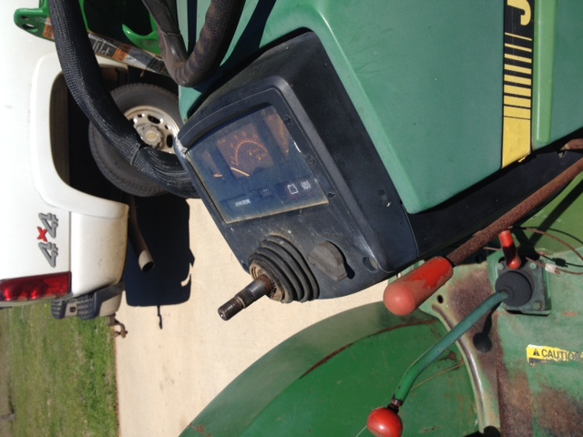

I have a JD 870 compact with bad gauges and need to replace the instrument cluster which requires removing the steering wheel. I have been unsuccessful now for two years trying to remove this steering wheel. Tried penetrating oil, various pullers, hammer ETC and no luck so far. I'm about to the point of just cutting it off but don't want to head down that road unless I have a replacement steering wheel in hand which is not available.
Not sure if this can be removed as a complete unit with the instrument panel and disassembled down to the steering shaft than maybe pressed out. I don't have a good manual that shown a good breakdown of this which leads me to my next question. Who sells the best shop manual for this tractor? I would prefer JD manuals if available.

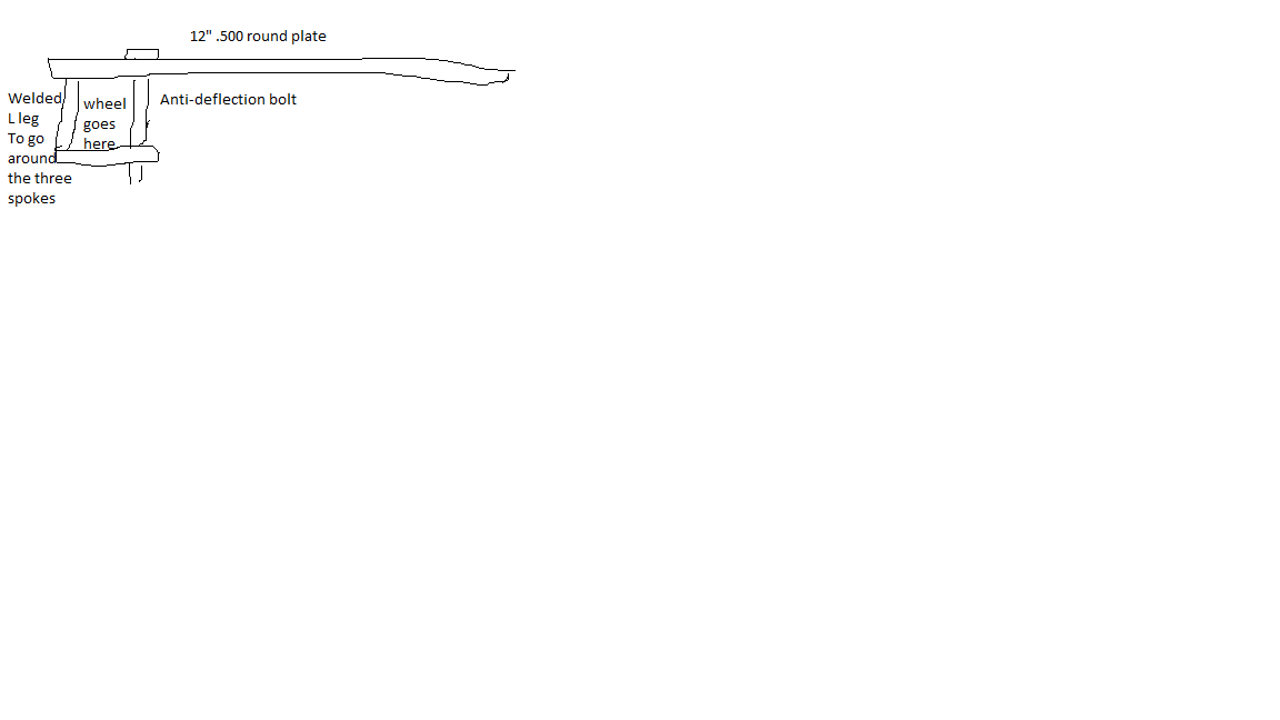

What about making a custom puller? The wheel has three spokes. Get a piece of 1/2" plate cut in a 12" circle. Drill and tap a fine threaded 1/2" to 3/4" hole or weld a nut to the backside so you can use bolt to press agains the steering input shaft. Weld three L shapped legs to grab the three spokes. Use a bolts on the open side so the 3 legs do not bend.
_____
asci art is not treating me well. The hashed line is that 12" disk of 1/2" plate. The left leg and the bottom solid line making an L are welded to the plate. The right line is the bolt that goes through the top plate and the bottom spoke leg to reduce deflection. Anyhow you are trying to make a big puller kind of like a harminic balancer puller but has something to grab the three spokes. The big fine threaded bolt in the middle is to apply torque against the steering shaft. I could swear I have popped my steering wheel off my 870 once without great drama. I loosened the nut a bit. Apply torque pushing the wheel up into the air with my knees. A few taps on the nut still on the shaft and it pops loose. Important to keep the nut on so you don't mangle the threads and to knock pop yourself in the face with a wheel that poppped off.
The official JD manual is good.
/ Need help with JD 870 steering wheel #8

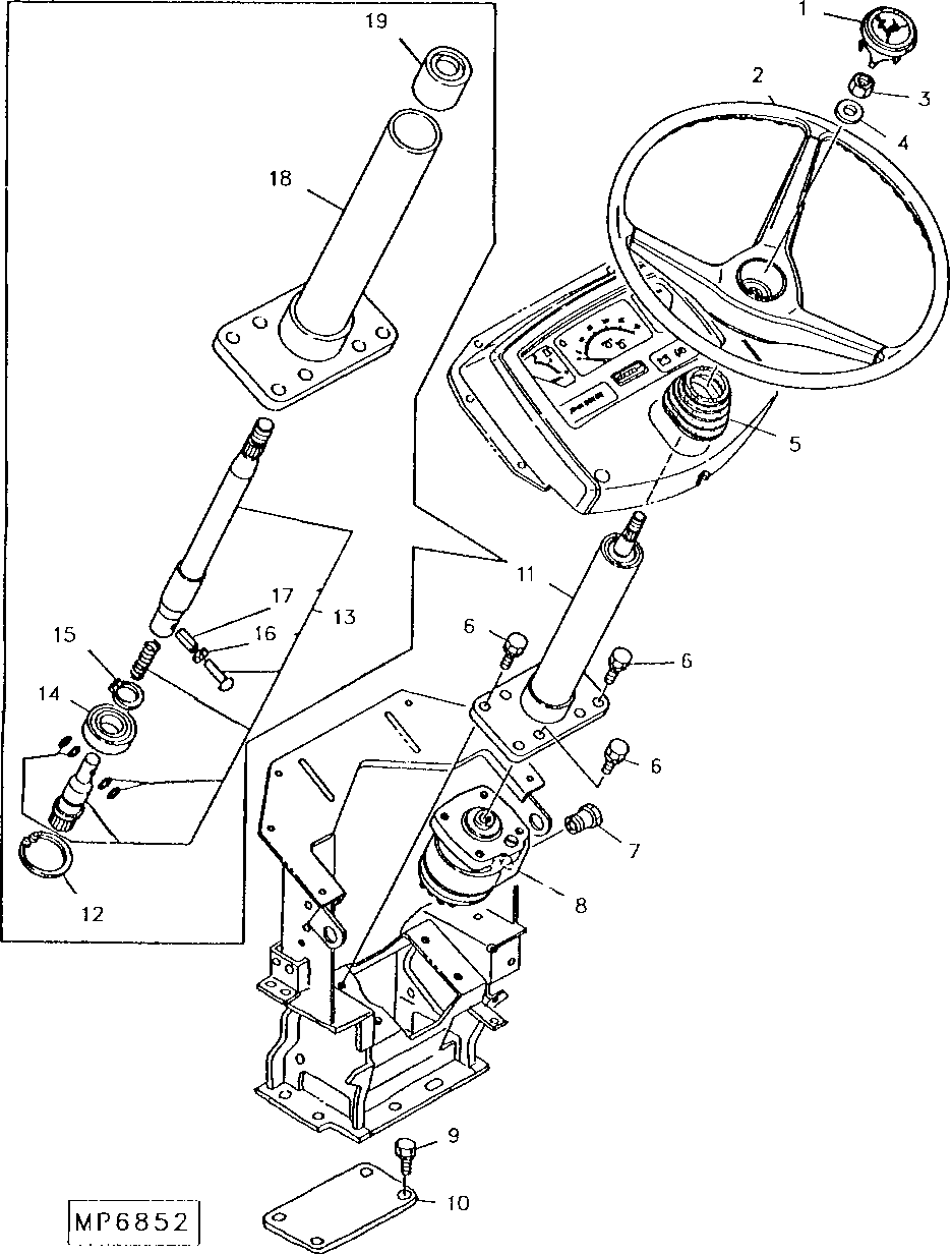

MP6852_________UN01JAN94.gifJim
Looks like I will have to make a puller to get this steering wheel off, looking at the attached breakdown of the steering column looks like Item # 18 steering column will not separate from the Item # 13 steering shaft unless the steering wheel is removed.
I'm not going to let this kick my Azz.
Dennis

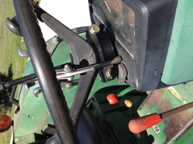

Our brains are clicking, that was the plan I came up with a couple days ago. Going to try this tomorrow, will post up a picture.
Dennis
#12
Steering wheel is off and instrument panel replace. The temp gauge is not working so I will troubleshoot that next.
