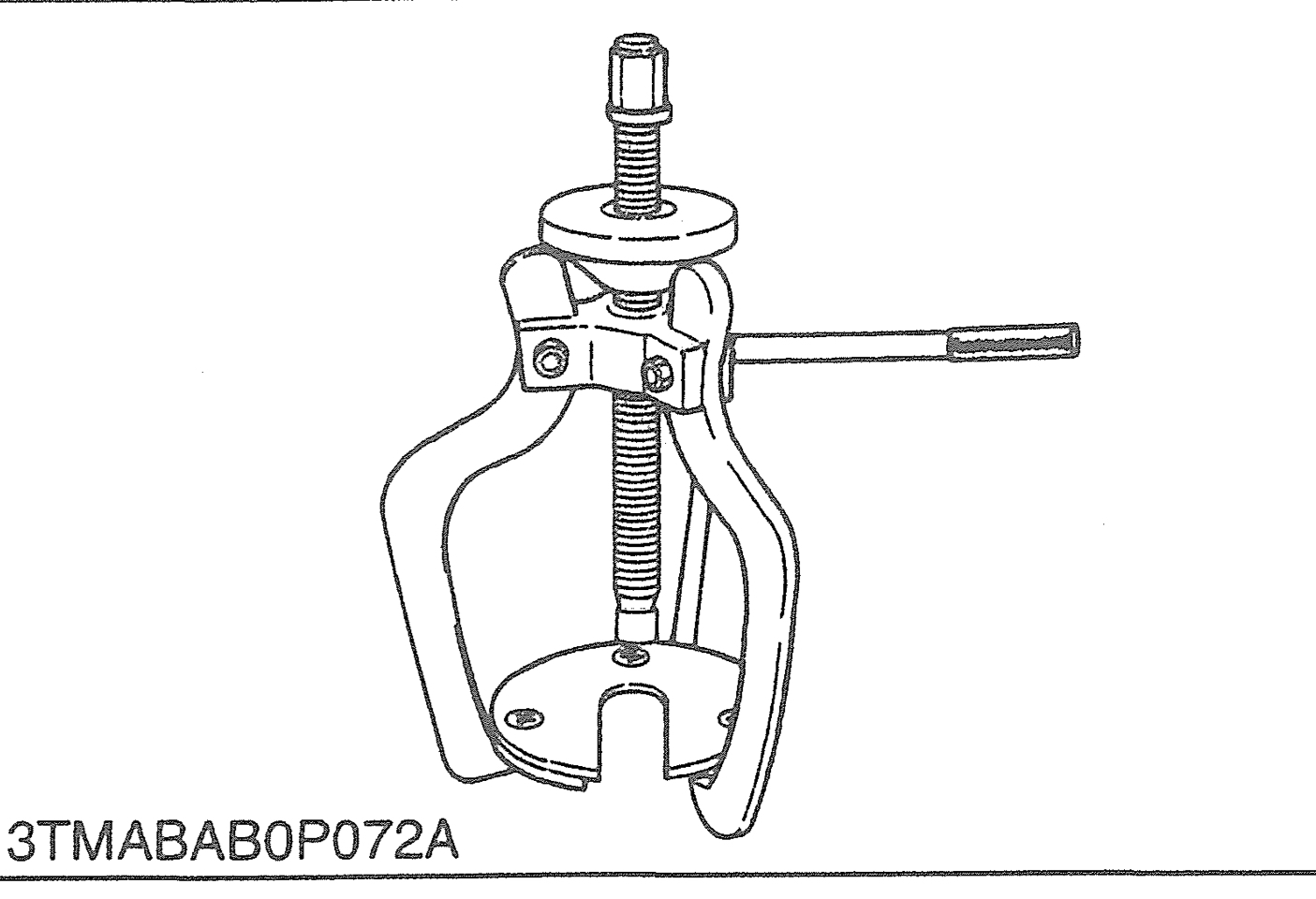

Unsure if this will help. My Kubota has a special tool for removing the steering wheel. Attached is a picture.
It looks like a gear puller with a circular metal plate attached to the three legs of the puller. Likely because the steering wheel is mostly plastic and deforms too much using just the three legs of the puller.
Maybe you you could modify your puller to make something similar.

/ Steering wheel removal #11
That's basically what my bearing puller attempt created, a near continuous support for the bottom of the 'wheel.
Had it turned upside down to get a flat contact surface, then used a stout Snap-On puller.
Guess I could cut out a plate from thick material, mimicking that design, and try it. Then again, at this point I have no idea where the nut ended up so it may be best to leave well enough alone. Besides, I used the steering wheel I was going to swap in on another vehicle.

/ Steering wheel removal #17
That top one looks like what I attempted last, before giving up. A bearing puller and a stout puller.

/ Steering wheel removal #18
Try something like this. The wide angle iron under the wheel hub will give more surface area to pull without breaking away the plastic. One of the guys on another site was trying to remove the steering wheel on his Kubota X1100C and had tried every other type of puller for weeks on end. They all failed to remove it. He finally devised this and between several liberal applications of Kroil penetrant and these puller pads made out of angle iron with 5/16 threads tapped into the angle iron. He had to apply quite a bit of force, but the wheel finally popped off with no damage. Before he put the wheel back on, he applied Never Cease to the spline shaft to make removal much easier next time.
