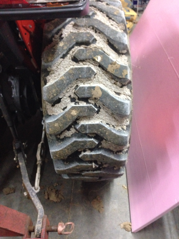

I had to make a choice between R1's or R4's. I wanted the R4's because of the woods I work the tractor in, but needed the R1's for the steep hills the woods are on. I chose the R1's for the traction.

Plan on some disking, a few acres. More working in the woods.
Well if that's all, I bet you'd be fine with R4s. Earlier I thought you said that after the cleanup the tractor would be used primarily for field work, but if that's only a few acres of discing per year, you'll be able to do that with industrial tires.
You may be able to pull a bigger disc with R1s than R4s, but if you're okay with taking a little longer to do the job with a smaller disc, then that's not a problem.

We have R-1s or R-1Ws on all of our tractors that are 100% farm field use and R-4s on the CUT that does the tough terrain work - trails through the woods, lots of loader work where the front tires would be overloaded if we had R-1s that are offered. The factory R-4s were tough but fronts lasted only 700 hours before we started having problems with them - replaced the 4 ply originals with 10 ply tough sidewall skid steer rugged use. Like said many times, they don't have the traction of our R-1s (all radials). With a big bale front and rear on the CUT the tires done even bulge while the tires on our other 2 much larger loader tractors have a nice squat to them under a 2 bale load. You're going yo have to compromise someplace - where is your most important work? And if loader work is important to you, you need to pay attention to tire load rating. Our largest tractor loader equipped will have tires well overloaded with a bucket full of manure. Same thing with our full size utility we use for feeding - we've knocked a tire off a rim due to overload. Our CUTs R-4 fronts have about twice the load rating that it is possible for the tractor to load the fronts.
