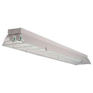

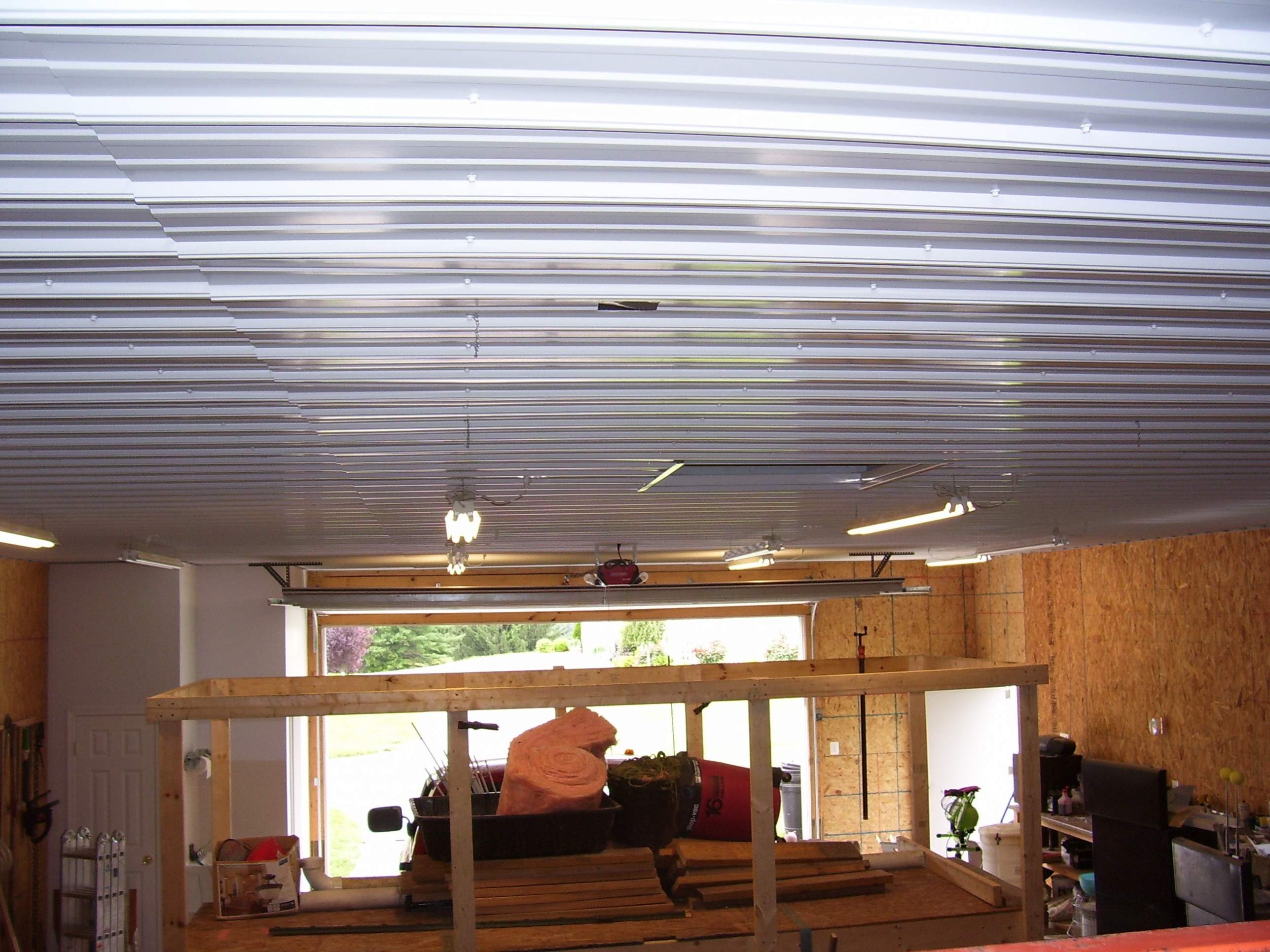

By them once, stay away from the Home Cheapot/Lowes crap. Go to a EL supplier and get the T5 54 watt HO tandem fixtures. These are the new style that has the very thin (about 3/4") bulbs. Here is a picture of the ones I put in my pole barn, more pictures are in the link below in my signature.

That is what I have in my shop. An industrial electrcian friend told me to go to an industrial supply house to buy the good stuff and to stay away from HD/Lowes for shop lights.
/ Need Help lighting for new garage #24
Yup, They are awesome! So bright you can hardly look at them directly. And they are quiet because of the electronic ballast's.
Kenny, T5 lamp is 1/2 inch.. all lamps are sized in 1/8" increments,, It's good to see you used the T5 fixture It was a good choice.. they do tend to run a bit hot but other than that they put out great light in a small package,,

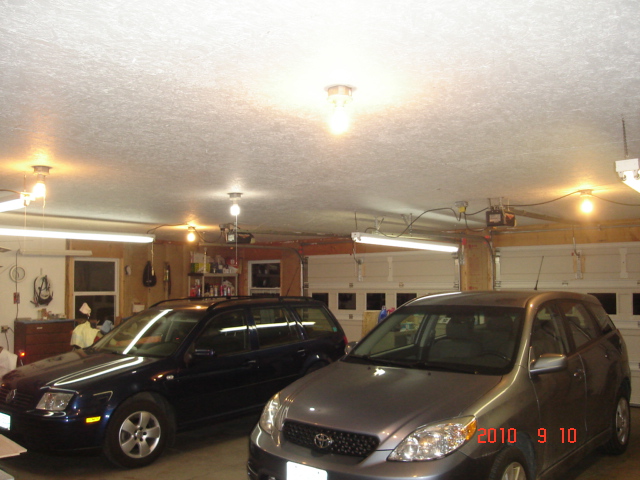

I used a combination in my garage: four 26W CF bulbs on two switches, followed by what I could find inexpensively: three 8-foot doubles, and one 8-foot single. All are on their own pull-chain switches. Later, I added two more 26-watt CFs in sockets, also with pull switches. That way, even if I turn on both switches when I enter the garage, I have reasonable light and only a bit over 100 watts. I can then pull chains to get more light where/when I need it.

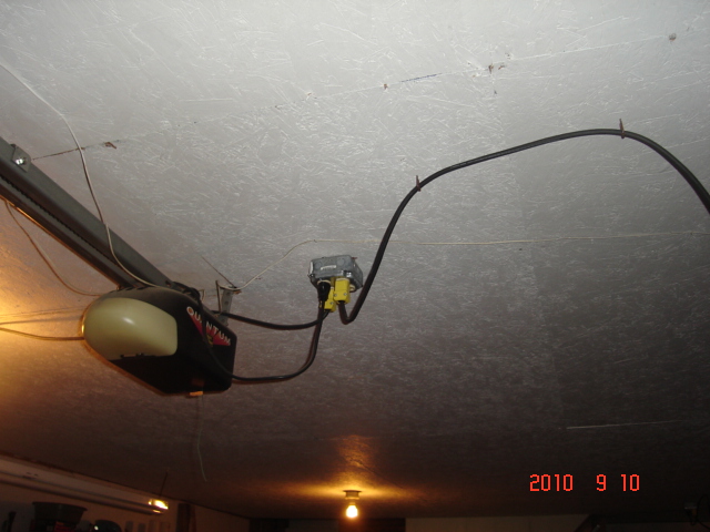

I also used the outlet-on-the-ceiling route, but used "4-holers." That way, I can easily move light fixtures around later, as the garage evolves....:laughing:
One of the biggest favors you can do for yourself is to get some white paint on the walls & ceiling; makes a HUGE difference in how the light gets spread around. I used el-cheapo $7 Home Depot 7/16" wafer board and slapped a coulpla heavy coats of white primer on them. My garage is 32 x 32, but (unfortunately!:() I went with an 8 foot ceiling. (Wish I had more height now!)

P.S. While you are at it, you might want to consider wiring in a few electrical outlets in the ceiling. A friend has done that instead of wall receptacles and uses the self retracting extension cord doo-hickeys. It is much nicer than having cords running across the floor and there is never a problem getting to an outlet, plus they're self storing once you are finished with them. It would take very little extra to wire them in now while you are wiring in your lights. Just a thought....:)
