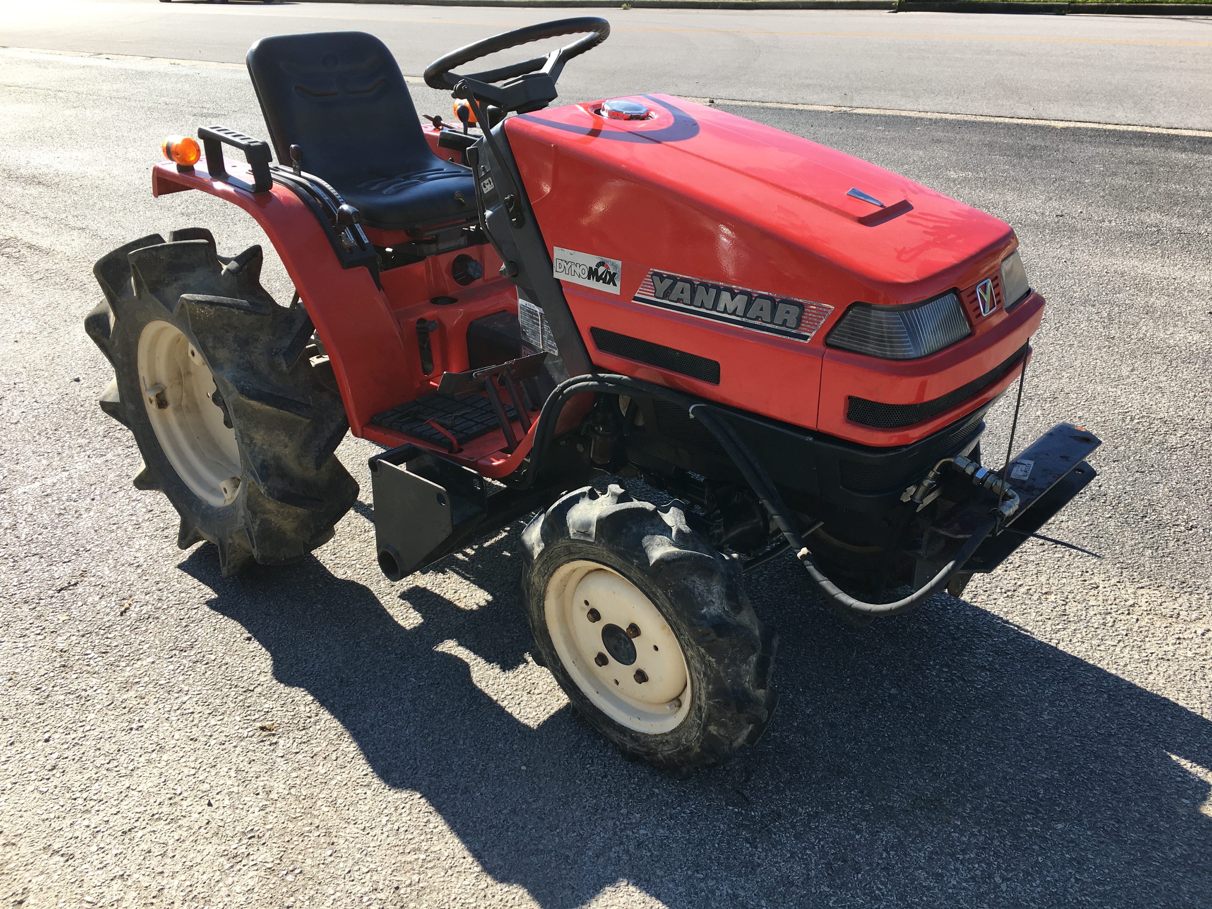

Hello All,
I am looking for some help with the model of this tractor. I have looked everywhere trying to find it and still no luck. Something about being down by the left foot??
I just had the injection pump rebuilt and new nozzles on the injectors. Now I am needing to order a new pinion and ring gear for the front differential.
TIA

The KE3 used the 3TNA68-UNK engine so I bet that is what you have. I bought one of those used axles not long ago so I should have those gears. Click the 'contact us' link below if you are interested. I will warn you that the axle was not cheap so those gears are not going to be either.

Google found this Japanese exporter showing KE3 year made 1990.
I doubt that model was ever imported here by Yanmar-USA so it's gray-market, unsupported by them.

so, the bearing came apart ,and caused this ? That sure is a badly chewed up pinion

I dont think. Bearing still spins freely. Abuse is what caused this. It has a front loader on it and dad was using it to pull out rocks and tore it up. If you need something broke he's the man for the job.

Ouch! I think the side force of the ring and pinion skipping probably damaged the bearing rather than the other way around. We have them In Australia (saw one advertised) What were you doing when it ate the CW&P?
