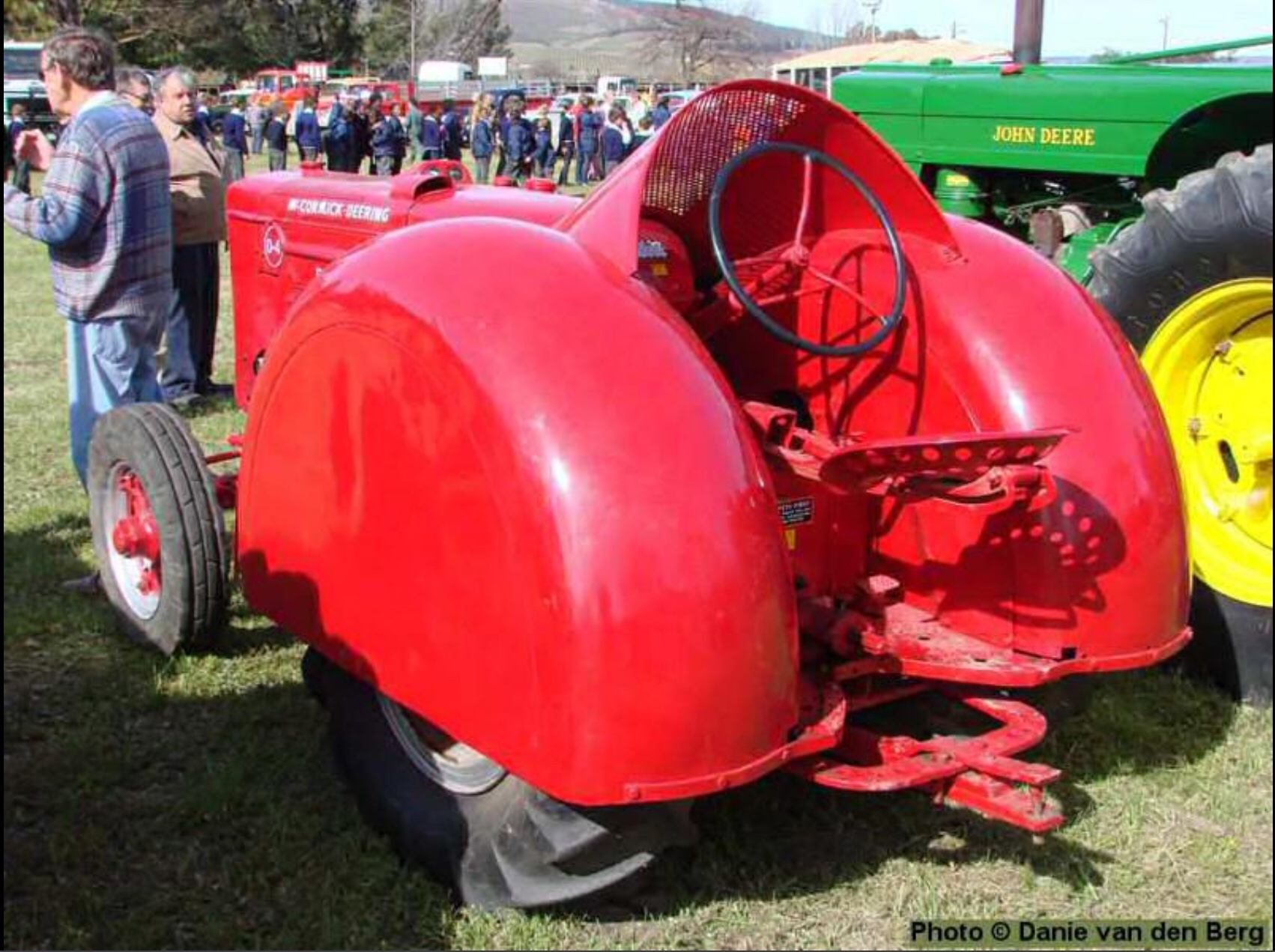

If lengthening the drawbar can’t be done or help, here’s another suggestion from the peanut gallery:
…but maybe extend the fenders a bit lower? 🤪
