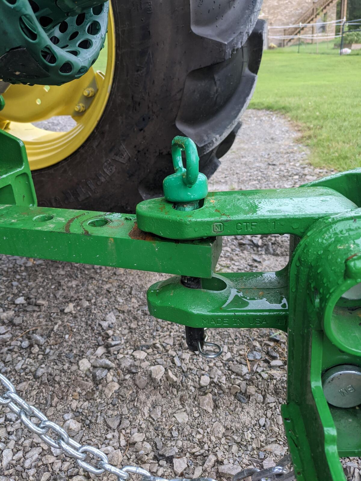

If you use a framing square how far back is your drawbar hole in relation to the end of your PTO shaft.
It is hard to say in your picture but it looks to me like your drawbar could be in the shorten position.
If you get under your tractor and look up at the drawbar it should be pined to the tractor in the front of the drawbar,
most drawbars have two holes to attach to the tractor if it will move back 6-8 inches that may take care of the issue.

Lou - I'll try to check out the drawbar position tomorrow..

It’s supposed to be 14” from end of the PTO shaft to center of hitch pin for 540 PTOs and I think its 16” for 1000 RPM PTOs.
How is the drawbar attached to the tractor? On my JD 3020 the drawbar had several holes in the attachment end. You could lift the hold in pin and pull it out another foot. The long part goes under the tractor.

I'm new at all of this. I've got less than 60 hours in my tractor with a Batwing mower. I've noticed that my rear tires on the tractor are sometimes contacting the Batwing. The manual specifies no more than 80 degrees. I'm sure this is happening when I'm going around trees and such. I bought the exterior mirrors for the tractor, and they do save my neck from having to look behind me all the time, but I really can't see whether I'm turning too tight or not. So, then I end up taking too wide of a turn and then loosing the efficiency of cutting.
So, what are your recommendations for how I can see to avoid turning to sharp?
1. Make sure your drawbar is extended properly. There should be four possible drawbar lengths on a 4 cylinder 5E unless they've just changed the drawbar on the newest units, as there are four on the Tier 3 4 cylinder 5E I've run. They are "all the way in," "two inches from all the way in," 14" (used for 540 RPM PTO applications), and 16" (used for 1000 rpm PTO applications.) Your picture looks like yours is probably set at the 14" or 16" location as the clevis would be right at the back of the tractor, and in the picture, it's not. But if it was set too far in, too short of a drawbar can lead to catching the tongue with a tire.
2. Know that you are at risk of catching the tire when you turn and make a habit of glancing down and behind you to make sure you don't catch the tongue whenever you turn. If you can't see this in the mirror then don't use the mirror, look directly at the tongue. Unless Deere has changed this in the newest 4 cylinder 5Es, visibility out the back isn't too bad and at least I can see the tongue decently enough from inside of the cab of one. This is a good habit to get into as catching something fairly light that you are pulling from the drawbar can result in the inside tire catching and throwing whatever you were pulling right up on top of you. When I was learning to drive a tractor, my Dad told me bunches of stories about people where he grew up getting killed by catching something (usually a drag or a disc) with a rear tire when turning. The inside tire caught and lifted the implement right off of the ground and it would fall on the tractor operator.
3. Somebody mentioned reducing your turning radius. You can do this by screwing the steering stop bolts on the rear of each steering knuckle out enough that the front wheels cannot turn at enough of an angle, making it impossible to turn too tight. However, 2) is really the solution here.
