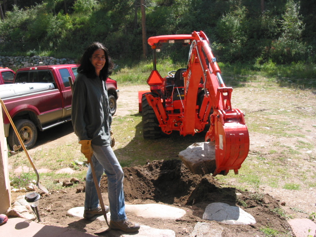

I have a thumb on the backhoe and that makes it useful for lots of things. A thumb makes it a whole different tool. It carries trees and big rocks and can place either one of them easily and accurately. With the thumb I can also pick up piles of debis and put them somewhere else. The backhoe is very handy as a crane for picking up heavy implements or tools and putting them down somewhere else very gently and accurately. Of course it is good for digging holes and trenches, but I really don't use it as much for that . Most use is as a landscaping tool or handy stong crane for lifting and placing.
