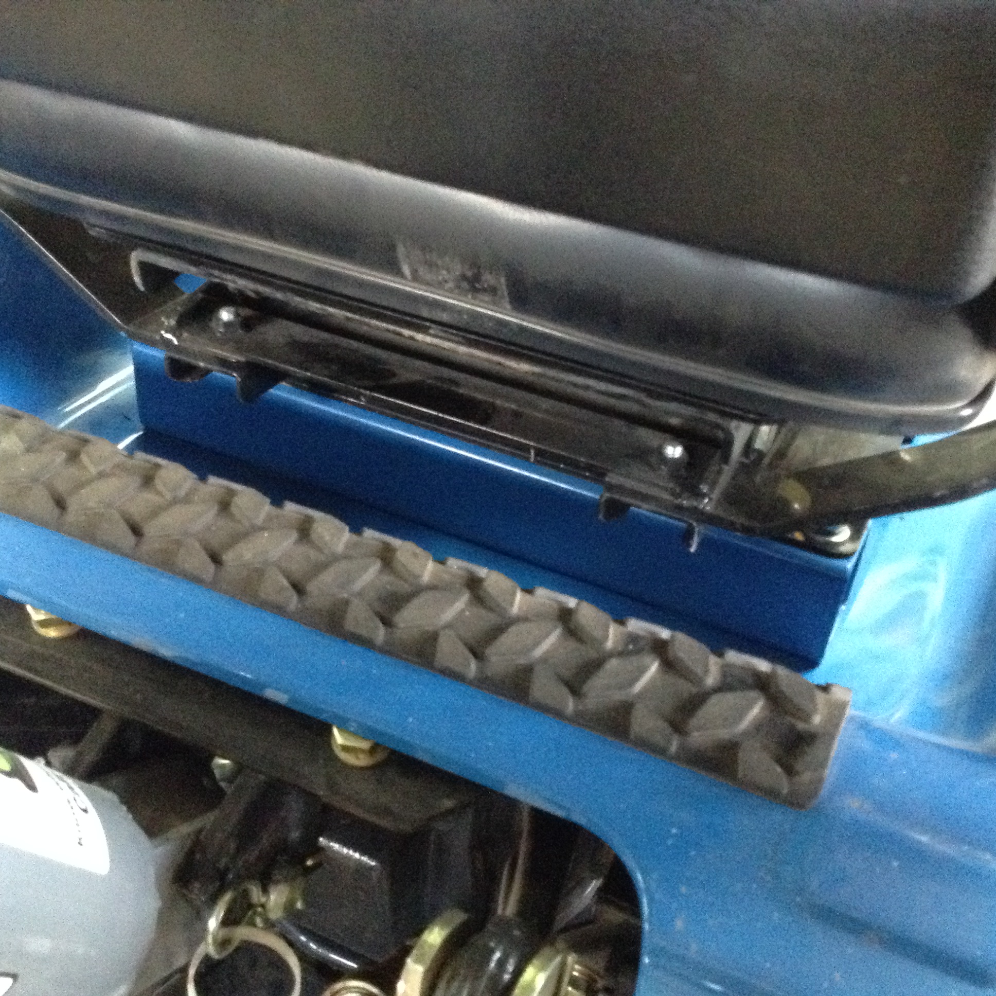

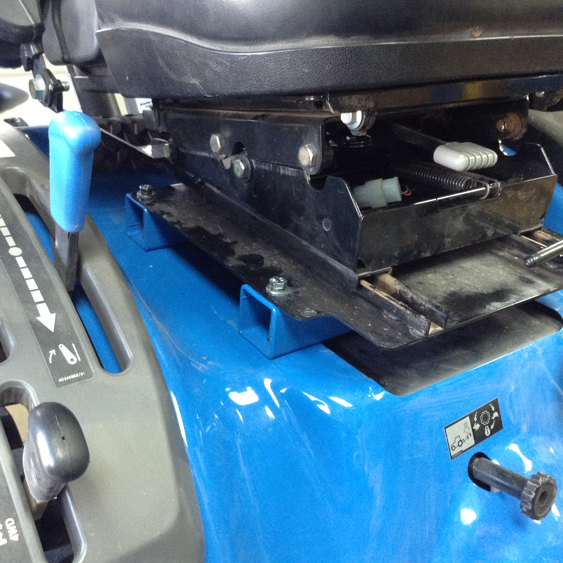

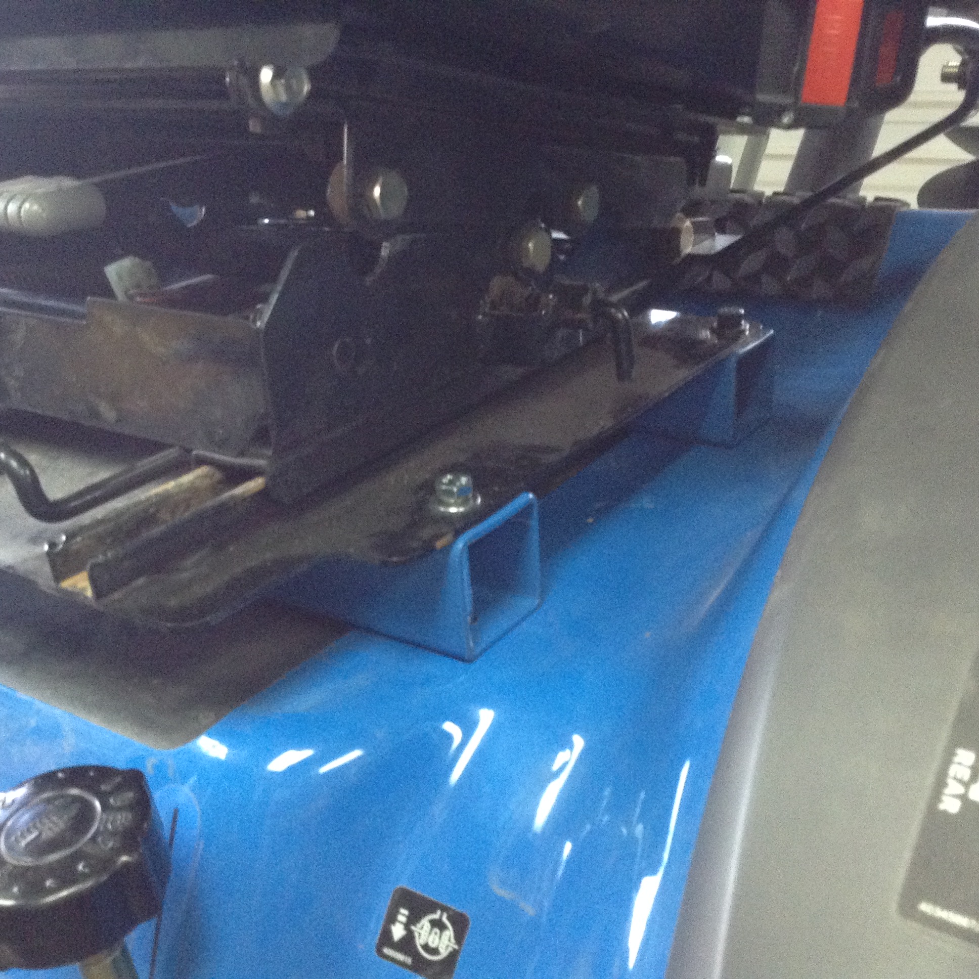

Yes, just to reinforce the "get out and sit on it" aspect, as Jeff stated, they can be tight feeling. I am also 6', 220#, size 12 shoe. My legs felt just a little cramped. I put right around 100 hrs on before I started to 'customize'. I came across someone else here that had a Massey SCUT, and put some seat risers on.
So, for less than $25, I got some 1 3/4" steel square stock, 4 - 2 1/2" bolts, and a can of spray paint. Took me less than 30 minutes to install the seat riser 'blocks'. Take out 4 bolts, Re-install, that easy....Oh my! What a difference! Totally new feel to the tractor...fits me perfectly.
There are many little things that could be uncomfortable for you, but be better for someone else. Placement of loader controls, key switch position (in regards to hitting your knees) etc... Pedals are a BIG DEAL.... I personally HATE the treadle type pedal...hard for me to use and be comfortable. I MUST have the side by side pedal arrangement. This is a big deal to me....I would NEVER buy a tractor with a treadle pedal. Now there are people that SWEAR BY this type of pedal. That's OK, works for them!
The whole point of this is find the one that meets YOUR needs, fits YOU personally, and meets YOUR budget. If money was no issue we would all have the biggest , baddest, best new tractor out there.
Here is a pic of the 'seat riser' mod that I did:
