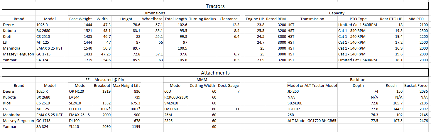

Okay guys I've done some more digging and I think I've narrowed the field down a fair amount. Going with people's advice to get the bigger engine given the frame size I've landed on the 23-25HP SCUTs Here's the players:
After expanding my search I've found that there's a dealer 30 mins from me who caries LS and Kioti. A Mahindra dealer 35 mins away. Actually got two Massey Dealers, one at 30 minutes and one 25 minutes the other direction. The only Yanmar Dealer within driving distance looks a little rinky dinky, almost like he just happened to had a couple used Yanmar trade-ins so I'm leaning away from Yanmar.
Was a bit disappointed to learn that several SCUTs are not compatible with backhoes unless you buy their "special" backhoe model (I'm looking at you BX23S and Massey GC1710 and GC1720) and the BX2680 doesn't even have a backhoe option.
To be honest I'd like a backhoe but I can without for now, but I would like the option in the future.
That really leaves:
John Deere 1025R like rngrrymd suggested
Kioti CS2510
LS MT125 which looks like one of Diggin It's rigs
Mahindra EMAX S25
Anyone have any obvious standouts or negatives about that bunch?
That really leaves:
Kioti CS2510
Mahindra EMAX S25
I would zero in on the BX23S. You will not be disappointed. If you can even get it w/o the BH you will find it very expensive to do later. That will be the case on any of the SCUTS/CUTS. Always a lot cheaper to buy together and the used market for the BHs does not exist, they always stay with their parent machine. On a new property you will find many thins to do with the BH; probably almost as soon as you start working it. Rentals are not cheap and compress your work into time lines. Charge by the hour whether you use it or not. When you have your own BH you control the time lines not the rental cost.

Look carefully at the specifications regarding lifting and hauling. Make sure you understand how they're determined and why some brands may seem different than others.
Look even more carefully at the pricing/quotes and note what is or isn't included. Don't forget to factor in financing costs if you go that route.

I've done more digging and narrowed the field down a fair amount.
Was a bit disappointed to learn that several SCUTs are not compatible with backhoes unless you buy their "special" backhoe model (I'm looking at you BX23S and Massey GC1710 and GC1720). The BX2680 doesn't have a backhoe option.
Kubota does not enjoy half the USA compact tractor market because their engineers and marketeers are idiots. Watch VIDEO #1 below.
The BX23S has an INTEGRATED backhoe. You cannot buy a new BX23S without a Backhoe.
With increased understanding you will rule out any subcompact T-L-B that is NOT a "special"/integrated backhoe model.
Buy once; cry once.
