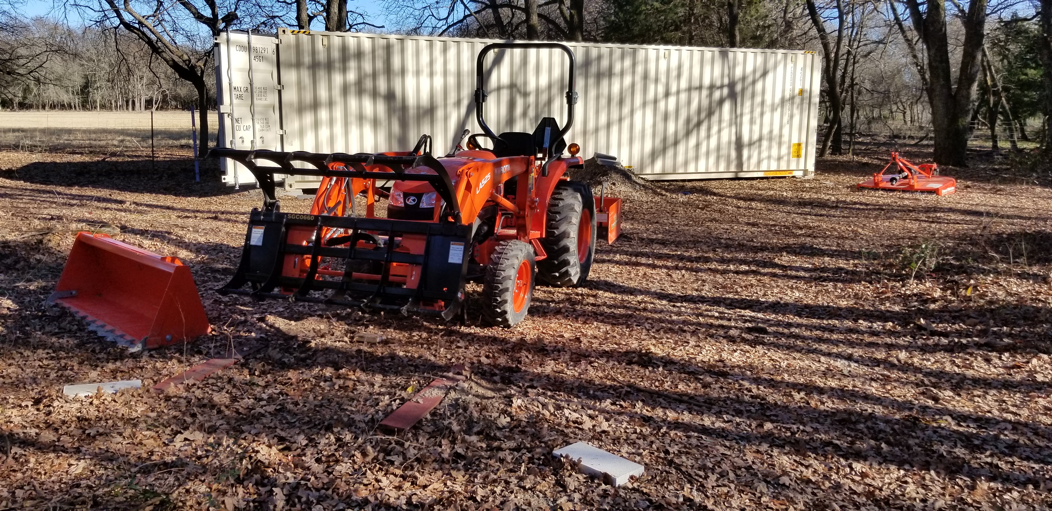

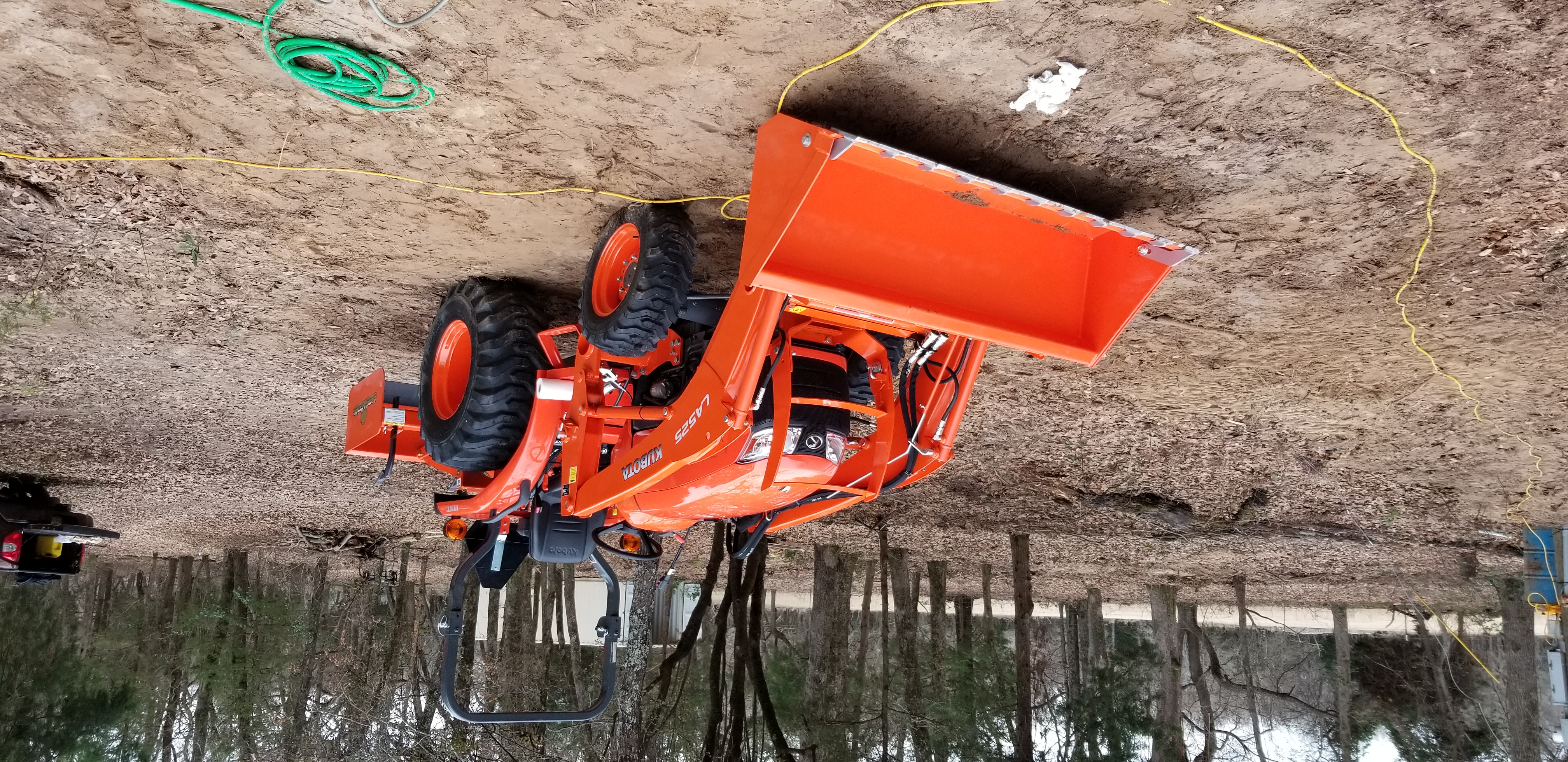

This touches pretty well on my own thoughts. I just spend my third weekend with my new L2501. Thoroughly enjoying it. There's a lot of choice out there. I wrote up a review on why I went with the L2501 here:
https://www.tractorbynet.com/forums...risons/405243-pulled-trigger-l2501-today.html Package.jpg20181216_160320.jpg
