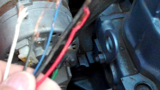

I just found that the wires that connect to the rear of the alternator via the four connector plug have been ripped or chewed out of the connector. I have a manual but the wire colors/numbers do not match with the schematic. The plug has places for four separate connections but it appears as only two were used and I have about eight wires hanging loose with no idea what was where. It's a '90 model, can someone post or email a couple of good photos of the connector and wire loom for me.

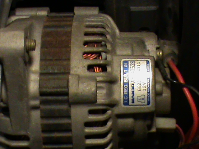

I dont know if this will help you cause my tractor is an 2002.
/ Need electrical HELP LK3054 Alternator
Dirtnut,
Thanks much, the pictures are perfect but it is a different alternator and does not correlate well to mine.

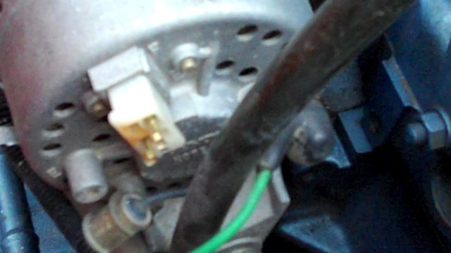

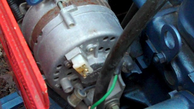

OK folks I finally got some (blurry) photos of the alternator and wires. The serial number is:
826500612. There is a white plug which is visible in the photos, it had two connectors in it, one in the upper right spot and the other in the lower left. The wire colors are; 1 black, 1 blue, 1 red, 1 white, and 1 black with a yellow stripe.

Not much info there. Pic shows 2 wires and Phil has 5?, and unless your an electrical engineer, the schematic is of little use
/ Need electrical HELP LK3054 Alternator #13
OK, checked the pictures. That is an older style alternator. Give us a couple hours, we'll see if we can match it up to the plug.

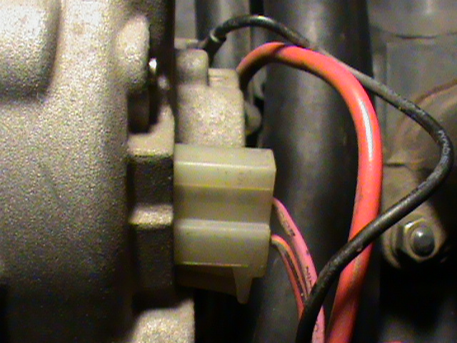

I've got a '98 LK3054. After reading your post I went and took a pic of my alternator. Yours look pretty much the same as mine. See the attached pic. It's not a real good pic, but if interested, I can point out colors and take better pictures.

Hillbilly,
It looks like your alternator only has two wires going to the connector, are there some unseen wires? Mine seems to have had five.

/ Need electrical HELP LK3054 Alternator #20
Looking at HB61's pic; seems there are at least two wires in the white plastic connector,and two more wires going to the battery post on the alternator. That leaves just one unaccounted for, and it very well may be hidden in the pic
