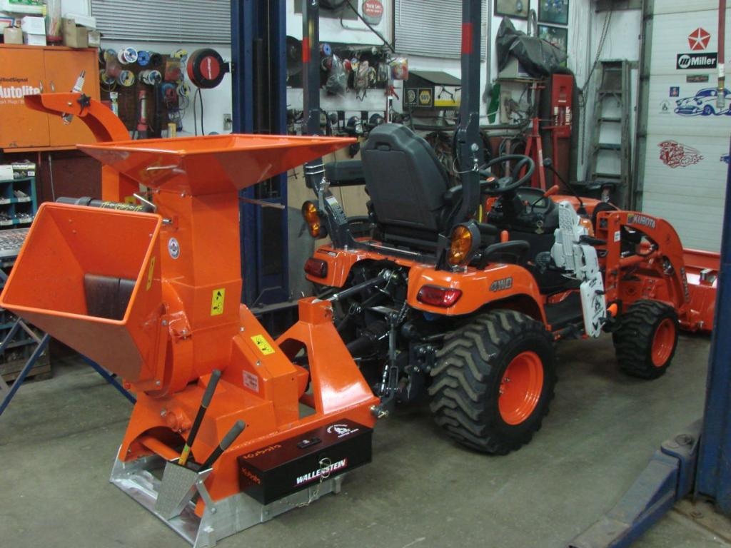

I put a Wallenstien BXM32 on our new Kubota BX25D and although I only put an hour on it up to this point it eats anything around 3" and then some. The chipper is good for a 1" and a bit.
/ Need chipping advice #18
Great set-up. I like the bottom stand with the tool box and the pocket for the trimmers.
