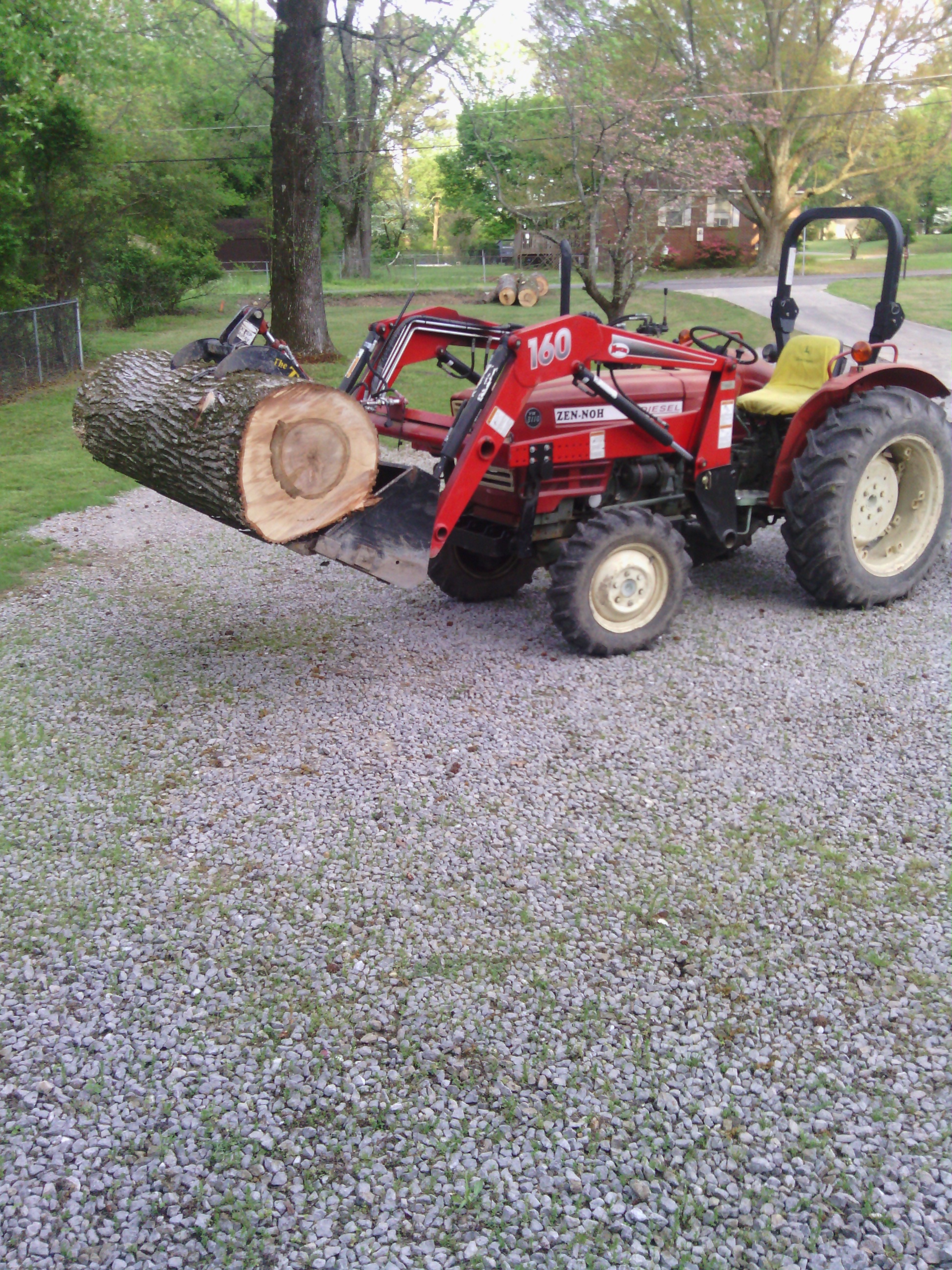

The one disappointment with my grapple (EA Wicked 60" double lid) has been picking up firewood rounds. It's no better than the bucket was.. maybe slightly worse. I think it'd be even worse at picking up split firewood. It could be that I need more practice but I have loaded a couple large gooseneck trailers with rounds using it and I have not gotten even a little better. For every other task it's been better than expected. So I'm not disappointed. But you may be if picking up firewood was the primary reason for getting it. I'd at least talk to people who have tried to pick up split firewood with a grapple and pay close attention to the spacing between the tines. Most grapples (like mine) have wide enough spacing that burnable size material can fall through.
Could you task the boys with stacking firewood in the boxes (or do it yourself) and then use forks to move them?
Kubota rates their loaders at a distance from the pins (I think it's 18" but could be wrong) while most everyone else rates them at the pins. You don't often pick up something by the pins so that inflates the rating somewhat.
My Branson dealer ships. Others do as well. So far I've only needed filters.
/ Buying Advice: Tractor Sizing #36
I could pick up split firewood off concrete pretty well, but not so much off dirt. I couldn’t pick up very many at a time but picking up rounds of firewood was no problem. What is your setback with it?
/ Buying Advice: Tractor Sizing #37
Are you picking up rounds one at a time? Trying to pick up rounds out if a pile is fruitless in my experience.

I could usually pick up big ones 3 at a time off the ground. Picking up rounds under 12” took forever and I threw those in by hand. I could get a few out of a pile but you had to get under the bottom. Moving rounds isn’t a very common occurrence for me since I try not to cut them until I’m ready to split them because as you’ve found out moving rounds is hard.
/ Buying Advice: Tractor Sizing #40
I usually lost more than I packed out of a pile. I guess I expect more productivity than I should.
