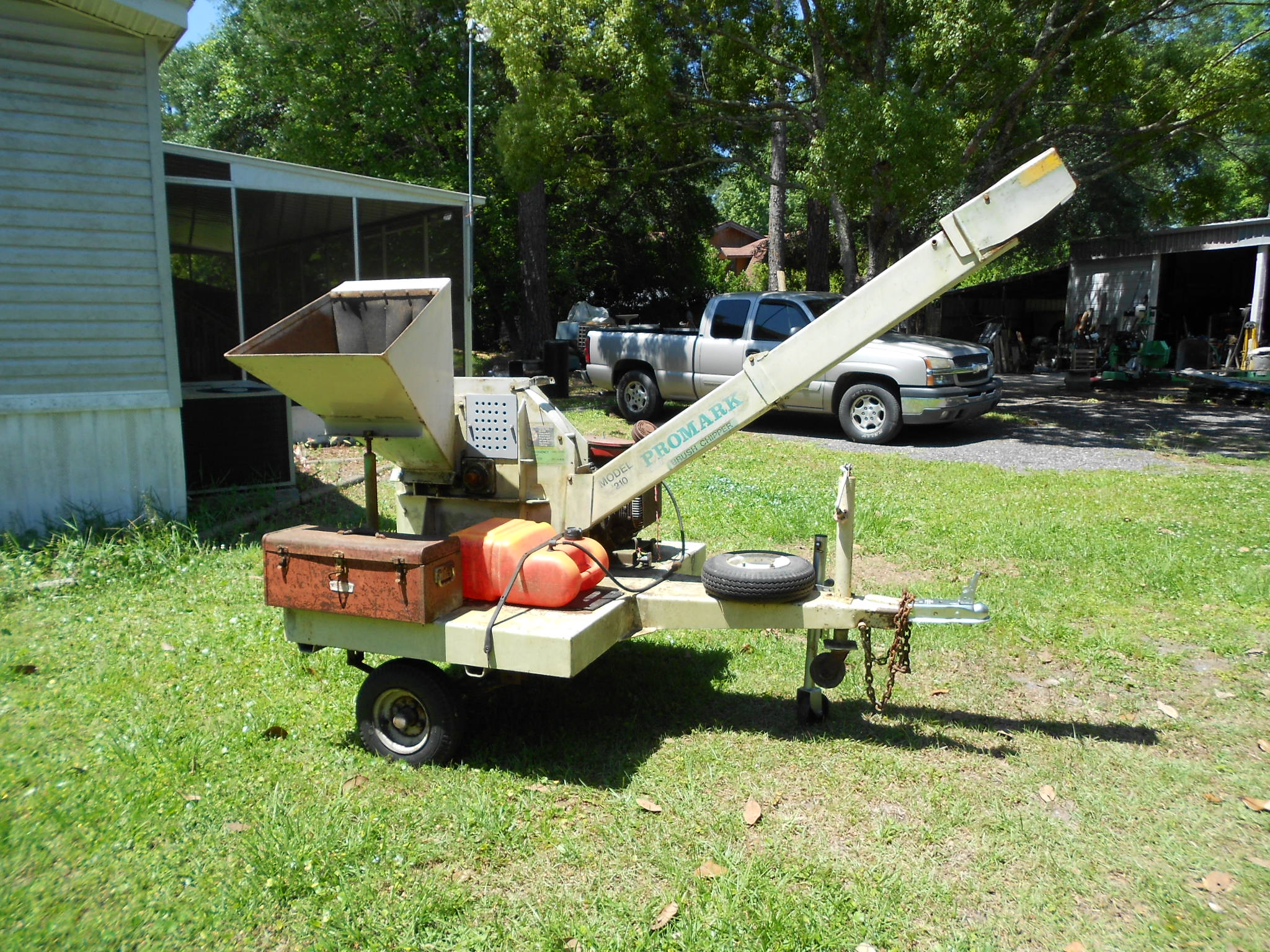

Something you are overlooking is Hp is only part of the process.
They use a flywheel to do the work. Once the rpm gets up to speed you feed and monitor the rpm.
At times you allow rpm to recover, it's not a constant feed.
I have used/owned 12" commercial units and owned a smaller unit (pic) that had a 18 hp ONAN.
Even that little one did a great job!
