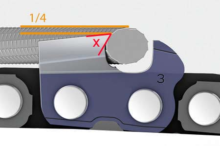

   / Need advice on a larger chainsaw for an older guy. #210
I used the Timberline for a while, but found I couldn't get the grinding burr to consistently rest on the bottom of the chain. After a few sharpens, the undercut of the cutting tooth disappeared (Angle X), and came closer to a right angle over time.
So I've gone back to using a file with the original file holder, and flat file with the depth gauge, which came with the Stihl 026 all those years ago.
That said, the Timberline is a clever bit of design for maintaining the teeth at the same length, so it's still in the tool kit.
