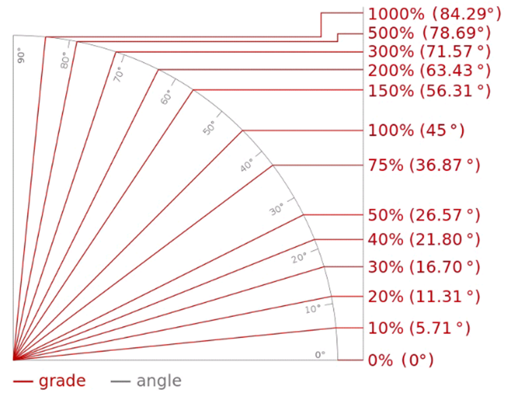

This got me interested in what slope I was mowing. So with a four ft. level I put a tape measure on end straight down to ground, other end level on ground above. I mowed left side of fence two days ago before rain.
So it was 18.5", divide by 48" is 0.3854166667, times 100= 38.5 degree slope. Am I correct?
No, I think it is 38.5 %. Calculating Slope and Common Slopes in Architecture - archtoolbox.com
Cut with Cub zero turn mower. Straight down each time.View attachment 659932View attachment 659933View attachment 659934
You've calculated percent grade.
Degrees (as in the angle) would be tan(theta) = 18.5/48.
Solving for theta yields:
theta = atan(18.5/48) = 21.1 degrees.

Because for every 4ft with my level it drops 18.5". Every 100ft it drops just over 38.54ft.
As I understand slope it's rise/run.
In this (my) hill example it's 0.3854.
That times 100 = 38.54%.
In degrees it's 21.08°.
Calculating a Slope
"To calculate a percent slope, simply divide the elevation change in feet by the distance of the line you drew (after converting it to feet). Multiply the resulting number by 100 to get a percentage value equal to the percent slope of the hill."
