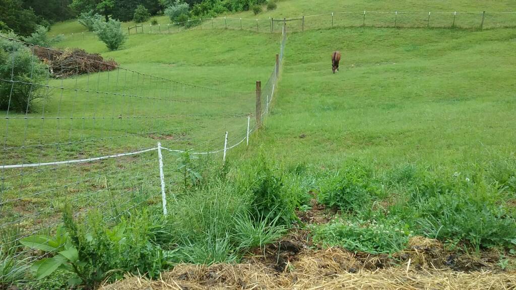

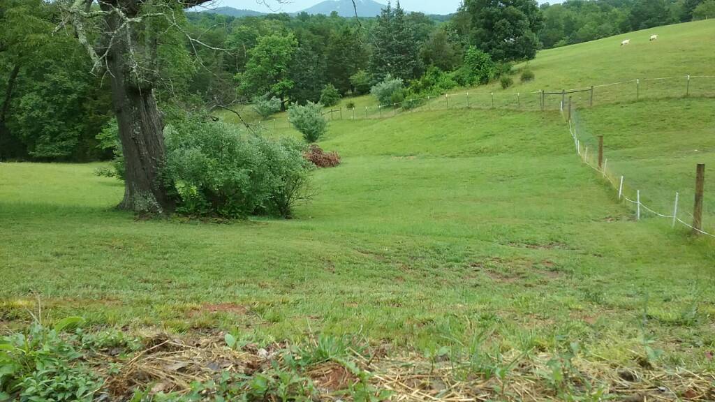

/ Need a zero turn that doesn't exist? #28
This got me interested in what slope I was mowing. So with a four ft. level I put a tape measure on end straight down to ground, other end level on ground above. I mowed left side of fence two days ago before rain.
So it was 18.5", divide by 48" is 0.3854166667, times 100= 38.5 degree slope. Am I correct?
Cut with Cub zero turn mower. Straight down each time.View attachment 659932 20200616_160420.jpg20200616_155953.jpg
Cut with Cub zero turn mower. Straight down each time.View attachment 659932View attachment 659933View attachment 659934
You've calculated percent grade.
Degrees (as in the angle) would be tan(theta) = 18.5/48.
Solving for theta yields:
theta = atan(18.5/48) = 21.1 degrees.
