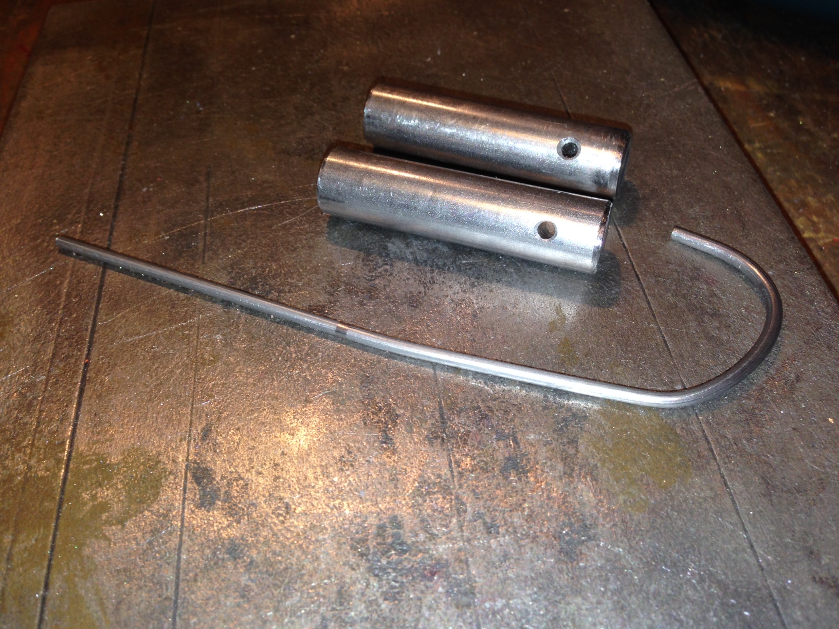

This was my solution to the HF bolt/pin problem. I made two short pins from 1/2 round bar with small holes drilled on the inside of the bracket, not the outside. Then one piece of piano wire keeps both in place and is easy to remove. The piano wire is bent slightly so is always in tension, cannot work out. The pins do not stick out at all so cannot interfere with any attachment.

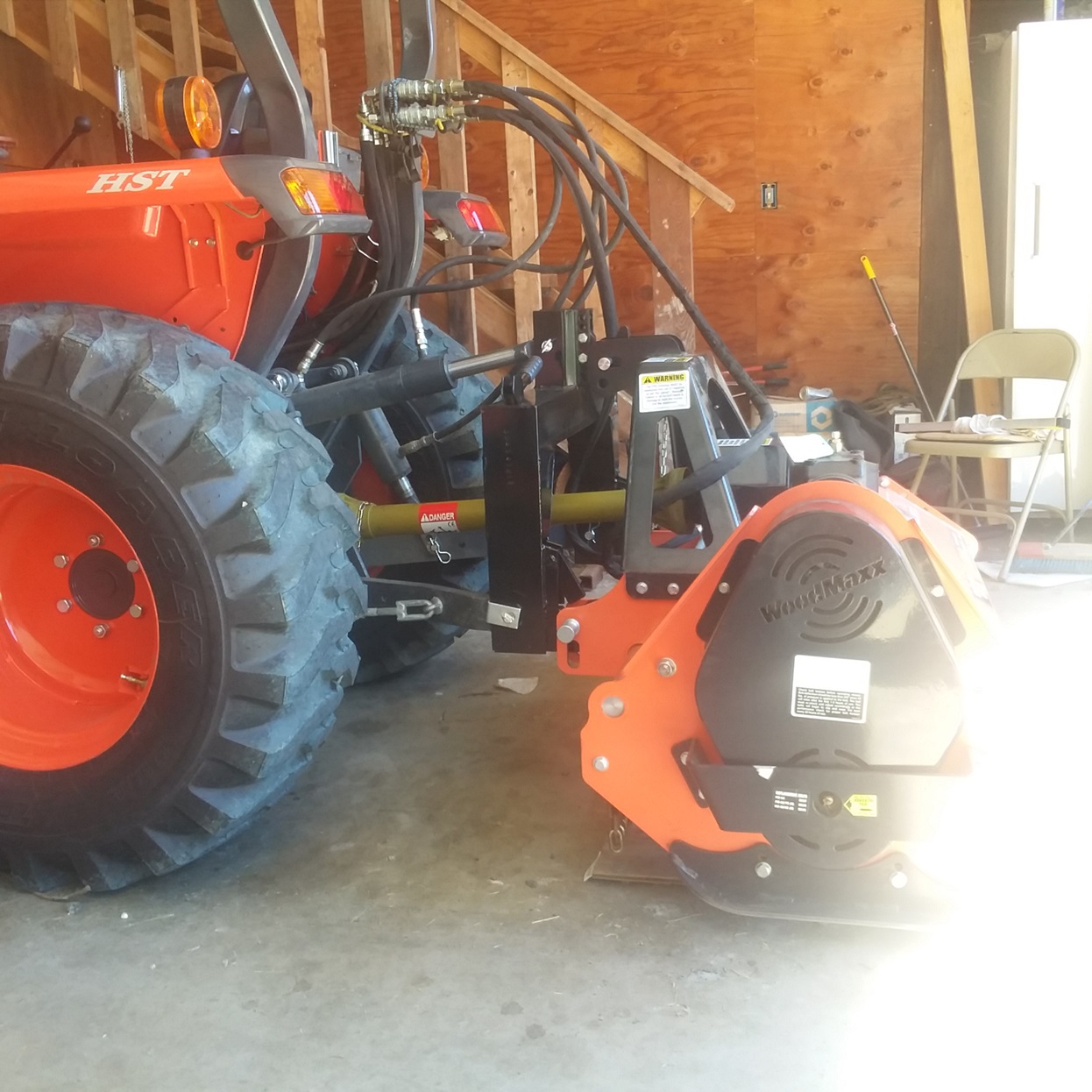

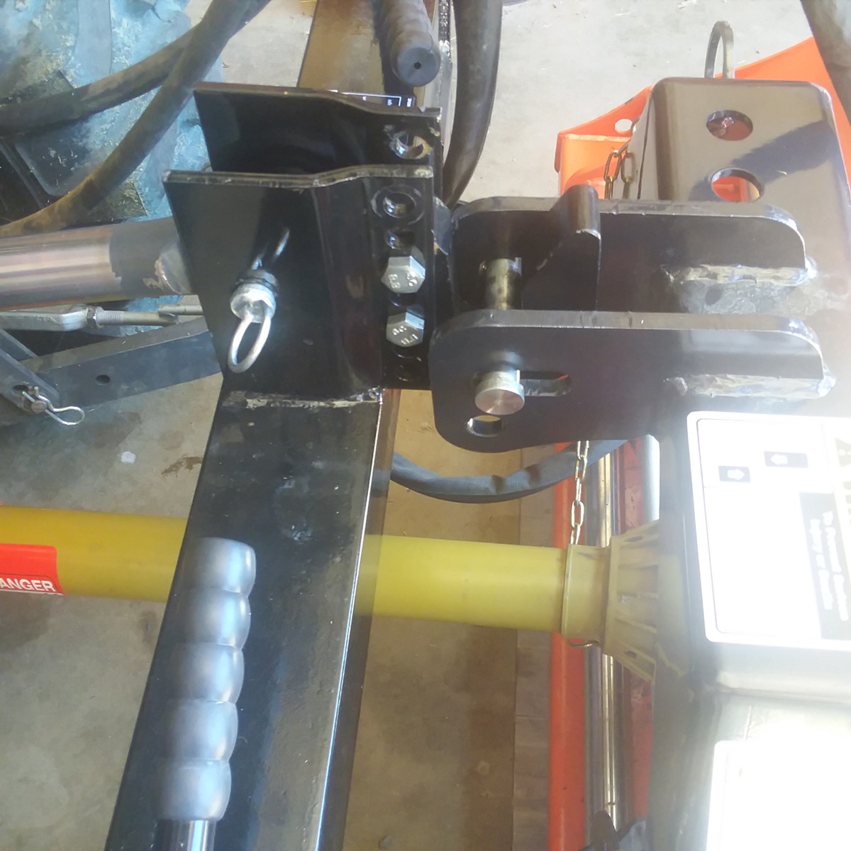

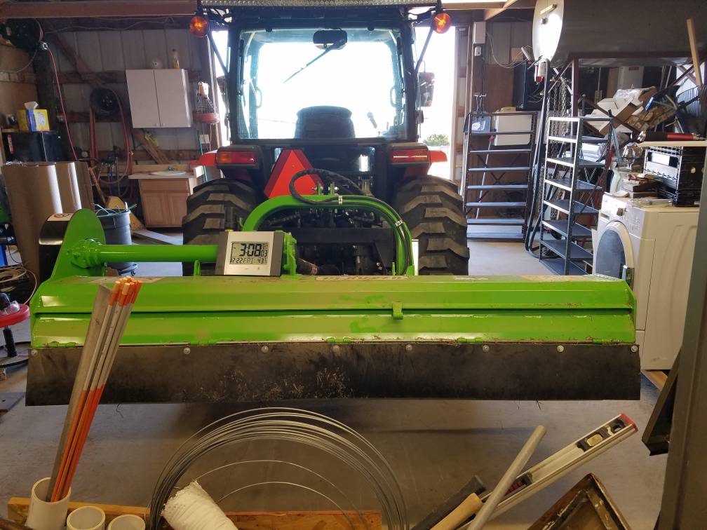

So this is the top link hook that came with my QH requiring no welding or new holes. Also the setup as it looks now in mowing position with skids tilted up in front and weight on rear roller. In this position, it has 7.5 inches of overlap on the PTO shaft so hopefully that is sufficient as I have no hills or ditches, just a couple mounds here and there.
Looking at the first pic I'm surprised at how little play it has in the top link for independent tractor and mower movement.
My brush hog has a floating adapter that pins thru the top link pin and extends to in line with the hook slot, it's just two pieces of flat stock with holes to pin to the top link and the wobble hook on the bush hog. It allows for a considerable amount of movement without binding that way. Of course your flail mower is much shorter so it may not often see much fore an aft movement at the top link while mowing.

Lou. You make a good point. - The current setup top hook allows maybe one inch of back and forth movement; also the mower itself has another inch in its mounting bracket, not much movement IMO. My field is 99% flat with a small mound or two that rise and fall very gently maybe 10 inches is all. If needing more movement, and I may, I can adapt using a flat piece of metal with an elongated slot where my hydraulic top link cylinder is pined at this time and perhaps something like what you are using. As things are, I use the top cylinder to push the mower's front end up and out raising the skids a little to prevent scalping so, there is always pressure in holding the mower front up while putting weight on the roller. Not sure how this works in my case if having several inches of slop back and forth? Another learning curve here being new to PTO implements and their use. Can you post a photo showing your top link setup?

The top hook in your new HF QH looks like the same it's always been. I.e., doesn't extend any further than before. From the pic on the right, it works fine for quick hook-ups with your mower, but with other implements you may still have the problem that others mention: The bolts can interfere with the walls of some implements' top linkpin bracket. Two ways to help with this, as you've seen. (1) Make up the type of pins that downsizingnow48 shows in his pic. They fit flush, and are held in place with a hairpin between the side of the tophook and the inside of the bracket. I did this on both my two HF QHs a couple of years ago and it helps a lot. Got the original idea from another TBN member, KennyD. :salute:
Or (2), replace the original top hook with this extended version from Quality Farm Supply: 873-HF141137 TOP HOOK FOR CAT 1 QUICK HITCH S141137 - Quality Farm Supply I finally went ahead and bought two of these last week, and they work perfectly in the HF hitches. I also reused the flush pins I'd made, so I'm covered that way as well.
BTW, I noticed today the replacement hook is again out of stock at Quality Farm, but I'm sure they'll restock. Evidently a popular item. :laughing:
