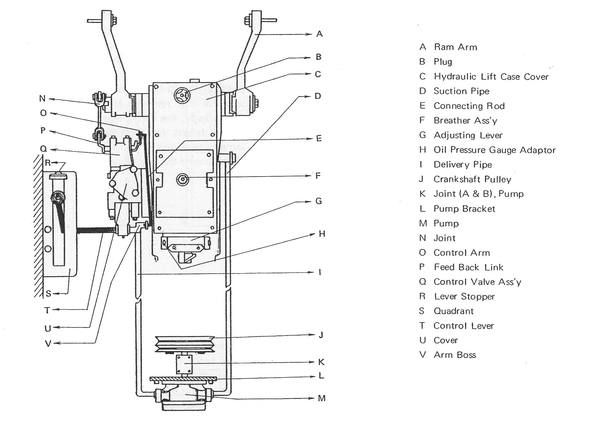

Hi Guys,
I have an old Satoh tractor which has the above FEL on it. One thing after another keeps braking on the old girl but she is fine for my uses.The bucket lever has always been slow and harder to push in to dump the bucket, than curling it up. It has finally given up the ghost and now is extremely hard to push in and goes slower than a snail, making the FEL unuseable.
The lift lever on the left is quite snappy front to back and also "locks in" to the valve when fully pushed forward. I swapped over the hoses to eliminate the cylinders being a problem. The bucket then worked as normal and the problem was transferred over to the arm lift.
There are no manufacturer names/numbers on this valve though I imagine it was a generic valve of it's time. What are the possibilities of finding parts for it or should I look to buying a new valve?
If it's a case of broken parts, which part do I need to undo? The top screw on the right or the cap at the front of the valve body inline with the lever?
FYI the hydraulic pump is mounted on the front of the crankshaft by coupler. Kayaba GP-1 pressure loading. 4.1G/min open center. A real speed demon 😁

It's doubtful you will find anything parts wise other than O rings. I would plan on a new valve. They are plentiful, available everywhere, and not all that expensive. I wouldn't recommend one of the "super cheap fifty nine dollar" models, but easily found for $150 or so. I have good luck with units in that price range.

Is there another relief valve on the pump discharge before this valve? If so, this ones setting doesn't matter. If not, this one should be set to your system pressure.
Does the front pump serve just the loader, not the 3ph? If it runs anything besides the loader, I'd expect the valve to have a third connection besides 'in' and 'out', commonly called 'power beyond'. If so, you'll need to order a power beyond adapter sleeve.

Thanks for the reply and extra questions. I don't know what I don't know about hydraulics :ROFLMAO:
It does have a 3pt on the back and the 2 hoses that supply and return are fed from the rear hydraulic tank. I know from looking at the manual about the flow/psi from the hydraulic pump and just that it stated the pressure relief valve was set at 1706psi. But have no idea where it is or what it looks like.
I will get some more photos. But the control valve that is on it has been on it from since before I got the tractor and has been working for the last 10yrs.

Bear in mind that the valve in your photos is not configured for power beyond. That isn't a concern if the oil supply and return don't involve the three point, steering, or any other hydraulic functions. Is that the case?
And yes, the relief valve setting on any new valve you install will need to be set to match your system requirements.

The 3 pt is involved. In those last photos it shows the 2 hoses coming off a block which is the hydraulic tank. In that same photo you see the linkages for the 3 pt lift lever. This is how the system was setup when the loader was installed. From what I have seen online all Satoh 650G were setup this way.
They did have an option of power assist steering which could be factory or field fitted. It had a priority design valve which was installed prior to the FEL control in the supply line.

Those are all good questions, and 20 years ago we used to hear them more than now. But then your Satoh is also from an earlier era, so it all nmakes sense.
First of all, some notes on your replacement loader control valve. You say you have 1/2" NPT fittings on your hoses & I see that Summit has a European made - whatever that means - replacement two spool control valve one for $109 that is rated to 11 GPM and it has SAE O ring ports. It should work.
The port sizes are never a problem. You simply need thread adapters to go from one thread type to another. In fact your old control valve looks in the photo like it has thread adapters already. If they fit, they are reusable. If not, order the right size.
ALWAYS order the PB adapter sleeve and theaded plug with any FEL control valve. They are specific to each model of control valve and if you don't one with the valve you never can. There is no downside to having the PB port & sleeve option. It gives you an additional hydraulic power option for power steering or a grabber.
Then if you go over to surpluscenter.com/hydraulics you will see that they sell a very similar overstock two spoolcontrol valve made by a well known company - Prince - for around $300. Why the difference in price? One reason is that inexpensive control valves tend to have O rings in some places where the more expensive ones have lapped metal sealing surfaces. Lapped sealing surfaces last far longer. Another is that the more expensive valves tend to be more precise about metering. The Prince is 8 GPM and most of their valves have small GPM steps than cheaper valves.
But either will work. Get the right thread adapters and the PB option. I don't use a detent myself.
Oh, on the relief valve. Ask about the setting. Most of these valves are standard 3000 psi max working pressure, so the relief valve will come set ten to twenty % below that. If so, no change is required.

Here is an overview of the system. The aluminum block with the 2 hoses is item U.
/ National loader #16 Hyd control valve problems #19
Here is an overview of the system. The aluminum block with the 2 hoses is item U.View attachment 871055
Well that's an interesting diagram. It seems to show the front crankshaft pulley as the only hydraulic pump in the system. If so, that's completely different from every other compact 4wd tractor of that era.
And if so, that aluminum block probably really is a proportional divider/diverter plate just as discussed.
Does the Satoh engine not have a typical tractor hydraulic pump? What kind of engine does it have?
From the diagram, that whole pump and pto seem to be assembled from parts from something else...
What are G & H on the diagram?
None of that affects the hydraulic valve and PS solutions we've already dscussed. The FEL control valve doesn't care where it gets pressure from, and from the valve anything else can be powered by the PB port.
rScotty
#20
rScotty
The engine is a 4cyl gas Mazda PB100. It's rated around 25hp. 3 fwd gears, high and low transmission with a rear diff lock. It is 2wd only. The crank pump is the only one.
The factory power steering flow divider for this tractor was installed on the supply/pressure line "I" just about where it shows the break in the line on the diagram.
G and H. From memory G controls the speed the 3 pt moves up and down. I need to find my small user manual and will get back to you with what it states. I don't remember if it affects the speed of the FEL. I will need to check that out. Edit: it does control the speed, the factory calls it a flow control valve.
H is an allen key plug. I noticed when I found that diagram online it states it's for a pressure gauge. I looked at the tractor and it would need to be a small gauge as there are linkages above it which control the 3 pt.
The 1st photo of the hydraulic tank area shows this. It is a red V shaped valve. It has a large pipe plug on the right hand side. The repair manual doesn't mention the reason for the large plug or what you could use it for.
