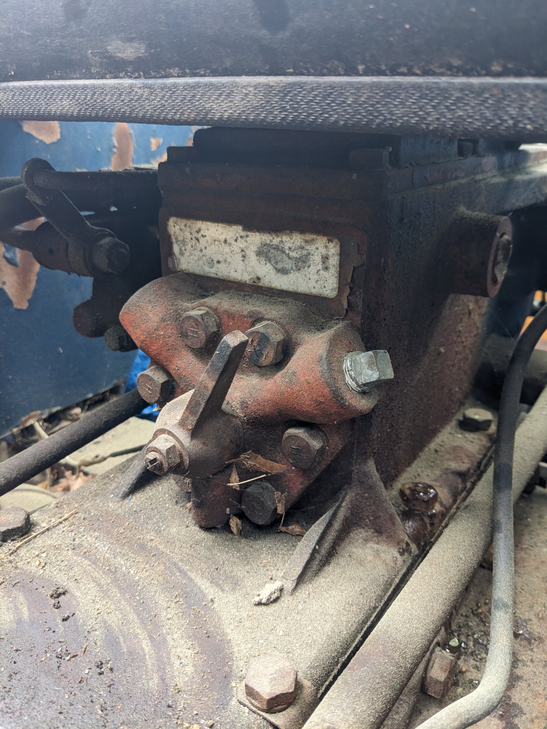

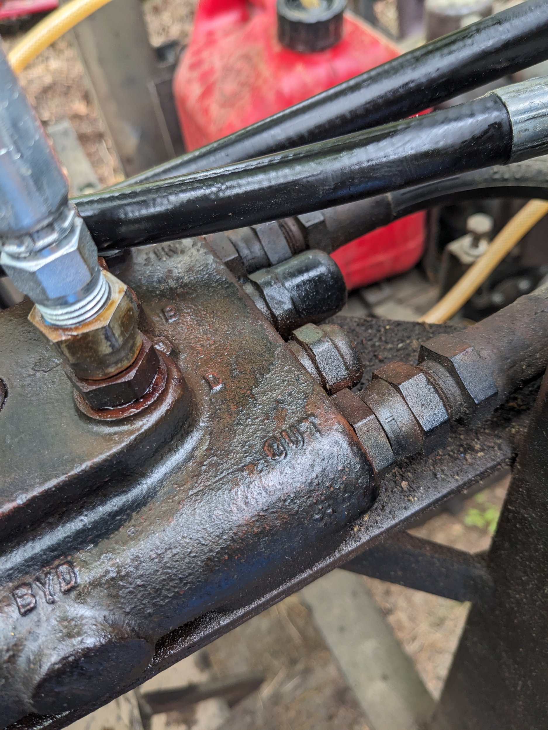

Hi Guys,
I have an old Satoh tractor which has the above FEL on it. One thing after another keeps braking on the old girl but she is fine for my uses.The bucket lever has always been slow and harder to push in to dump the bucket, than curling it up. It has finally given up the ghost and now is extremely hard to push in and goes slower than a snail, making the FEL unuseable.
The lift lever on the left is quite snappy front to back and also "locks in" to the valve when fully pushed forward. I swapped over the hoses to eliminate the cylinders being a problem. The bucket then worked as normal and the problem was transferred over to the arm lift.
There are no manufacturer names/numbers on this valve though I imagine it was a generic valve of it's time. What are the possibilities of finding parts for it or should I look to buying a new valve?
If it's a case of broken parts, which part do I need to undo? The top screw on the right or the cap at the front of the valve body inline with the lever?

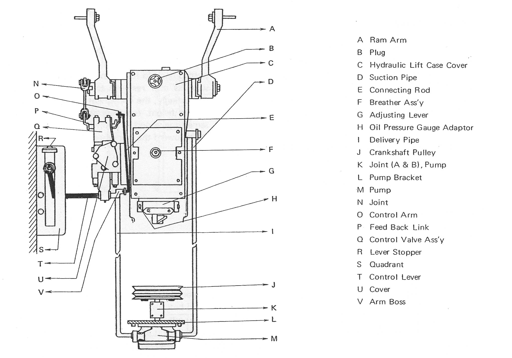

FYI the hydraulic pump is mounted on the front of the crankshaft by coupler. Kayaba GP-1 pressure loading. 4.1G/min open center. A real speed demon 😁

It's doubtful you will find anything parts wise other than O rings. I would plan on a new valve. They are plentiful, available everywhere, and not all that expensive. I wouldn't recommend one of the "super cheap fifty nine dollar" models, but easily found for $150 or so. I have good luck with units in that price range.

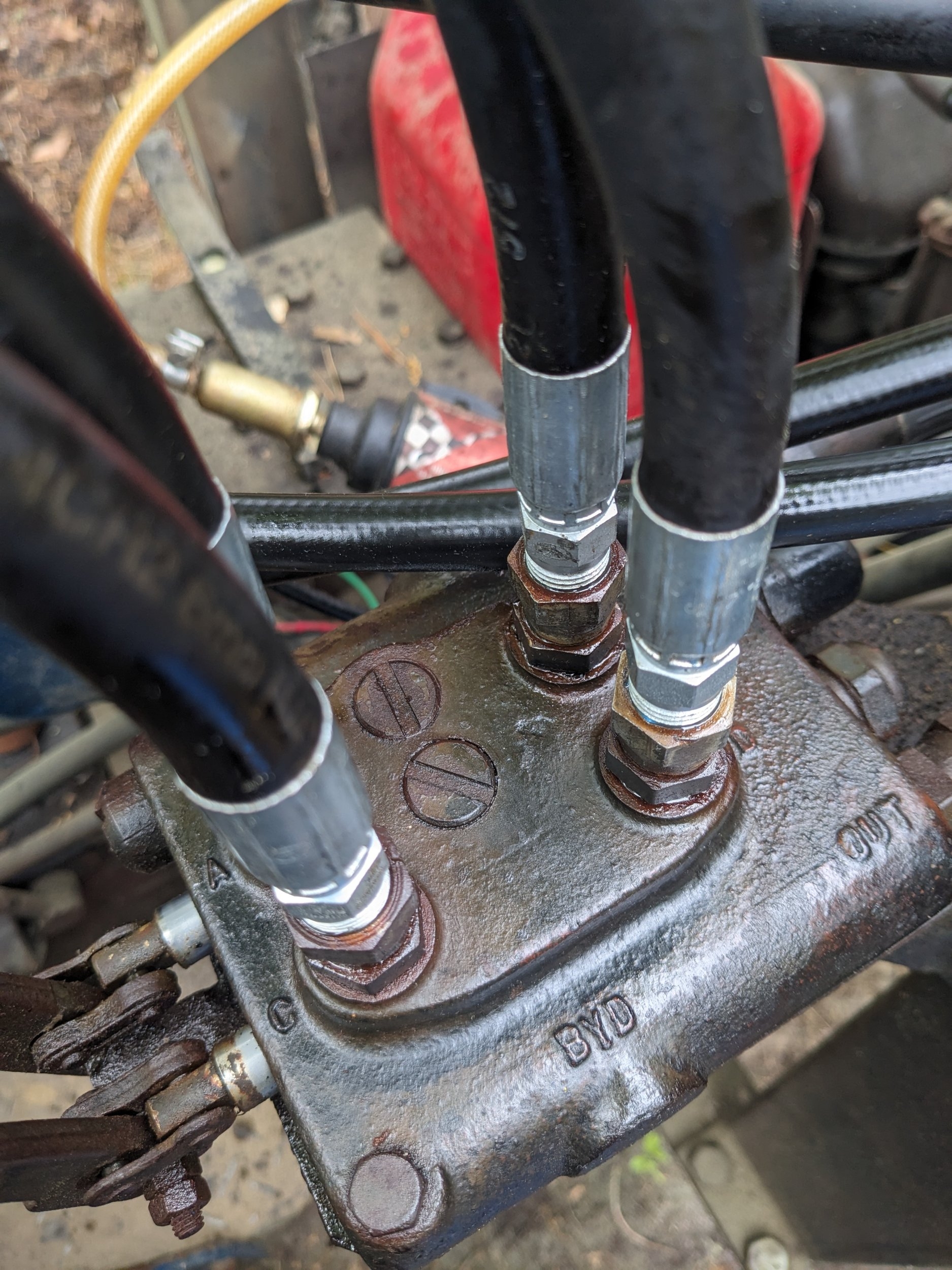

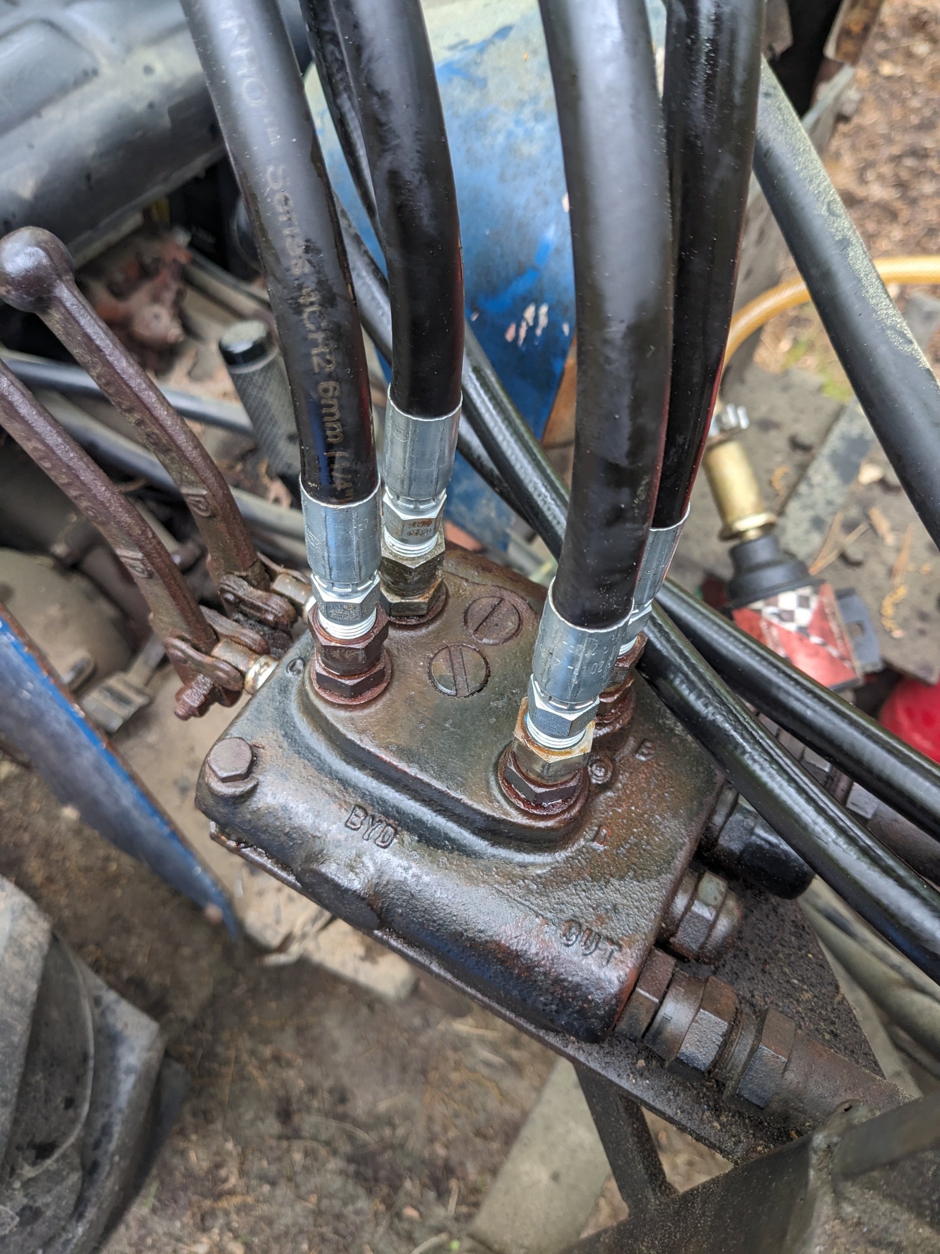

Well I know the 4 hoses going in the top are 1/4 NPT as I replaced them last year. Not sure the size of the In and Out hoses are. Will need to find a guide of how to measure them.
I'm not worried about the "lock in" feature as that slows the movement right down. Not sure why I would ever need that, it goes slow enough as it is.

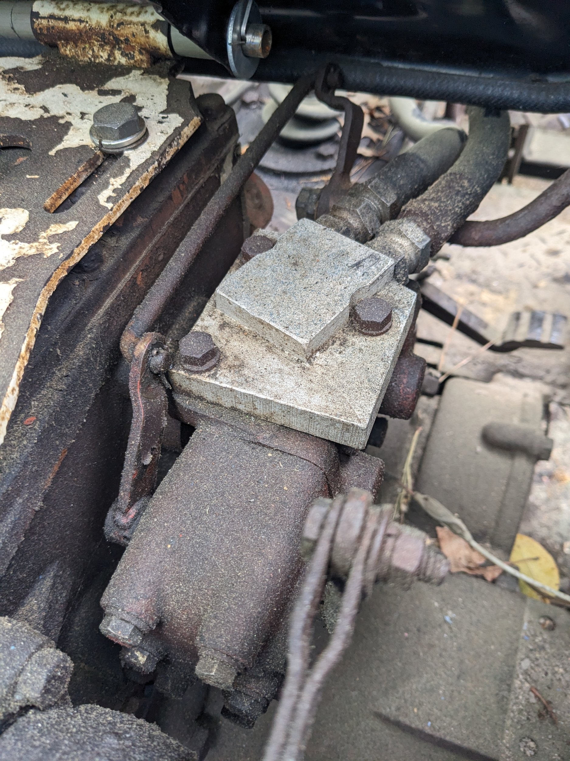

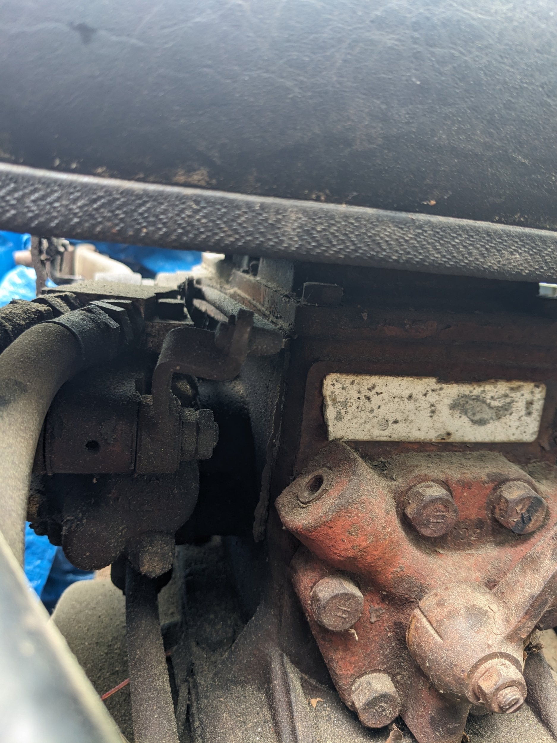

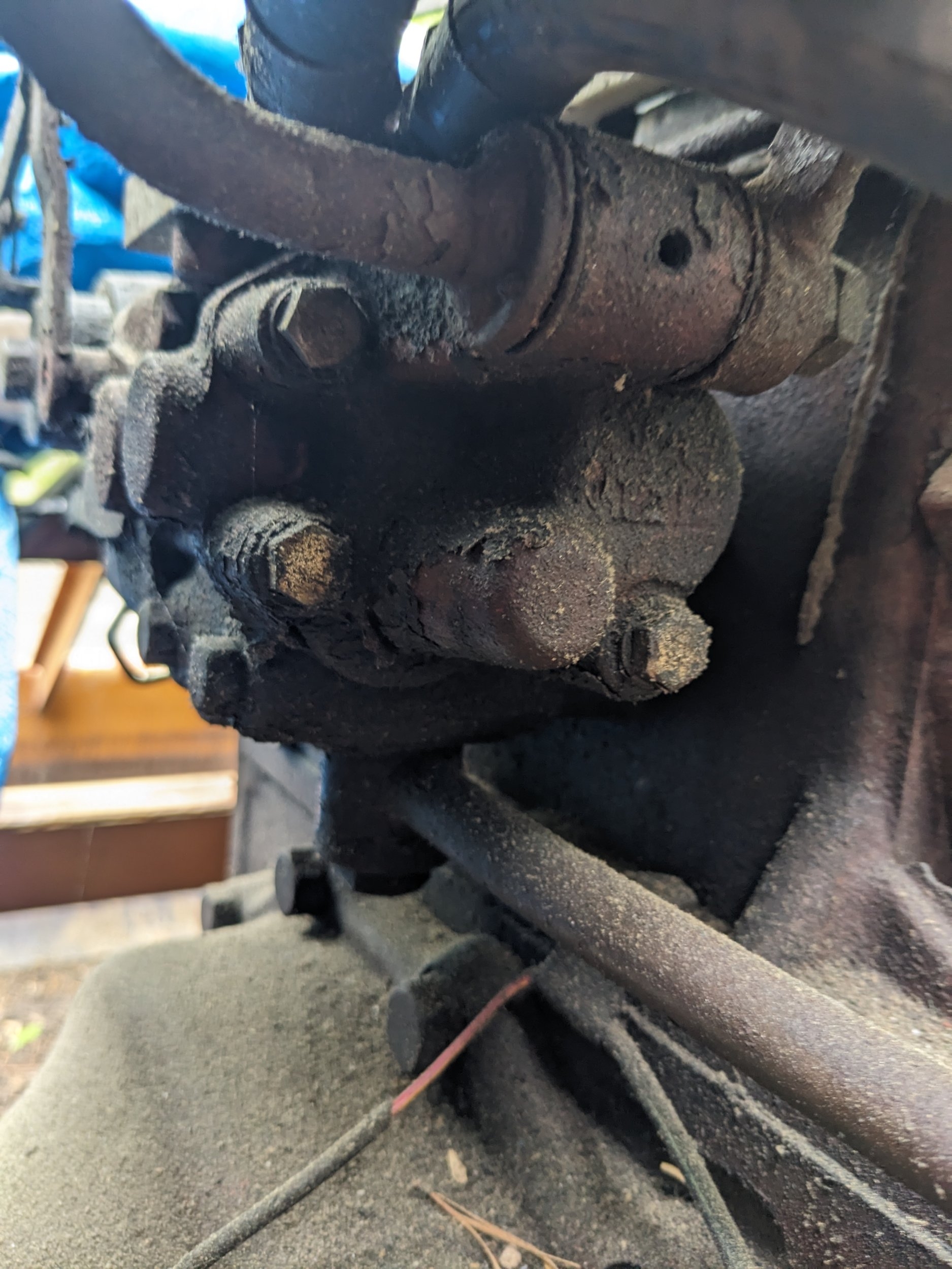

Here are those photos.

Bear in mind that the valve in your photos is not configured for power beyond. That isn't a concern if the oil supply and return don't involve the three point, steering, or any other hydraulic functions. Is that the case?
And yes, the relief valve setting on any new valve you install will need to be set to match your system requirements.

The 3 pt is involved. In those last photos it shows the 2 hoses coming off a block which is the hydraulic tank. In that same photo you see the linkages for the 3 pt lift lever. This is how the system was setup when the loader was installed. From what I have seen online all Satoh 650G were setup this way.

The setup with the tractor's own hydraulic pump working the 3pt and an optional power steering through a priority valve (not a diverter valve, a priority+diverter) was common.
Sometimes that same pump also powered a FEL, and those - hopefully - had larger GPM pumps.
BTW, a pump with low GPM flow rate still has the same pressure as a larger one. It does the same work, just slower.
A better option offered by some dealers on some loaders was an option to use a front crankshaft driven pump for the FEL only. It was an expensive option at the time. I know because I ordered that on our Yanmar about 1982. Some of those that used that system also used one or both of the loader uprights as the sump for the front-mounted FEL pump.

In my second photo you will see the 2 hoses coming out of an aluminum block.
Ok, on the gauge, that makes sense now to put it there and I can see the benefit.
If my steering box was not so badly damaged I would look to put the power assist on. Funnily enough I am a Ford hot rodder and I have quite a few of those rams I have taken off my cars, as they leak and are vague on the road. But would be great on a tractor.
/ National loader #16 Hyd control valve problems #17
I see the aluminum block now. Not sure what it is. But I have a similar one in my junk box.
This is just a guess, but I think what you have there may be half of an two-part assembly that was used many years ago nwhen a tractor was expected to maybe be fitted with a loader or power steering and they wanted the option touse the tractor hydraulic pump instead of the add-on front engine crankshaft-driven pump.
If so, the other half of that aluminum plate would have fit beneath it like a sandwich, and contained different diameter drillings. It's function was a poor man's proportional diverter plate in that it used different diameter internal passages instead of adjustable valving.
Like I said, just a guess. If that is what it is, leave it. It may be functioning as nothing more than a connector.

Here is an overview of the system. The aluminum block with the 2 hoses is item U.
/ National loader #16 Hyd control valve problems #19
Here is an overview of the system. The aluminum block with the 2 hoses is item U.View attachment 871055
Well that's an interesting diagram. It seems to show the front crankshaft pulley as the only hydraulic pump in the system. If so, that's completely different from every other compact 4wd tractor of that era.
And if so, that aluminum block probably really is a proportional divider/diverter plate just as discussed.
Does the Satoh engine not have a typical tractor hydraulic pump? What kind of engine does it have?
From the diagram, that whole pump and pto seem to be assembled from parts from something else...
What are G & H on the diagram?
None of that affects the hydraulic valve and PS solutions we've already dscussed. The FEL control valve doesn't care where it gets pressure from, and from the valve anything else can be powered by the PB port.
rScotty
The engine is a 4cyl gas Mazda PB100. It's rated around 25hp. 3 fwd gears, high and low transmission with a rear diff lock. It is 2wd only. The crank pump is the only one.
The factory power steering flow divider for this tractor was installed on the supply/pressure line "I" just about where it shows the break in the line on the diagram.
G and H. From memory G controls the speed the 3 pt moves up and down. I need to find my small user manual and will get back to you with what it states. I don't remember if it affects the speed of the FEL. I will need to check that out. Edit: it does control the speed, the factory calls it a flow control valve.
H is an allen key plug. I noticed when I found that diagram online it states it's for a pressure gauge. I looked at the tractor and it would need to be a small gauge as there are linkages above it which control the 3 pt.
The 1st photo of the hydraulic tank area shows this. It is a red V shaped valve. It has a large pipe plug on the right hand side. The repair manual doesn't mention the reason for the large plug or what you could use it for.
