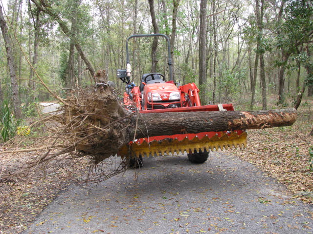

Not much of a definition, maybe grab and drag a downed 6" diameter doug fir tree? In any case, I'd be interested to hear about the lighter grapples for research.

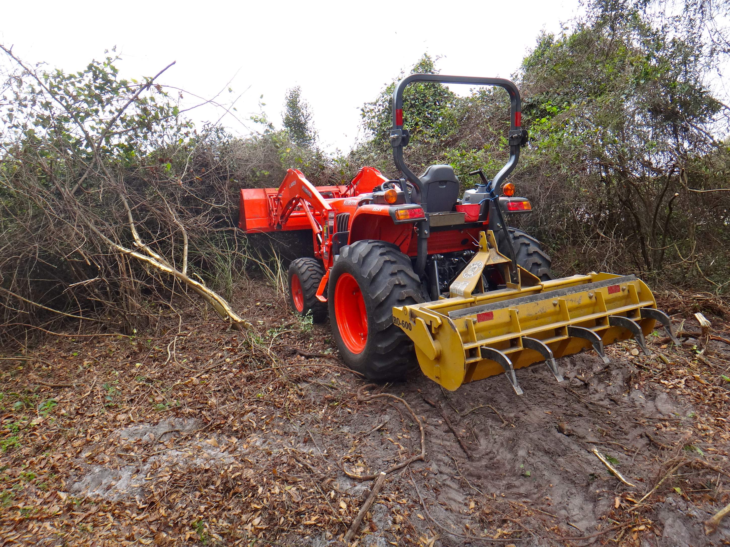

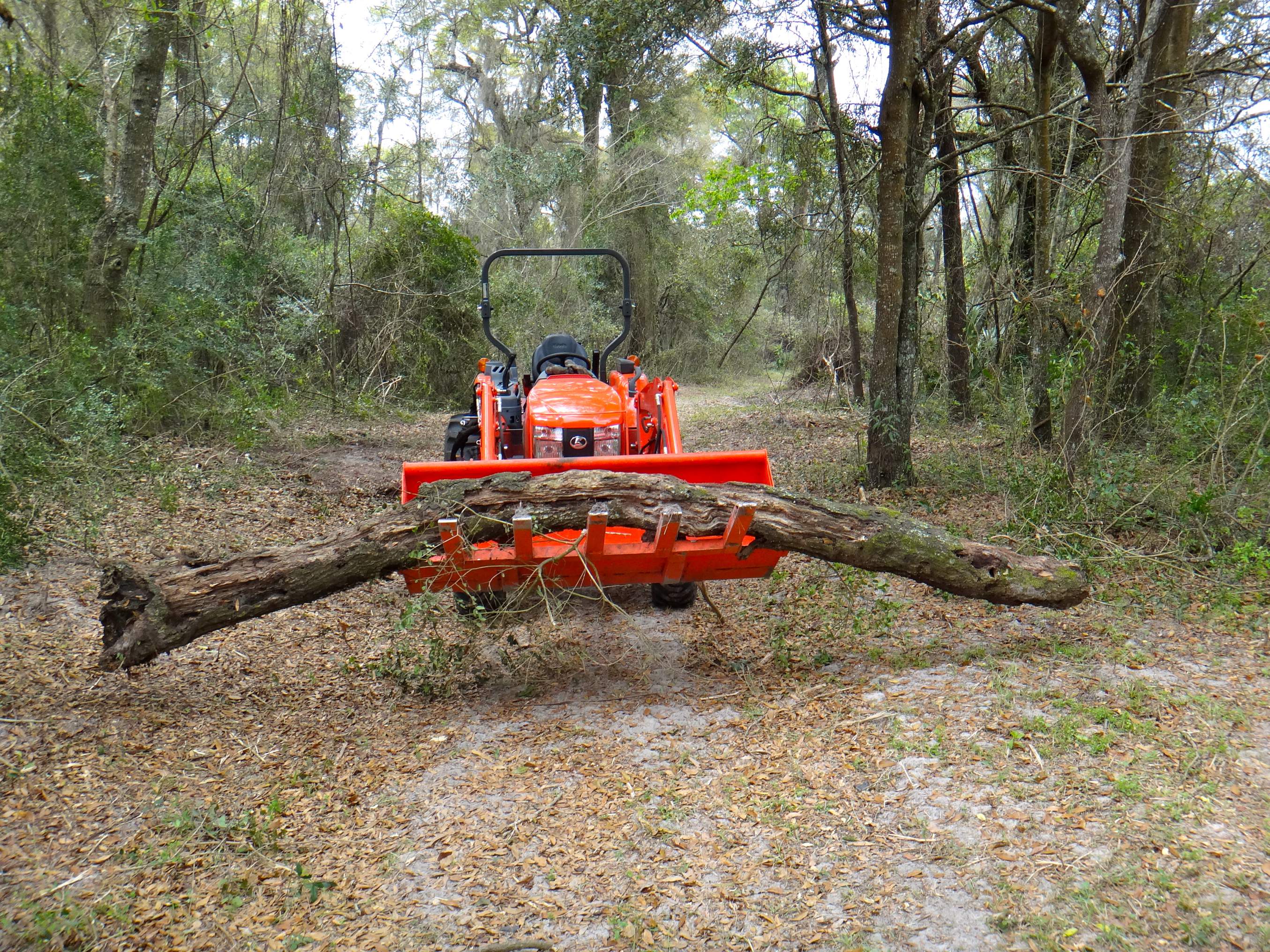

Here are pictures of my former 2,000 pound Kubota B3300SU, with LA504 FEL, carrying Oak tree trunks on Payne's Aluminum Debris Forks.
(Always with rear ballast on the 3-Pt.)
Kubota L3560 with LA805 FEL and L2296 HD Bucket is much more capable.
