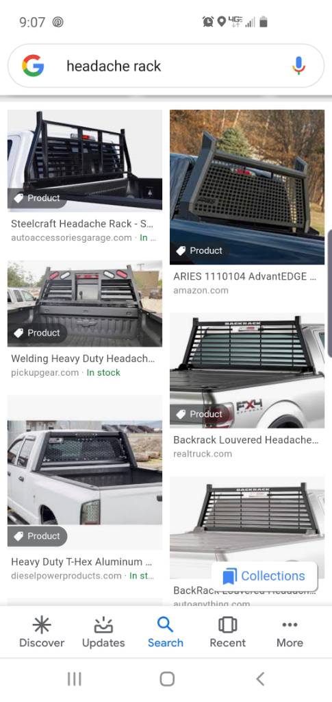

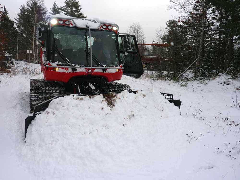

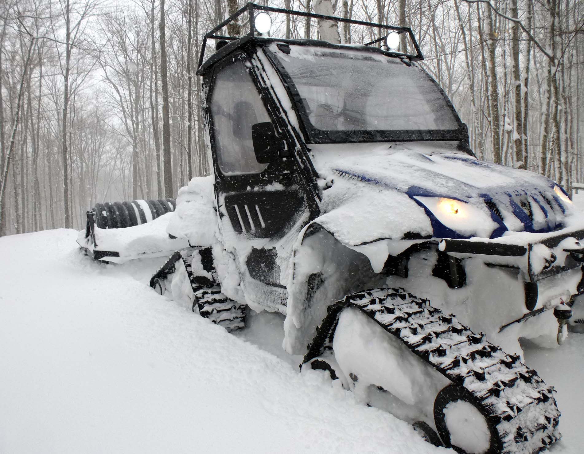

...I wonder about the weight.
-> In what way? Also, what's a "headache rack"? I have been pondering my options around and above the engine bay. At this time, I plan to install a pair of removable storage boxes that will be the same height of the engine hood. A removable frame will set on top of everything that could be used to lash down cargo. After I clean up the design some more, I will post an image for comment.
   / My Senior design project - a "Swamp Thing" tracked vehicle clone #222
Thanks for the kudos. -> In what way? Also, what's a "headache rack"? I have been pondering my options around and above the engine bay. At this time, I plan to install a pair of removable storage boxes that will be the same height of the engine hood. A removable frame will set on top of everything that could be used to lash down cargo. After I clean up the design some more, I will post an image for comment.
Headache rack is basicly the same thing as a roll bar. Usually used on work trucks and has mesh to protect the cab Screenshot_20191115-090729_Google.jpeg
   / My Senior design project - a "Swamp Thing" tracked vehicle clone #223
   / My Senior design project - a "Swamp Thing" tracked vehicle clone #225
It prevents a headache when an improperly secured load comes through your rear window. Or it gives you a headache when that happens (as opposed to no longer having a head to hurt or not).
