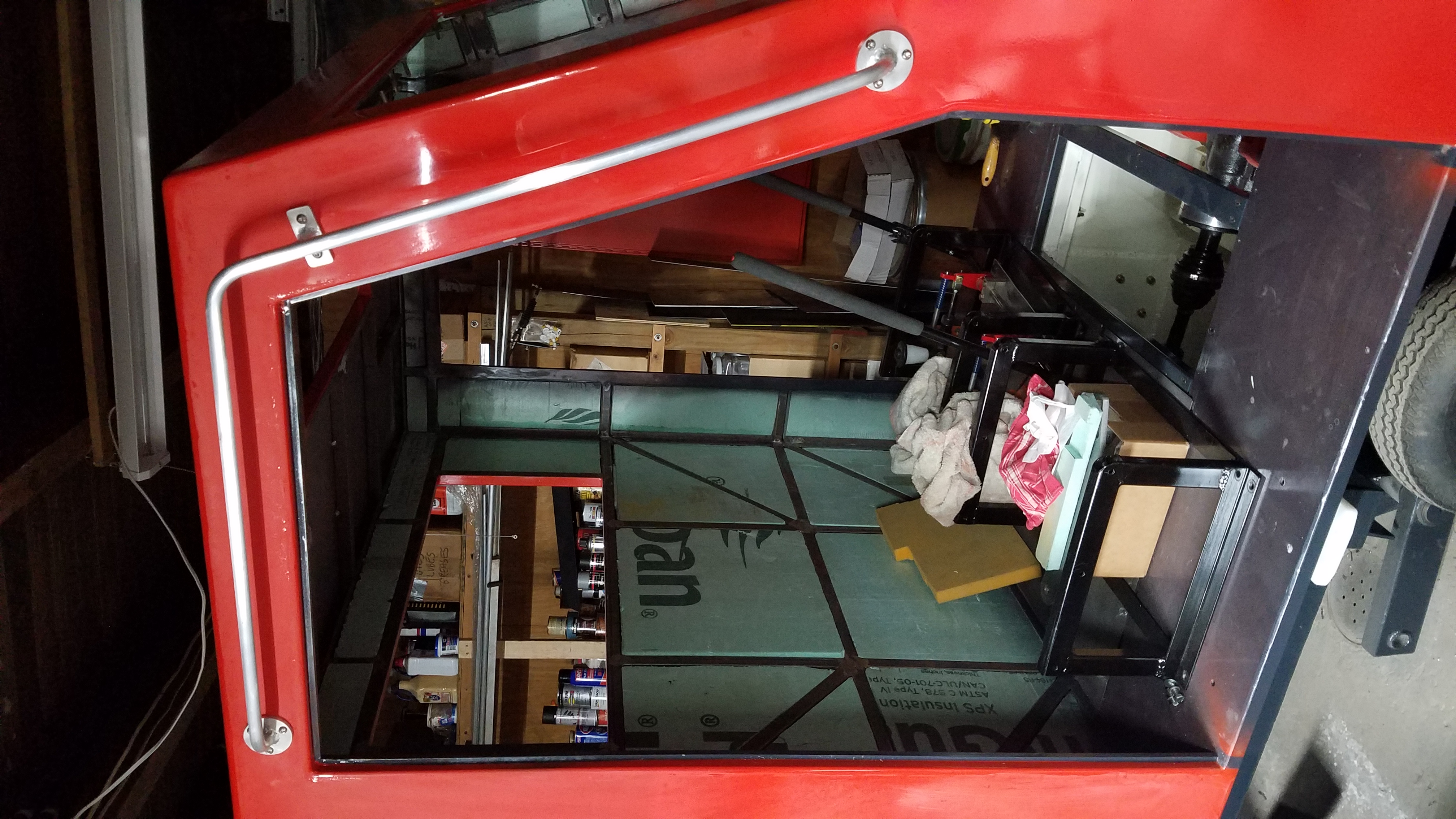

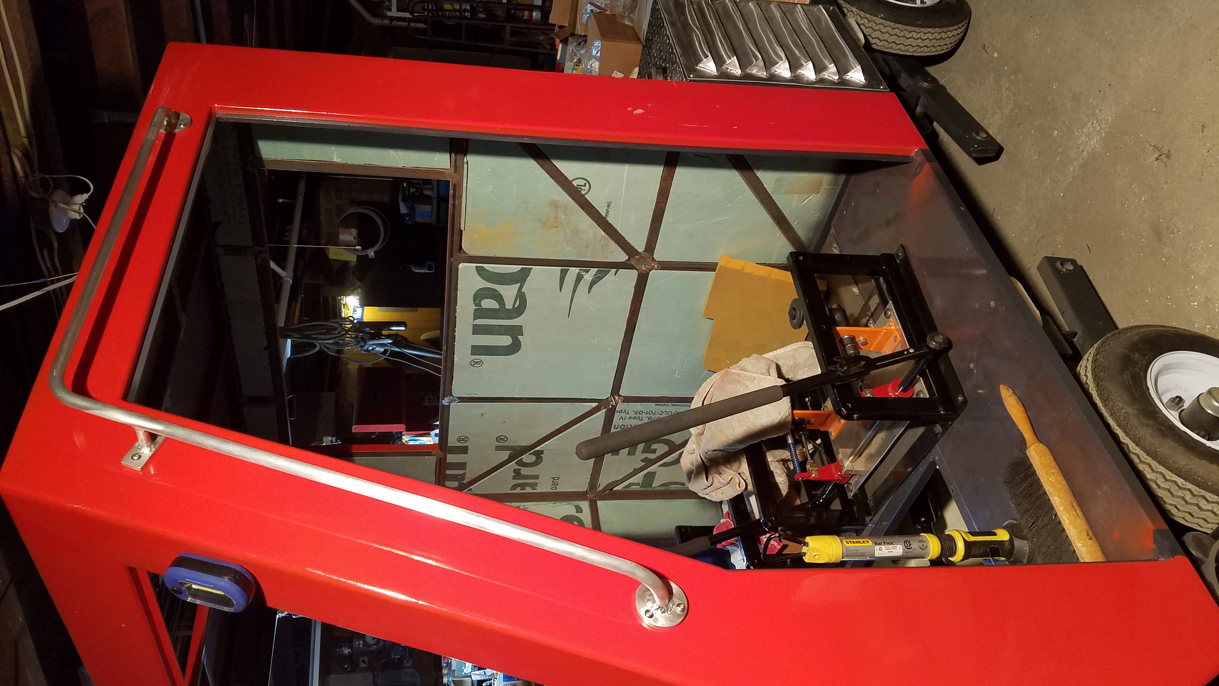

I spent the last couple of days assembling the grab rails:
View attachment 628988 View attachment 628989
My DIY tractor cab uses the same style of insulation, good thinking.

The external grab handle is a nice add-on. Clean.

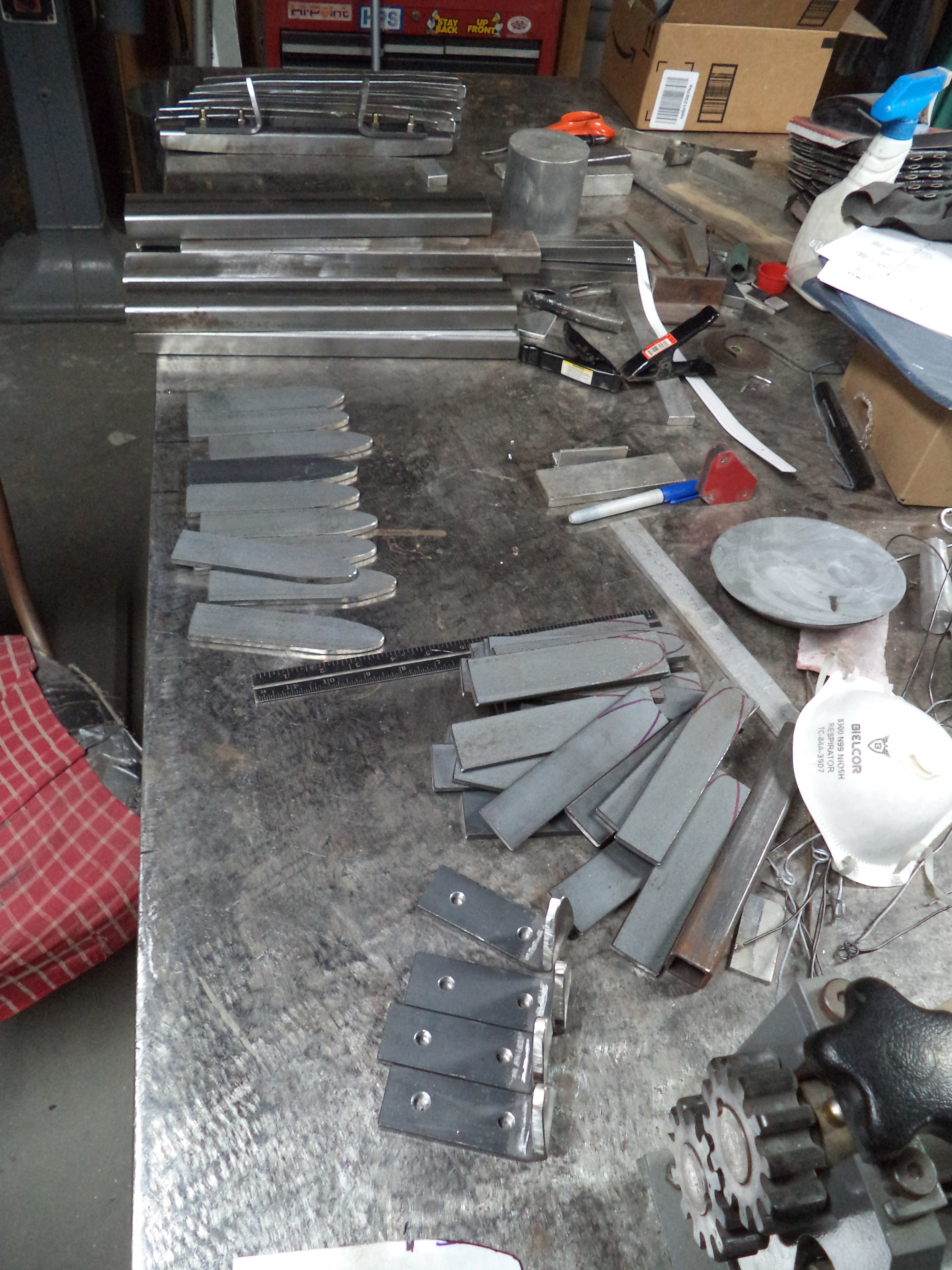

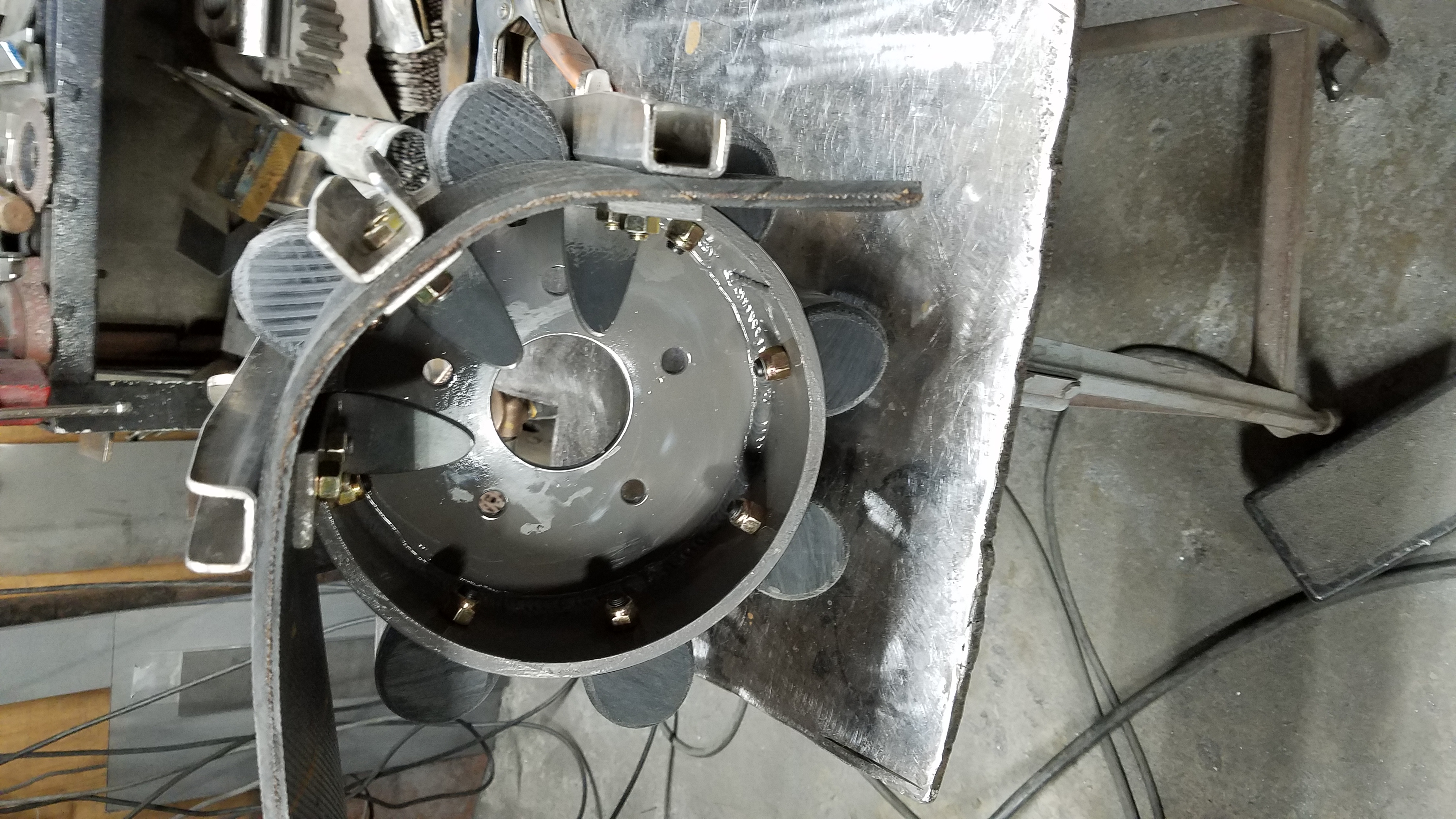

I spent today setting up a production line for making the track bars and wheel guides. I only need 126 track bars and 252 wheel guides. It is a good task for crappy weather days....
   / My Senior design project - a "Swamp Thing" tracked vehicle clone
#245

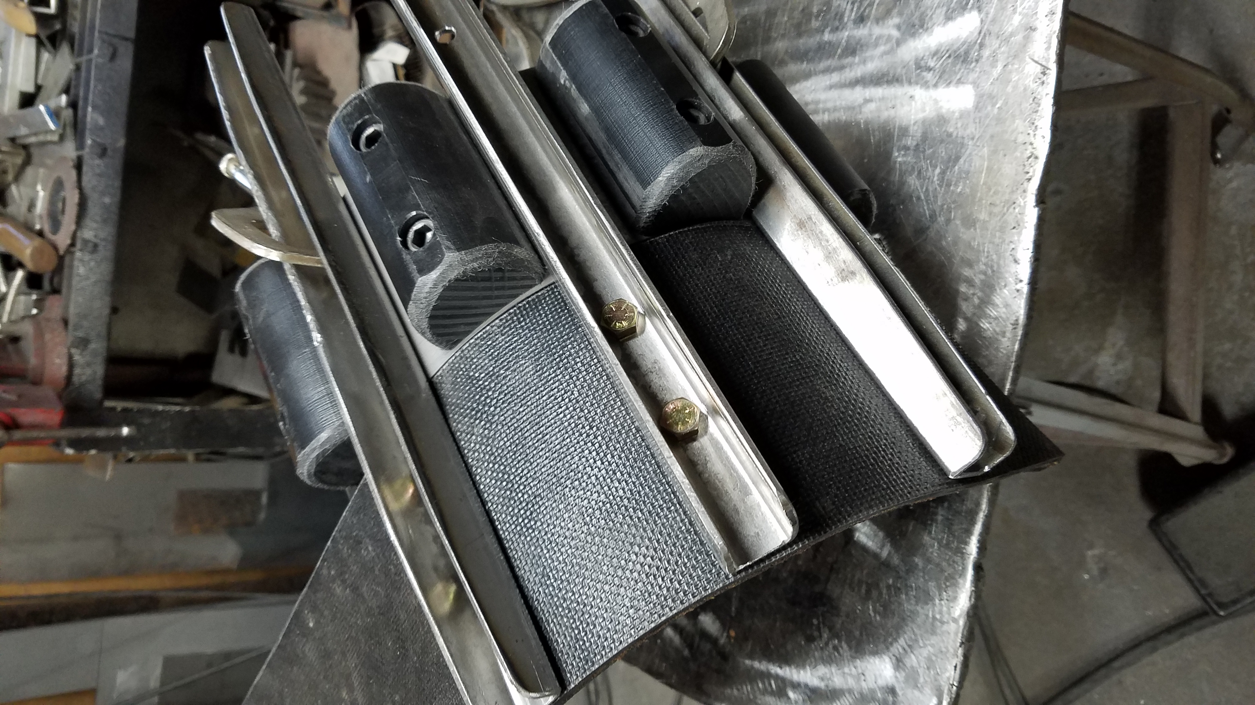

Hi gang - I was playing with a piece of my 5/16" belting trying to home in on a pitch distance for the track bars. I ended up using 84mm (3.307") as a value. I attached a photo of the bars placed around my drive sprocket. Tomorrow, I plan to attach the second 5" belt.

   / My Senior design project - a "Swamp Thing" tracked vehicle clone #248
Channel style cleats lost favor some years ago. They fill with ice or mud and loose much of there traction..

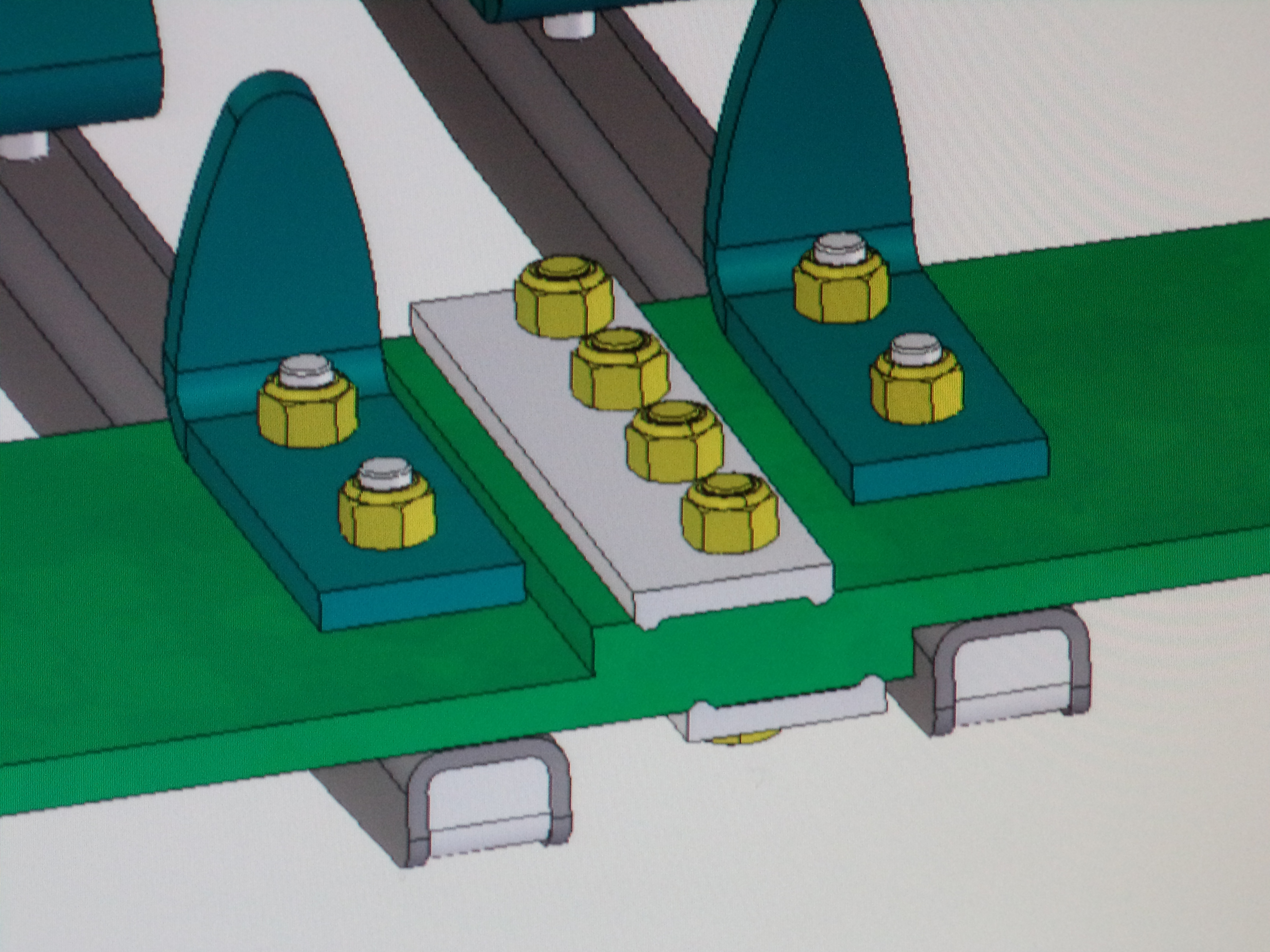

I plan to add a filler strip that will leave a bit of the two sidewalls of each track bar exposed. Also, thanks to ArlyA, I think I will be using his suggested splicing method as shown in my revised design:

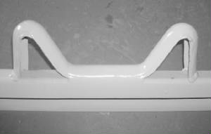

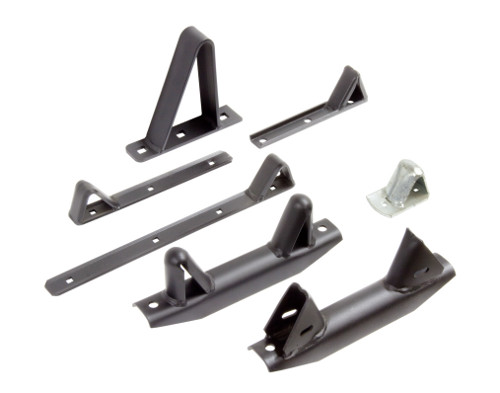

Here is some examples of tire guides. They should be rounded to keep from damage the tires. Turning while on a hard surfaces is really tough on sidewalls. The tires on snowcats are not normal but are commonly foam filled, highly belted and thick treads and side walls. You can still get air filled but most today seem to be foam filled. They live a hard, hard life.
