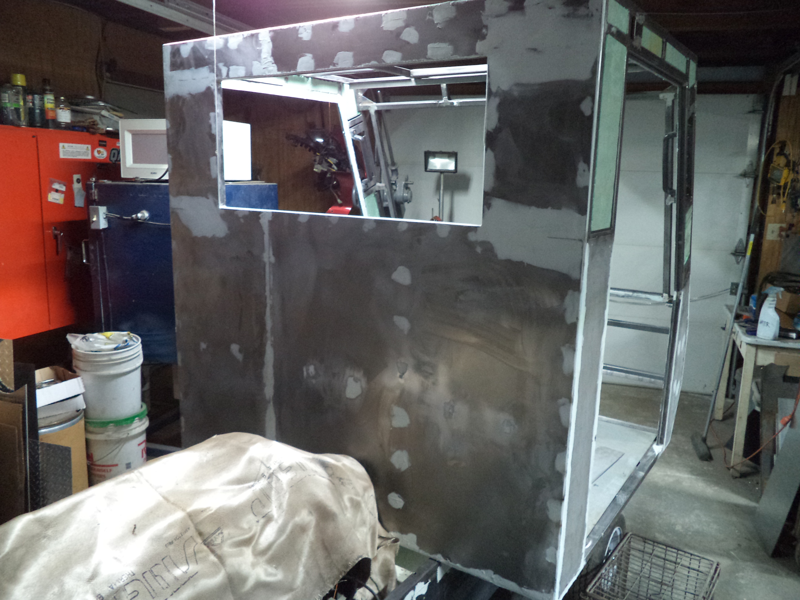

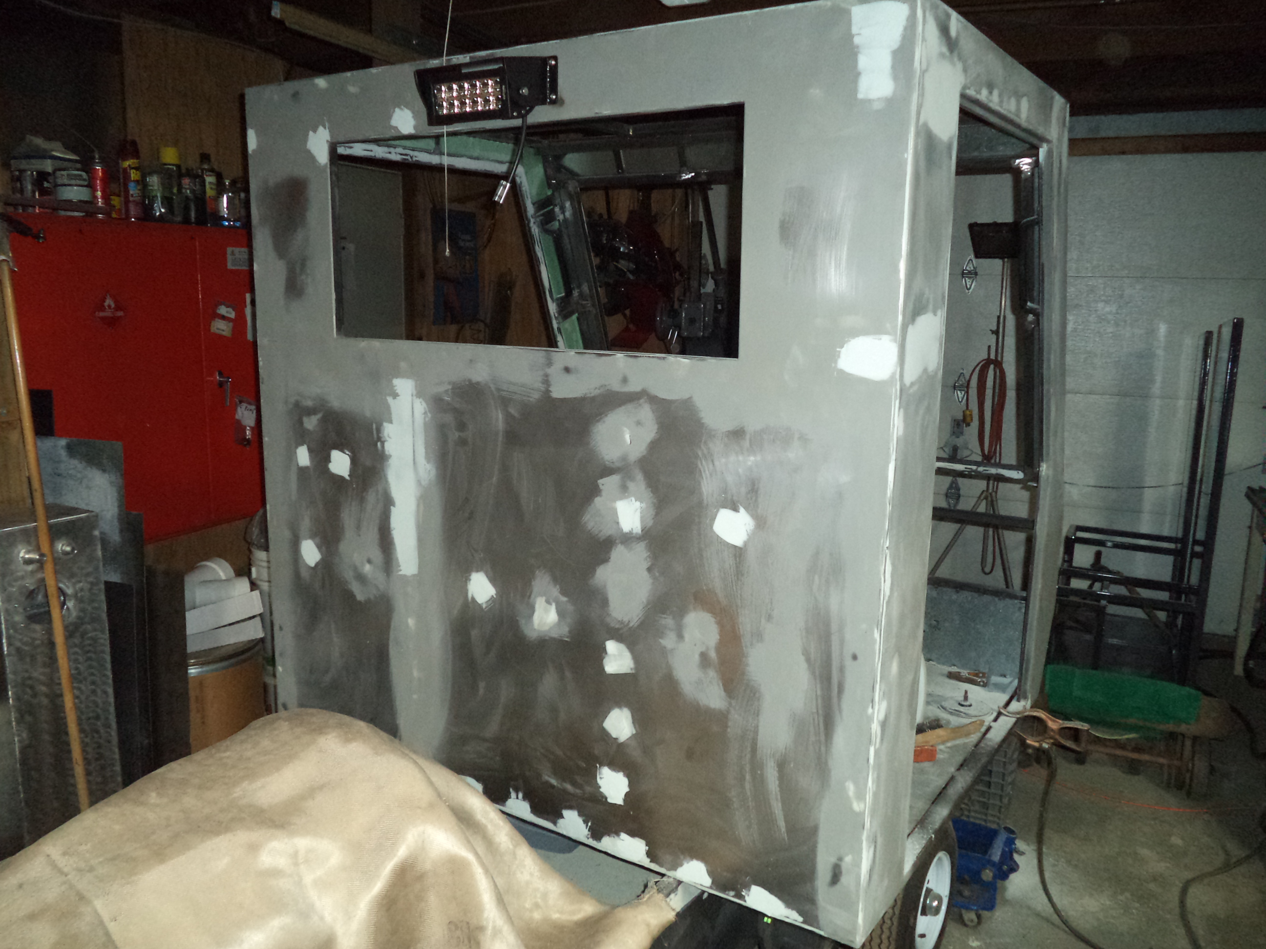

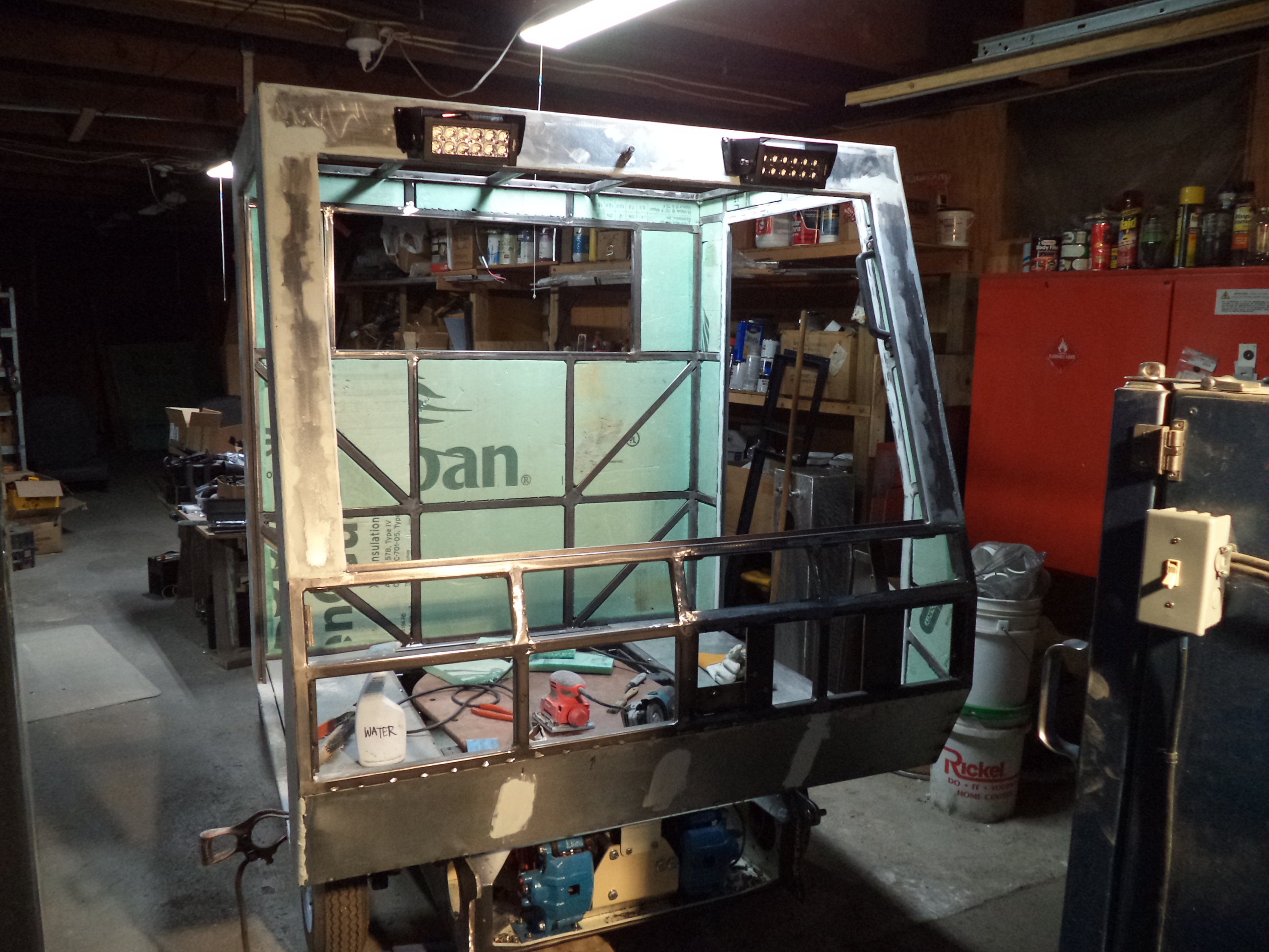

Even though yard work, the honey-do list and other tasks have eaten up a bunch of my prior free time, I have been able to get some more work done on the outer cab skins and front/rear driving lights. I also finalized a logo design and plan to have some decals made up.

Cool progress, glad to see you moving along! I like the logo too.

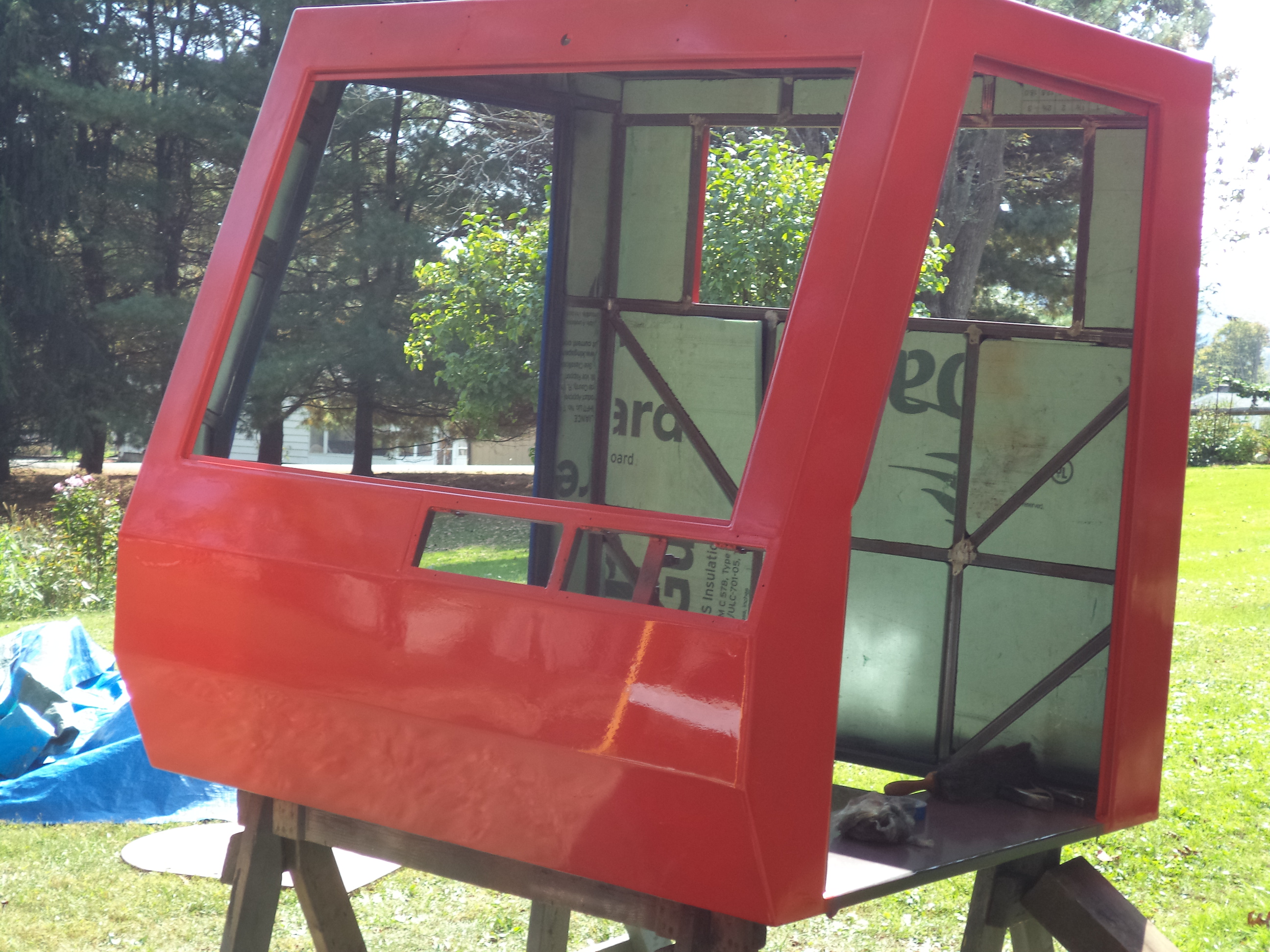

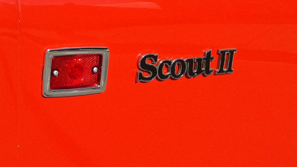

I've been making some progress on the cab. Today I cut up some .090 sheet for the roof using the plasma cutter and tacked it in place. Earlier this week I added the cab underside panels and final painted them. There's a chance I'll finish painting the cab exterior in International Harvester Flame Red later this week. I also recently received the windshield made from 1/4" laminated safety glass and test fitted it.

Looking forward to the first test run video!

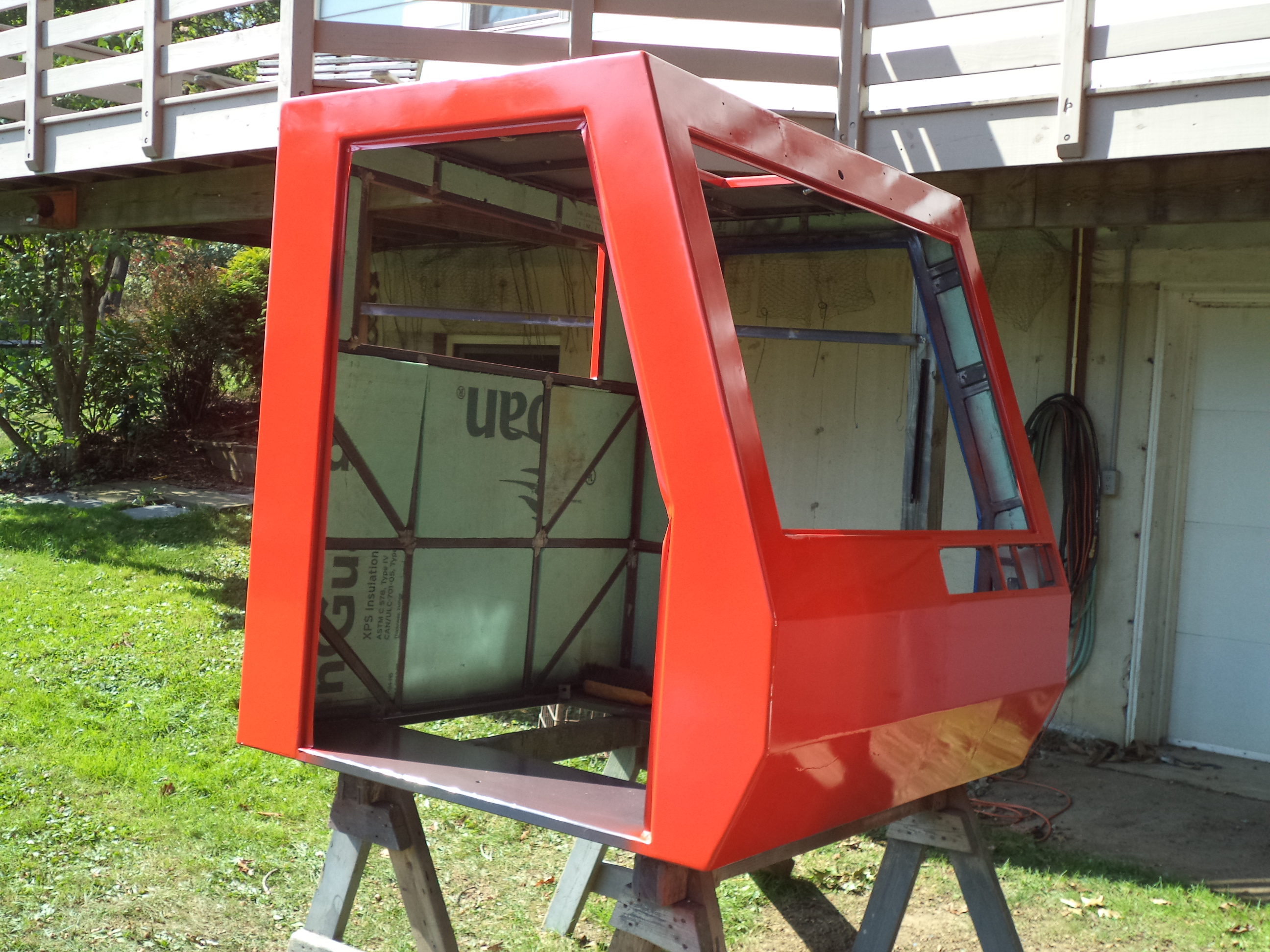

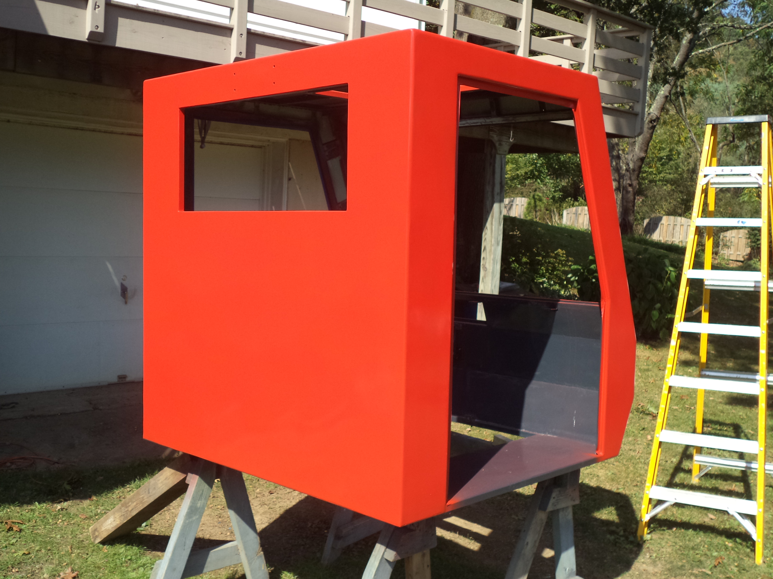

Progress on the cab continues. I painted the first coat on it today. I hope to add a clear coat tomorrow.

Progressing nicely! We finally got some decent weather to work outdoors in.
