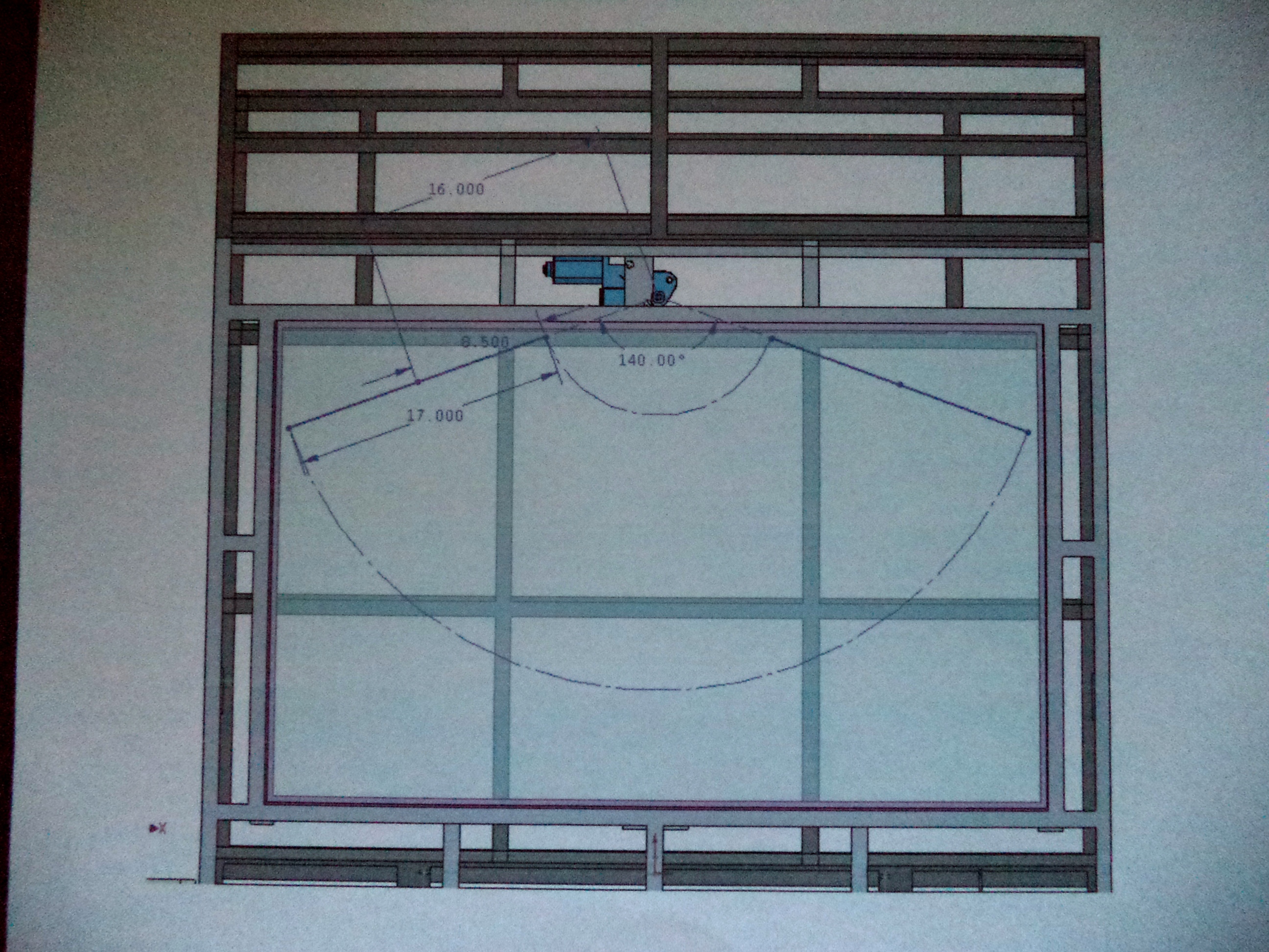

Not much exciting stuff to report but here goes: I finished the wiper design and welded in the bracket for the repurposed GM Blazer rear wiper motor. I had to extend the stock wiper arm by 1-1/2" to make it work per the attached image. I also welded in a bunch more cab frame members and started hanging sheet metal skins on the cargo and cab framing. I also finished up the design of a moon-roof I will be adding. The pop-up latch came from a mid-80s Toyota 4-Runner pickup. I designed some custom hinges which I will have 3D printed by a buddy of mine.
