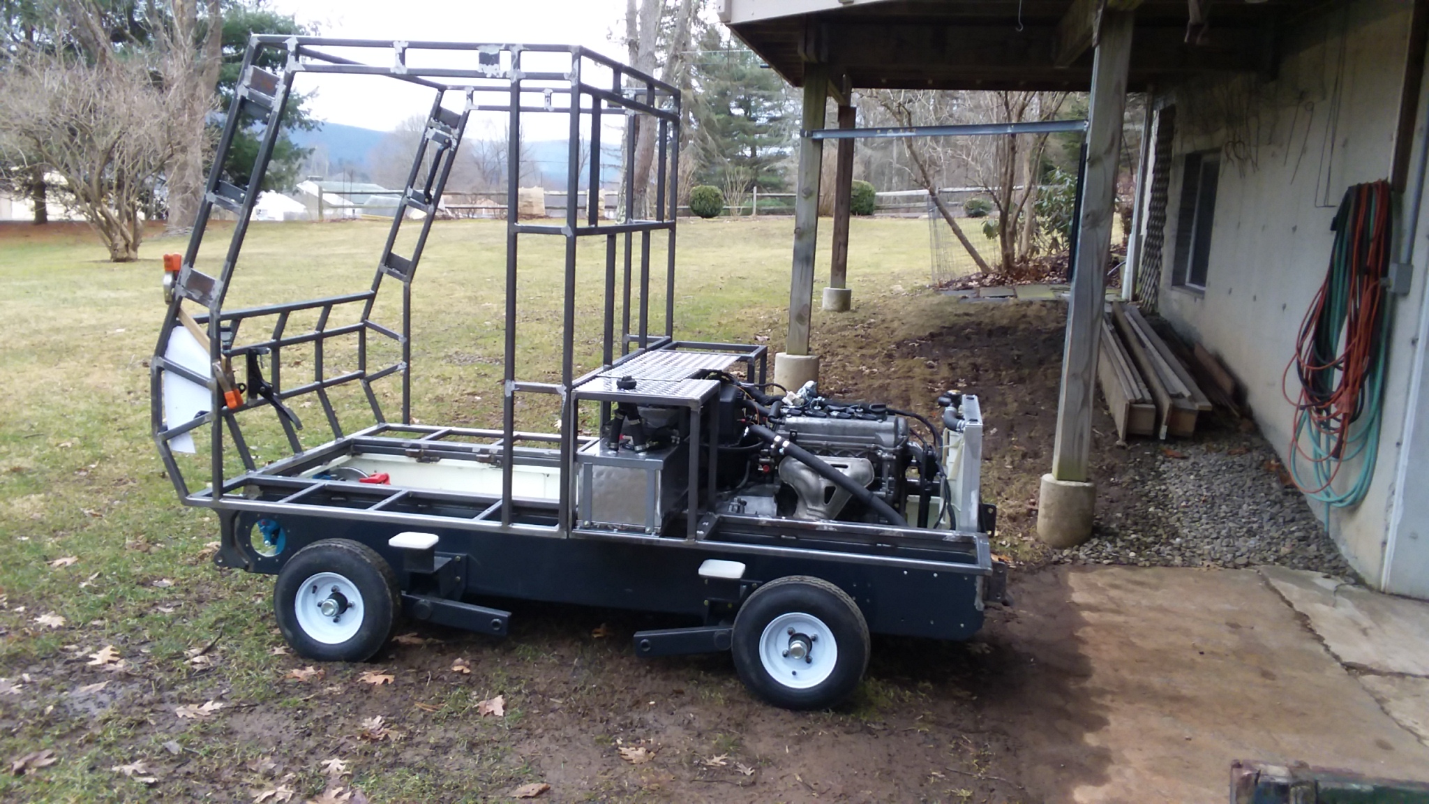

It is a nice day here in upstate NY so I rolled Snowzer out of the shop in an attempt to see if it would run. After putting a couple gallons in the fuel tank and a bit of cranking, viola - it actually ran! I moved the shifter arm through its paces and the axle CV housings moved appropriately. I do have a small atf drip leak that is probably located where I split the diff housing to I weld it up. This will need to be addressed at some point.
That picture looks like you need more triangulation across the back so it doesn't fold up if you roll over...

   / My Senior design project - a "Swamp Thing" tracked vehicle clone #174
I'd agree but without knowing what he's covering the cab with, it would be had to complain about his design. Seems most people use pretty light material for that.

I will add some X-bracing to the rear car wall - NBD. As far as wall covering, I've been turning this around in my brain for a while. I'm leaning towards Formica? :eek: Just glue it on and it's relatively cheap / easy to replace if it got damaged. Your thoughts?

I'd go with 1/8 black abs that's rough or textured on one side and smooth on its other. ABS can be glued but for your cab, I don't see any reason to need that. HDPE is a tougher materiel but doesn't like to be glued. Formica is good for something, but I sure wouldn't use it on a cab.

I like the idea of a flexible plastic too. IIRC, Formica breaks up into shards.

Did you plan to pop rivet whatever siding on?
Not if I can help it. I plan to use glue or double-sided mounting tape for plastic siding and plug welds for metal.

Double-sided tape won't go it. Why not do something like pop-rivets?
