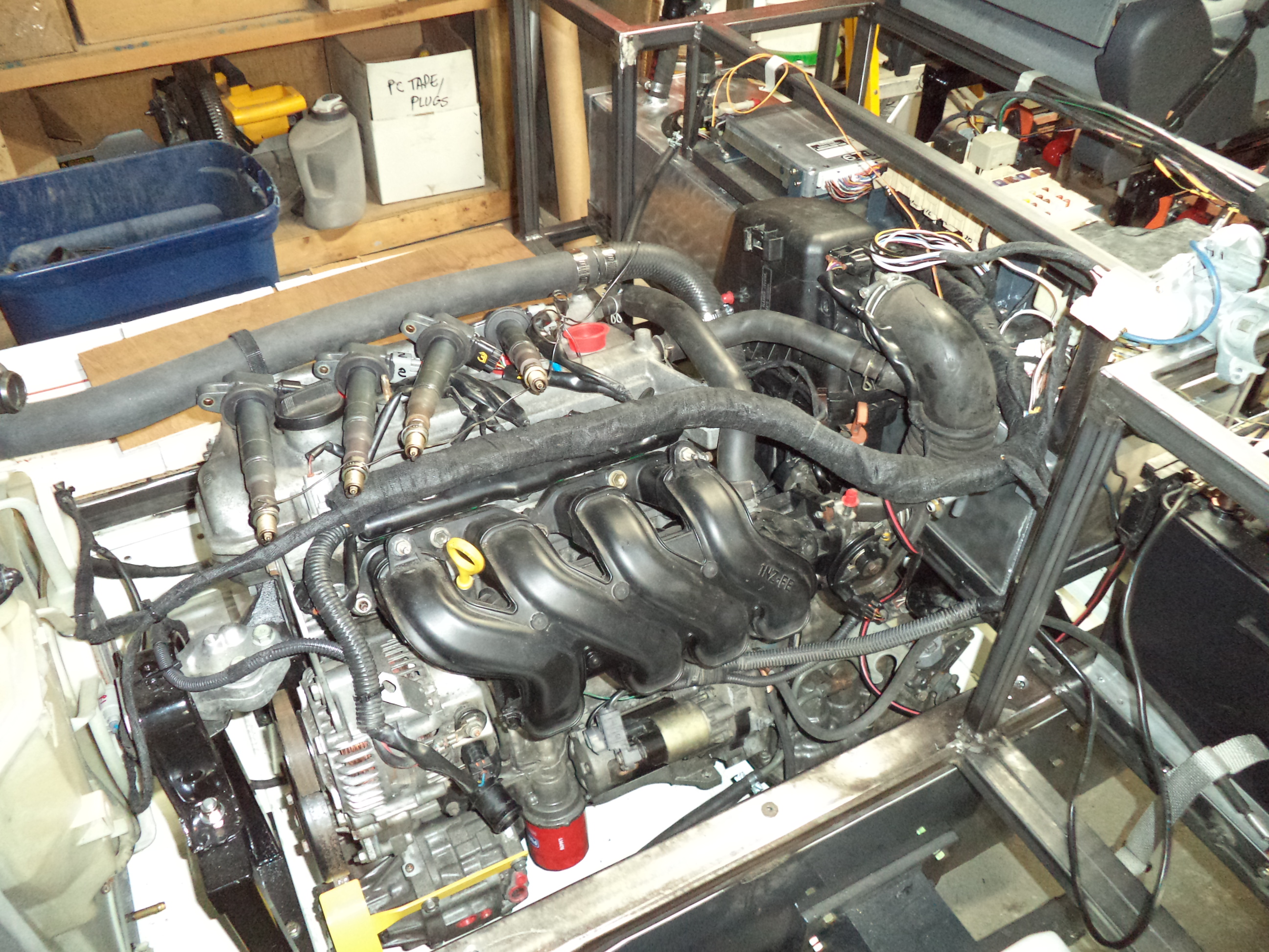

I've been working on simplifying the wiring harness by pulling connector pins/sockets. I finally got the knack of popping the latch holding the pin/socket in the housing. My cheap set of eyeglass screwdrivers work better than the $11 set of EBay connector tools I bought.

After a few days of hacking and chopping wires I got the engine harness whittled down to where it cranks, sparks and the fuel pump runs all without blowing a fuse nor causing any conflagration (fire). Once it warms up a bit, I plan to roll the chassis outside, add some gas to the tank and see if it runs. :thumbsup:

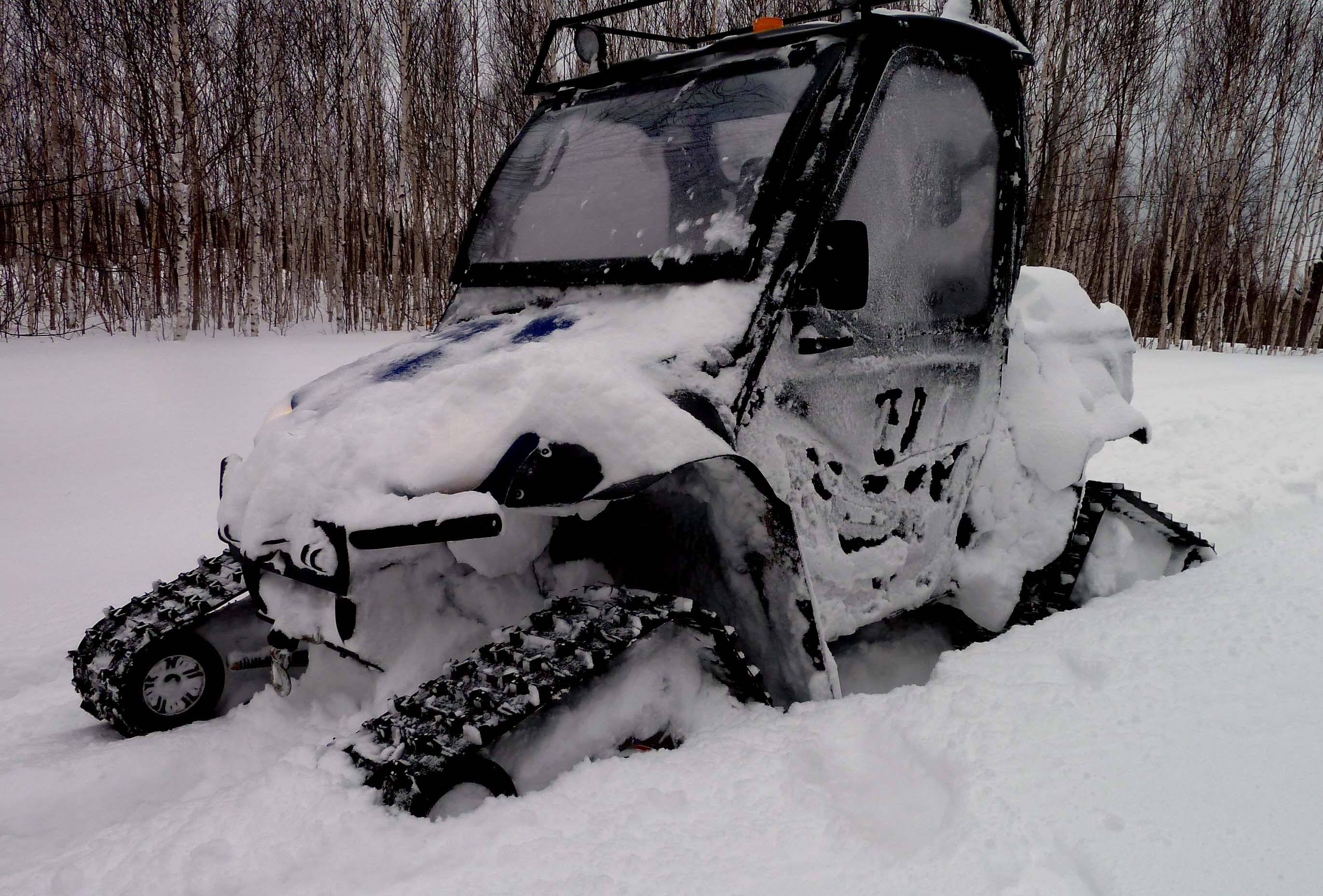

   / My Senior design project - a "Swamp Thing" tracked vehicle clone #165

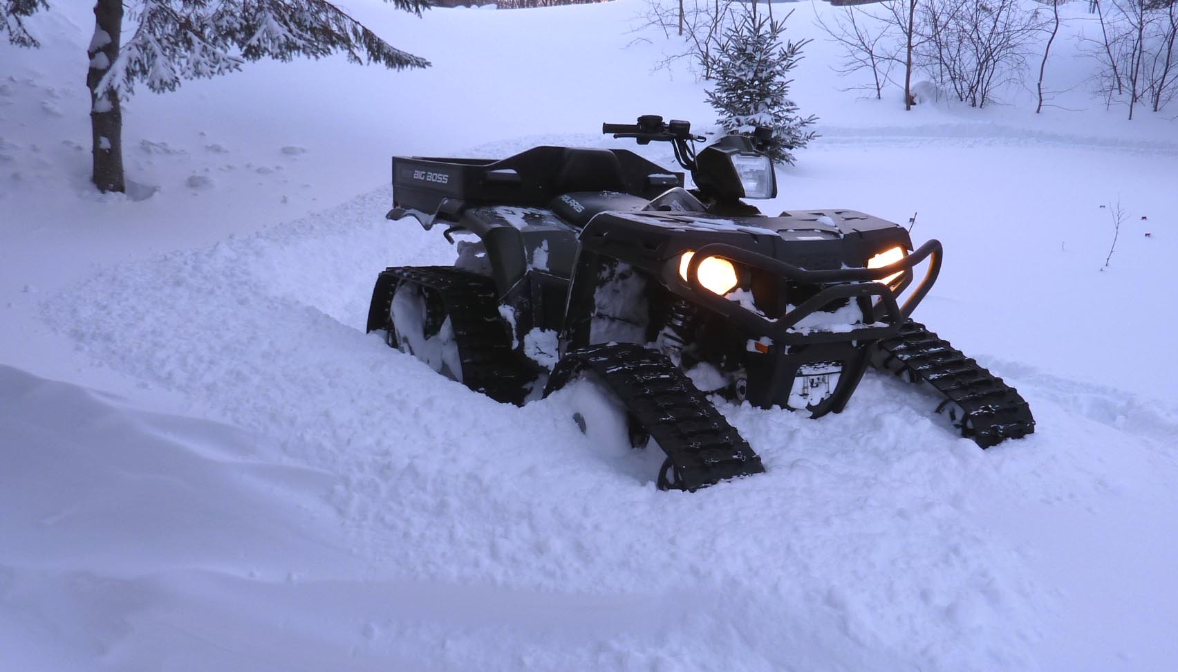

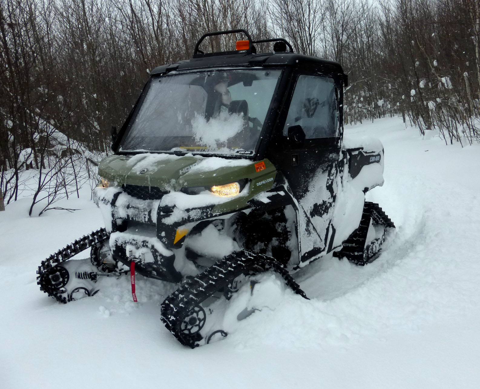

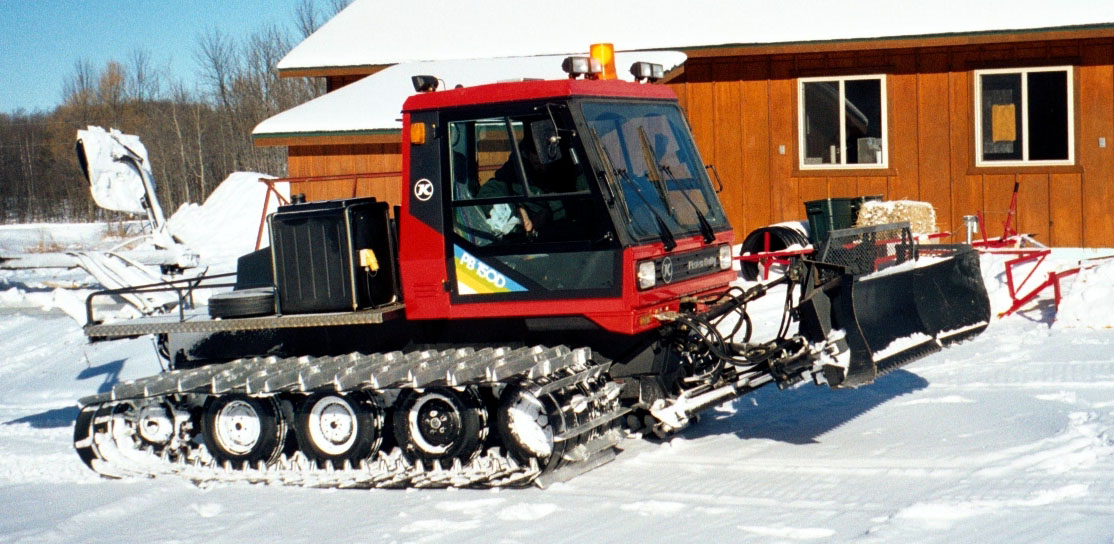

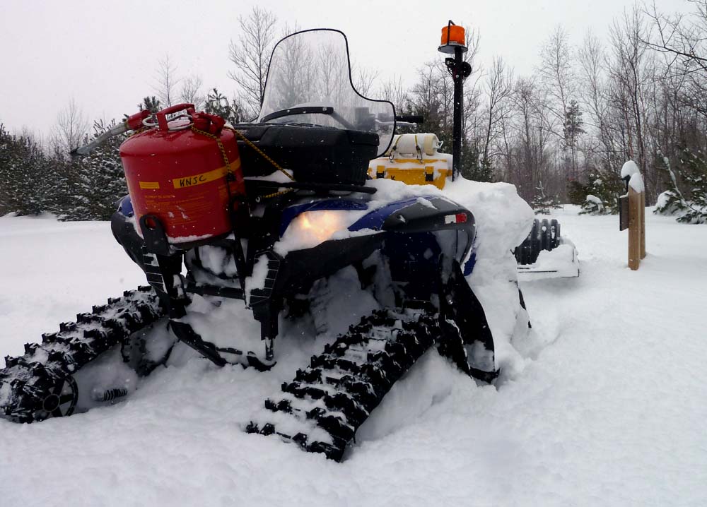

Here is some machines that I've operated over the years. Only the 6x6 is mine personally which is the last photo...

   / My Senior design project - a "Swamp Thing" tracked vehicle clone #166
I like the red one!
#167
I like the red one!
-> Me too! What hp and drive system does it have?
   / My Senior design project - a "Swamp Thing" tracked vehicle clone #168
Copied from PBullys web site. Its sure hard to copy and past here! In the below info you can see they a hydrostatic transmission. The new ones might have 5 or more pumps in them.
https://www.pistenbully.com/fileadm...d/Fahrzeuge/gebrauchte_pistenbully_en__1_.pdf
3PistenBully 100. The multi-talent.PistenBully 100
Model year:1999 – 2010from 2010Engine:Mercedes-Benz
OM 904 LA with elec-tronically controlled fuel injection system (EUROMOT 3A, EPA TIER 3)
Mercedes-Benz OM 924 LA with elec-tronically controlled fuel injection system (EUROMOT 3A, EPA TIER 3)
Cubic capacity:4,250 cm34,820 cm3Power output (ECE):129 kW (176 hp)145 kW (197 hp)
Max. torque:675 Nm at 1,200 – 1,500 rpm705 Nm at 1,200 – 1,600 rpmFuel consumption:from 8.5 l/h
Fuel tank capacity:150 lWidth over tracks:2,500 / 2,740 / 3,100 mm
Width over tiller:from 3,100 mmHeight when driver's cabin tilted:3,020 mmGround clearance:approx. 320 mm
Load area:1,620 x 1,920 mm Tare weight:from 3,600 kg depending on the tracks
Gross weight limit incl. attachments:5,200 kgPayload on platform:1,000 kgSpeed, infinitely variable:0 – 25 km/h
Spec. ground pressure:from 0.051 kg/cm2 depending on the tracksGround coverage with tiller:37,500 m2/h
Brakes:No mechanical wear using hydrostatic transmission. Two multi-disc parking brakes.
Attachments front:Quick change system with All-Way-Blade

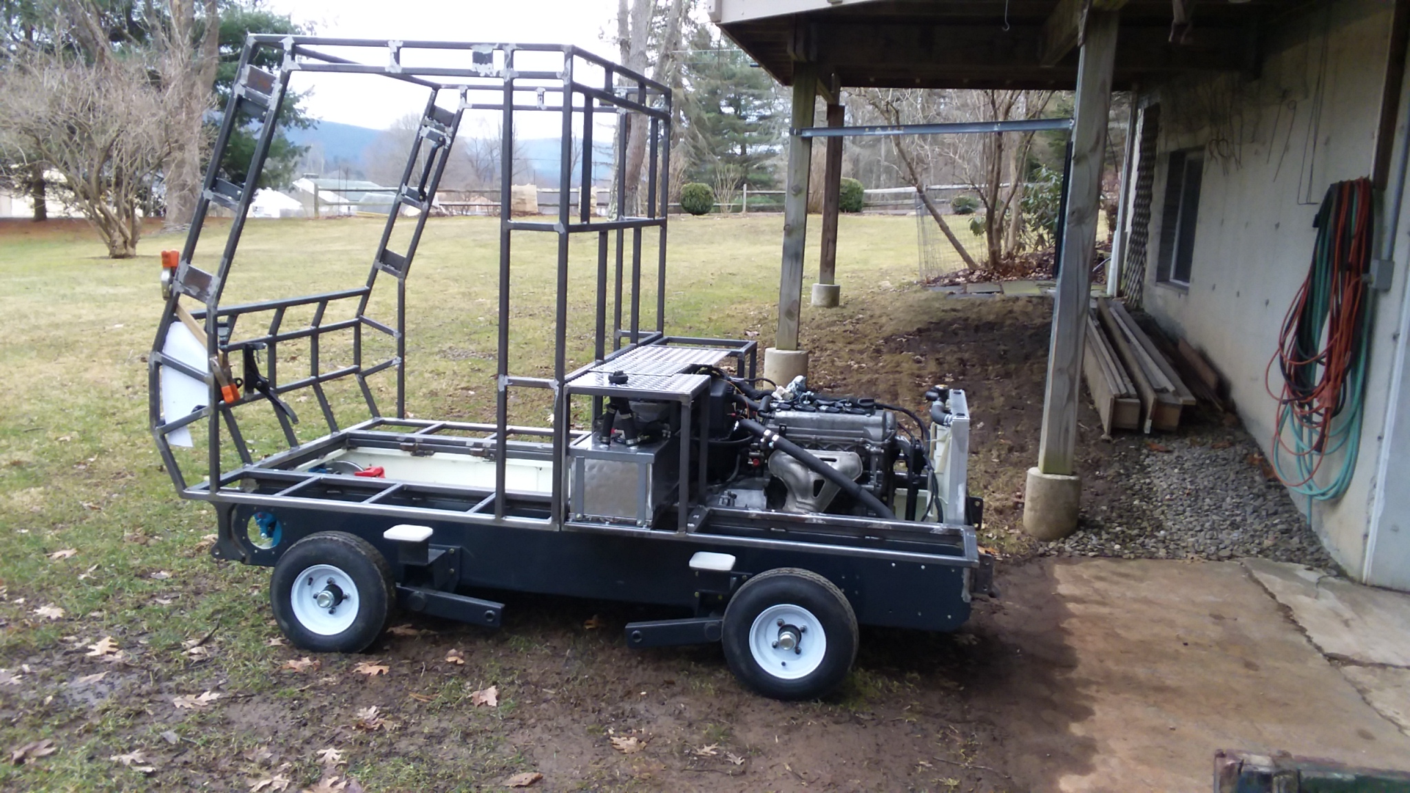

It is a nice day here in upstate NY so I rolled Snowzer out of the shop in an attempt to see if it would run. After putting a couple gallons in the fuel tank and a bit of cranking, viola - it actually ran! :thumbsup: I moved the shifter arm through its paces and the axle CV housings moved appropriately. I do have a small atf drip leak that is probably located where I split the diff housing to I weld it up. This will need to be addressed at some point.
