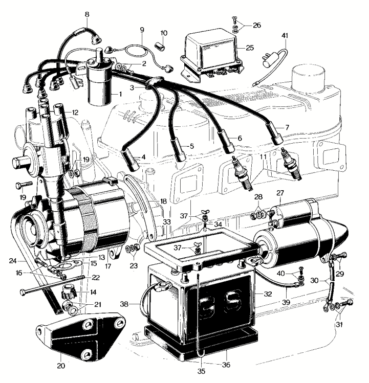

Here is the electrical schematics for both machines.
https://satoh-s650g.com/images/bison-schematics/wiring_diagram.jpg
A hot coil can be a few things.
- wrong spark plugs *
- wrong gaped spark plugs
- voltage regulator is messed up
- The center wire from the distributor to the coil is aged or bad inside.
- Alternator to the ignition switch to coil has a short
- Bad Point gap or bad points
- Bad Condenser = Replace Condenser
* Spark Plug: Check spark plugs to see if they need to be cleaned.
Check gap to make sure electrodes are 0.030in (0.8mm).
If the spark plugs are worn, replace (Recommended plug: NGK B6E or equivalent).
The Point Gap is 0.017 to 0.018.

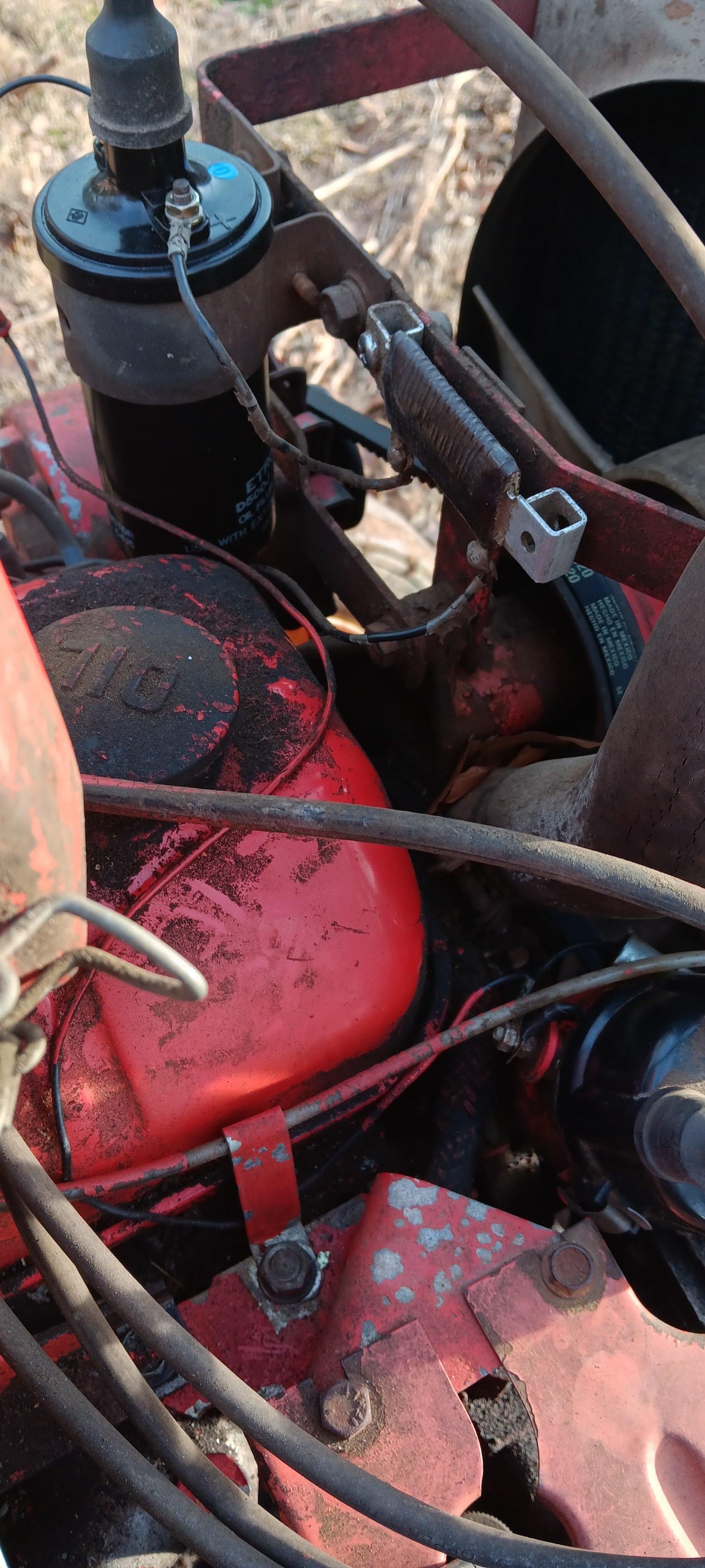

This is the ballast resistor installed on this tractor. I do not recall ever seeing one like this, but it worked for a long time. One side is connected to the + side of the coil and the other lead drops to the alternator and connects into the charging wire going back to the positive terminal of the battery.
   / My Satoh ohh Satoh #13
WOW :eek::eek::eek:
Mitsubishi-Satoh machines having a coil with no ballast resistor would be 3 to 4 ohms.
IF you placed in a coil that is for NOT having an external ballast resistor, then that coil will get HOT with that odd looking resistor there.
If you used the correct ignition coil per the parts catalog, Satoh 0180030, or the Mazda 0710-18-100 with no external ballast resistor required.
So yeah, your ignition system is jacked up.
