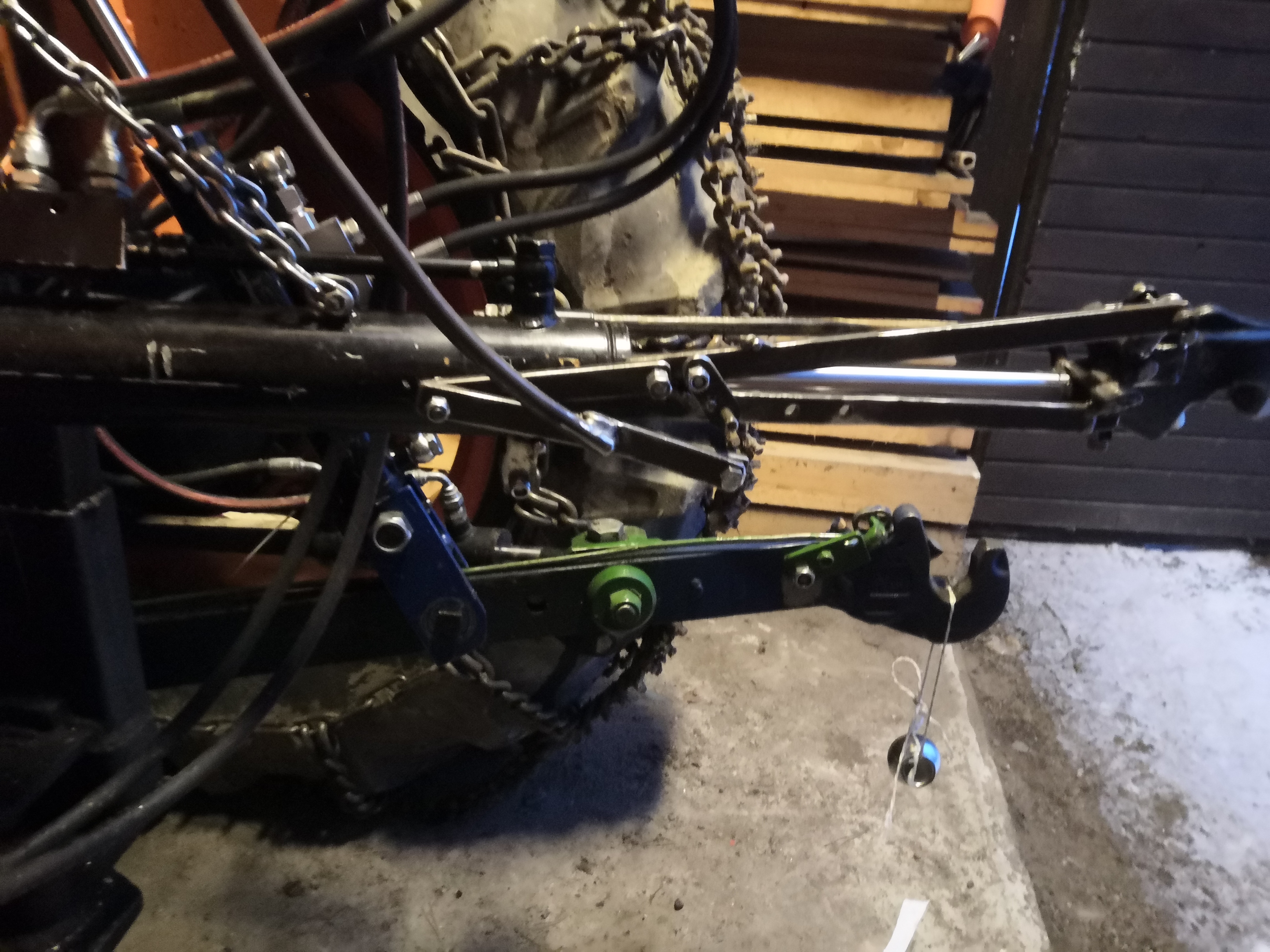

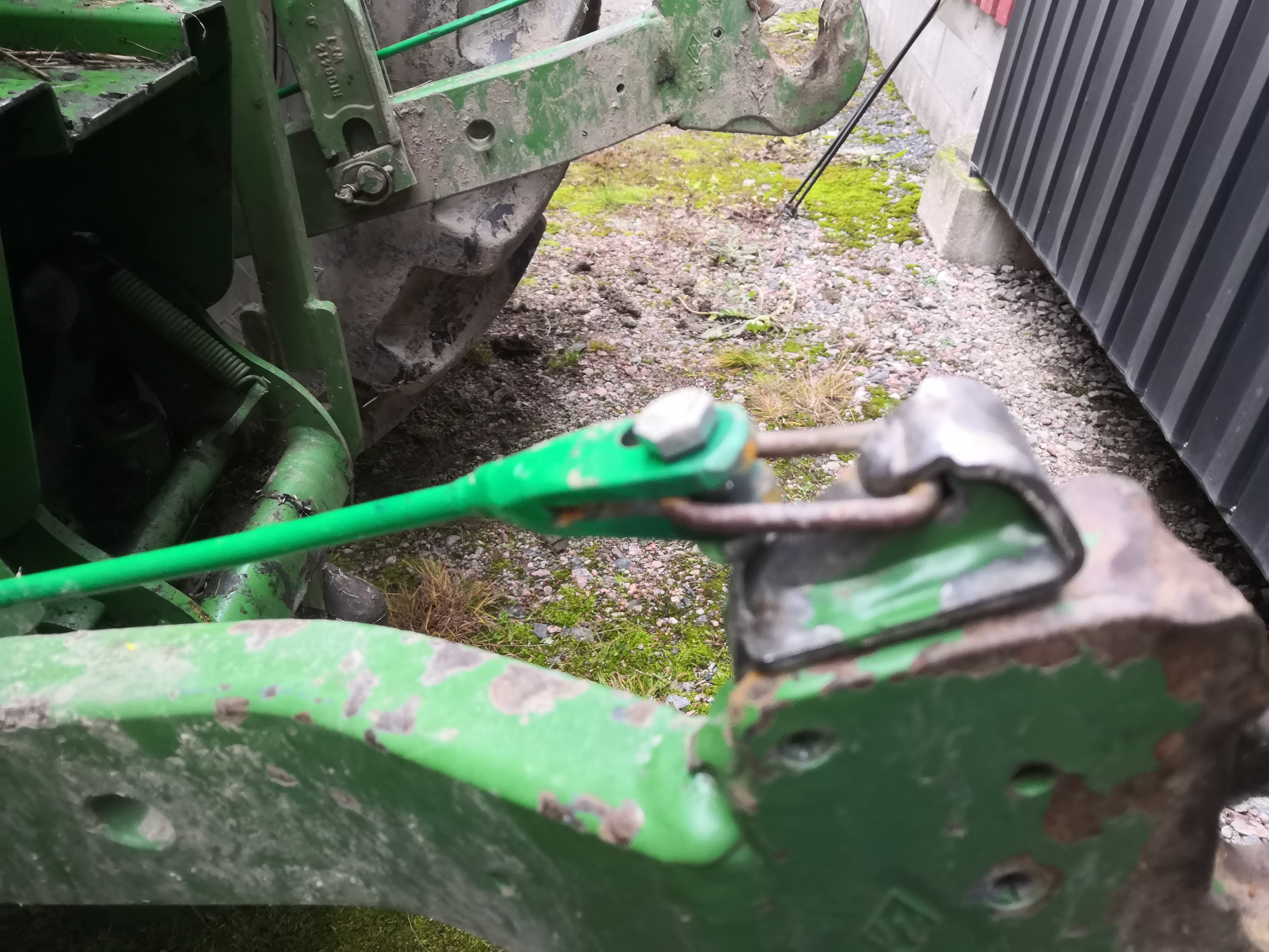

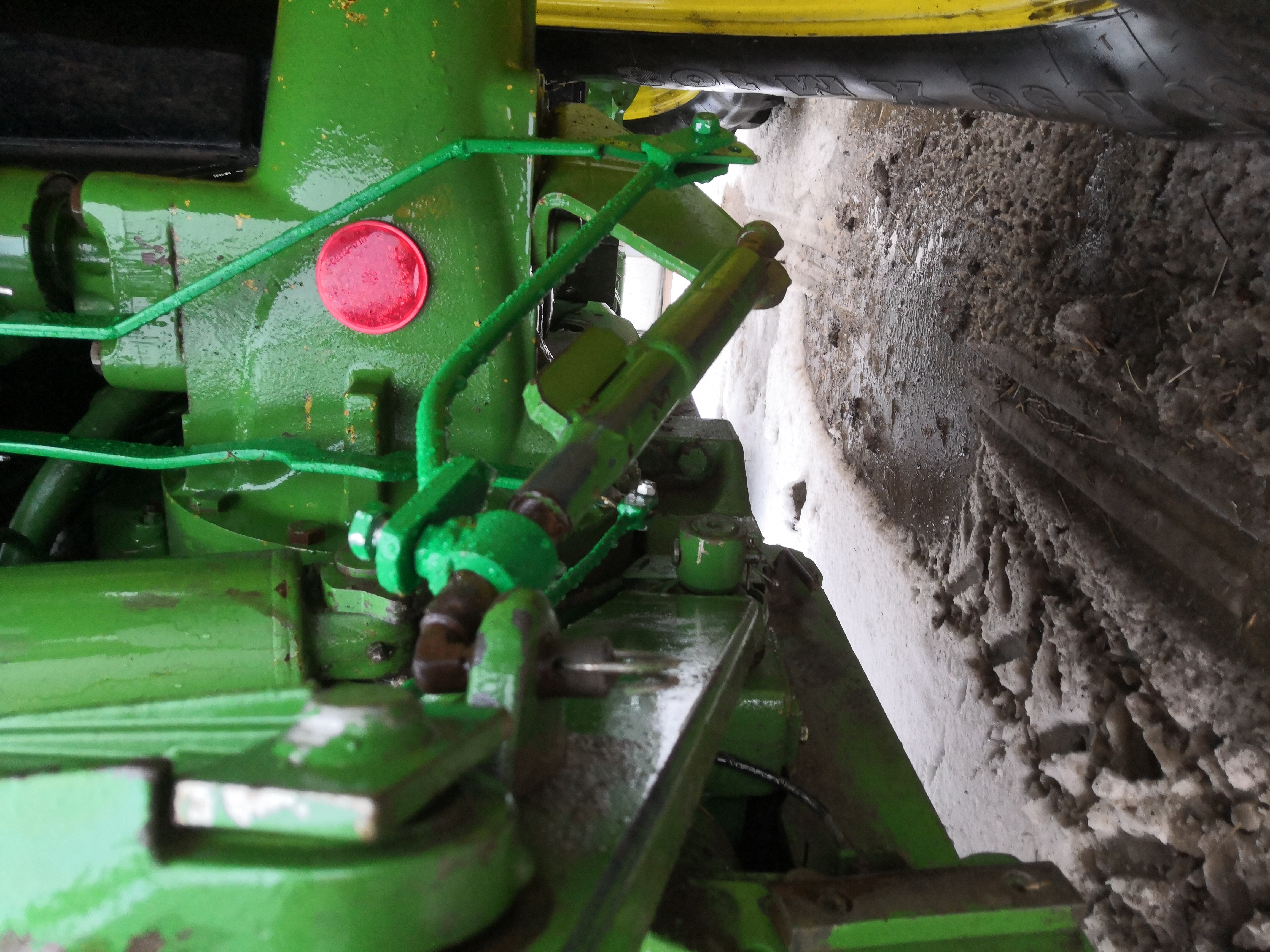

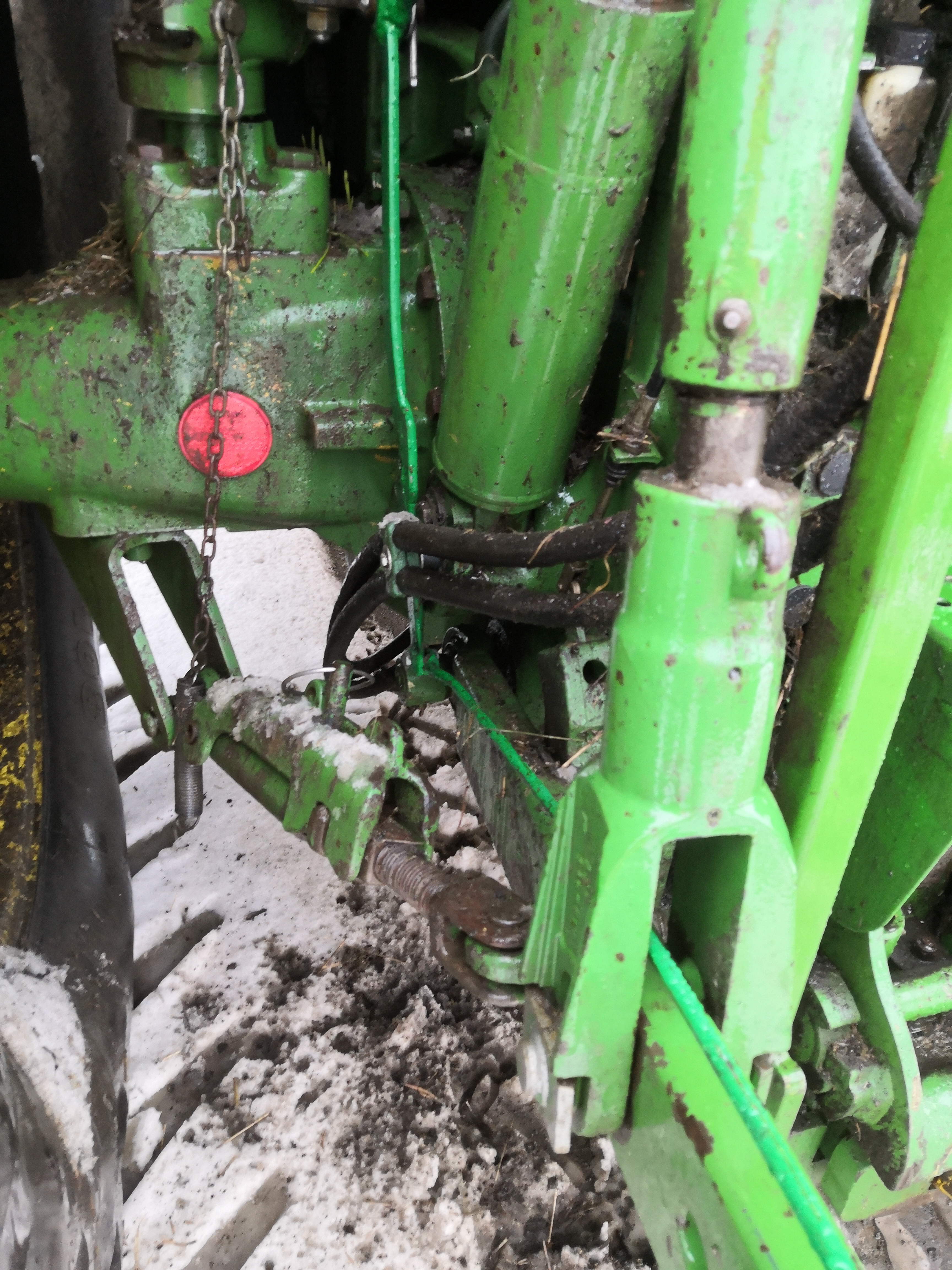

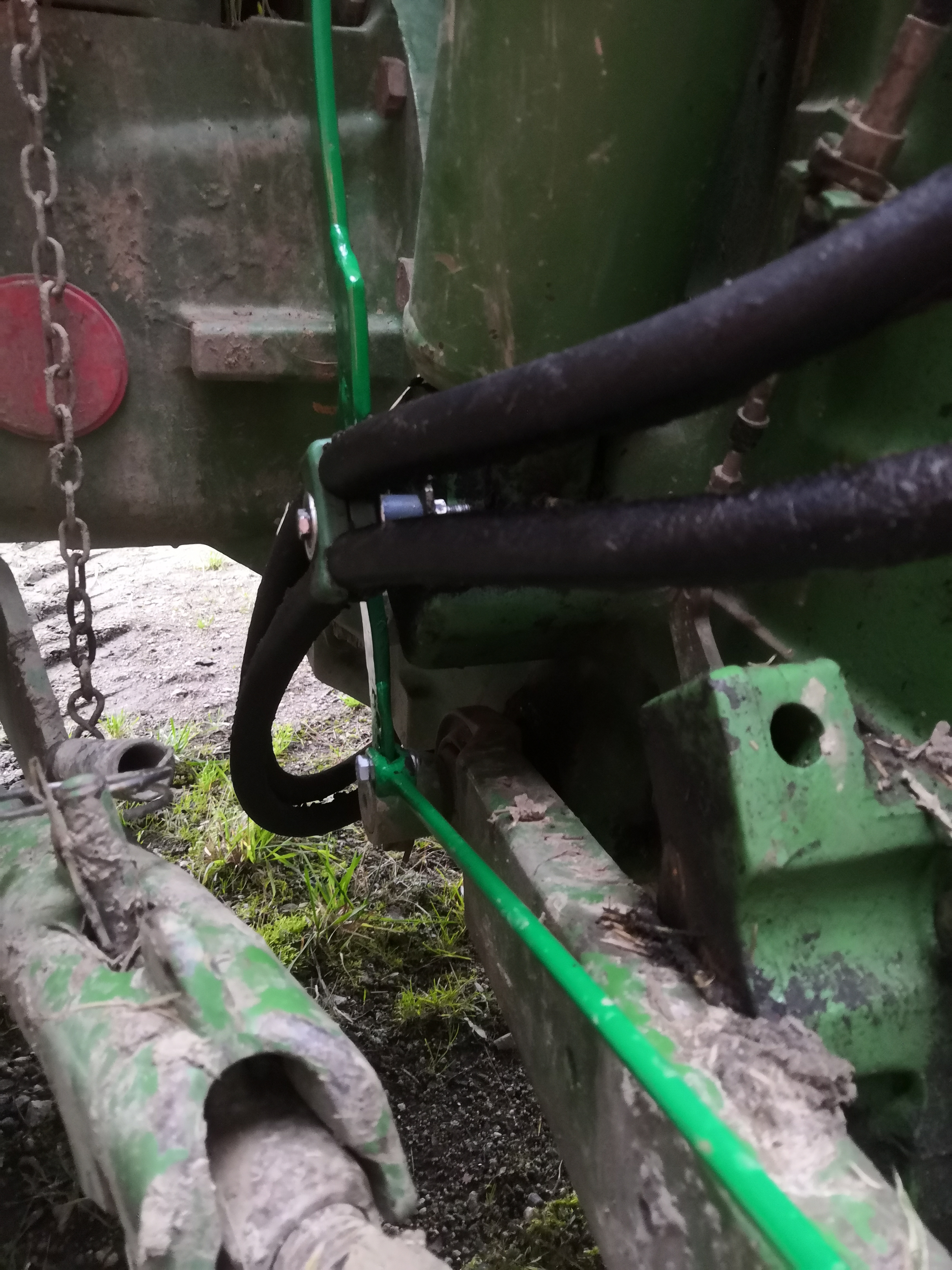

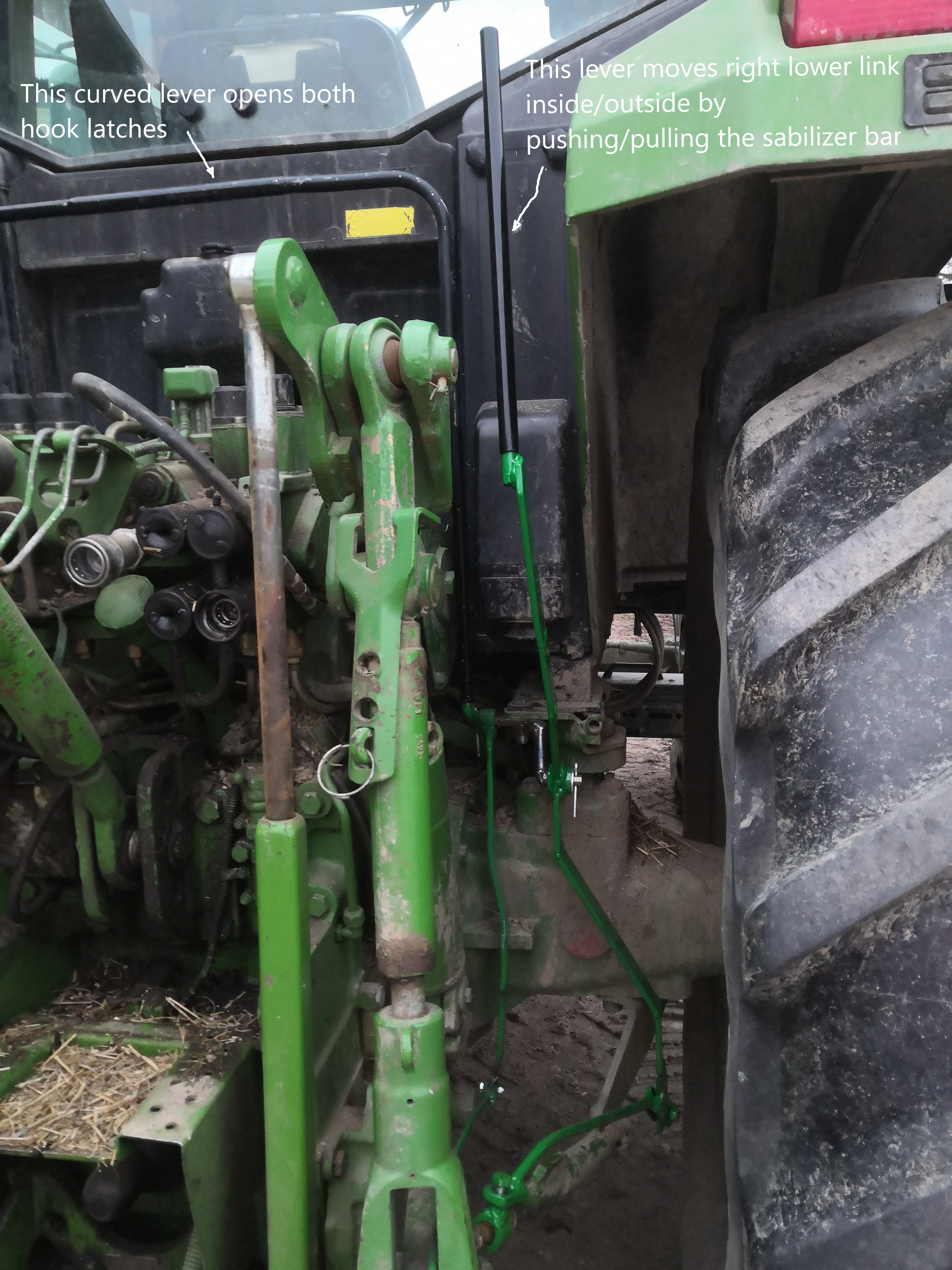

New pictures of moving the stabilizer bar from the cabin when hitching the implement.
There is a new lever and linkage for the right spring loaded stabilizer bar and the lower link.
Left side locked stabilizer bar and hook latch opening rod.
This is my last video I have. Winter game to us. Hope getting better soon.
Tractor Quick Hooks - YouTube
Markus :tractor:

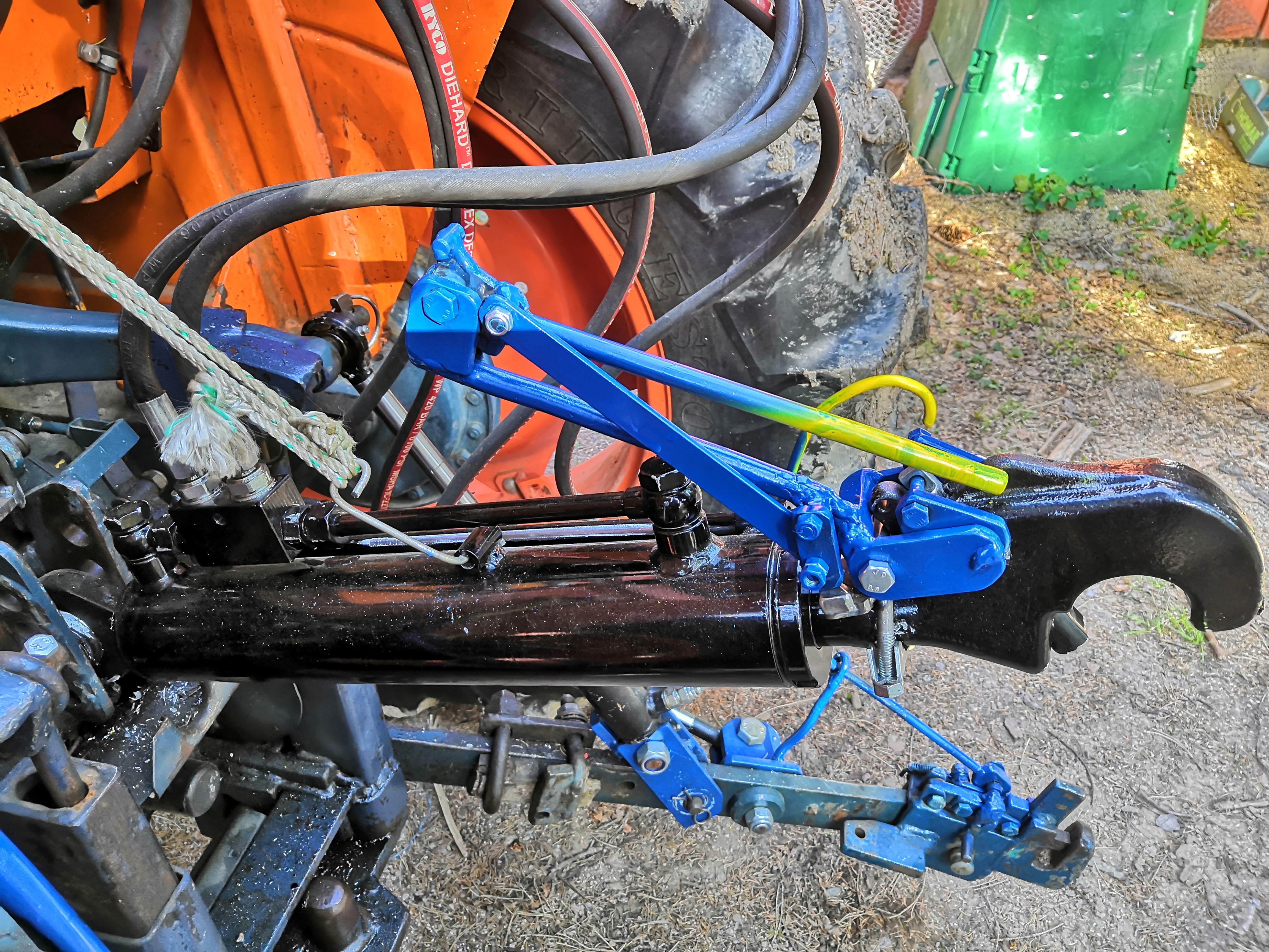

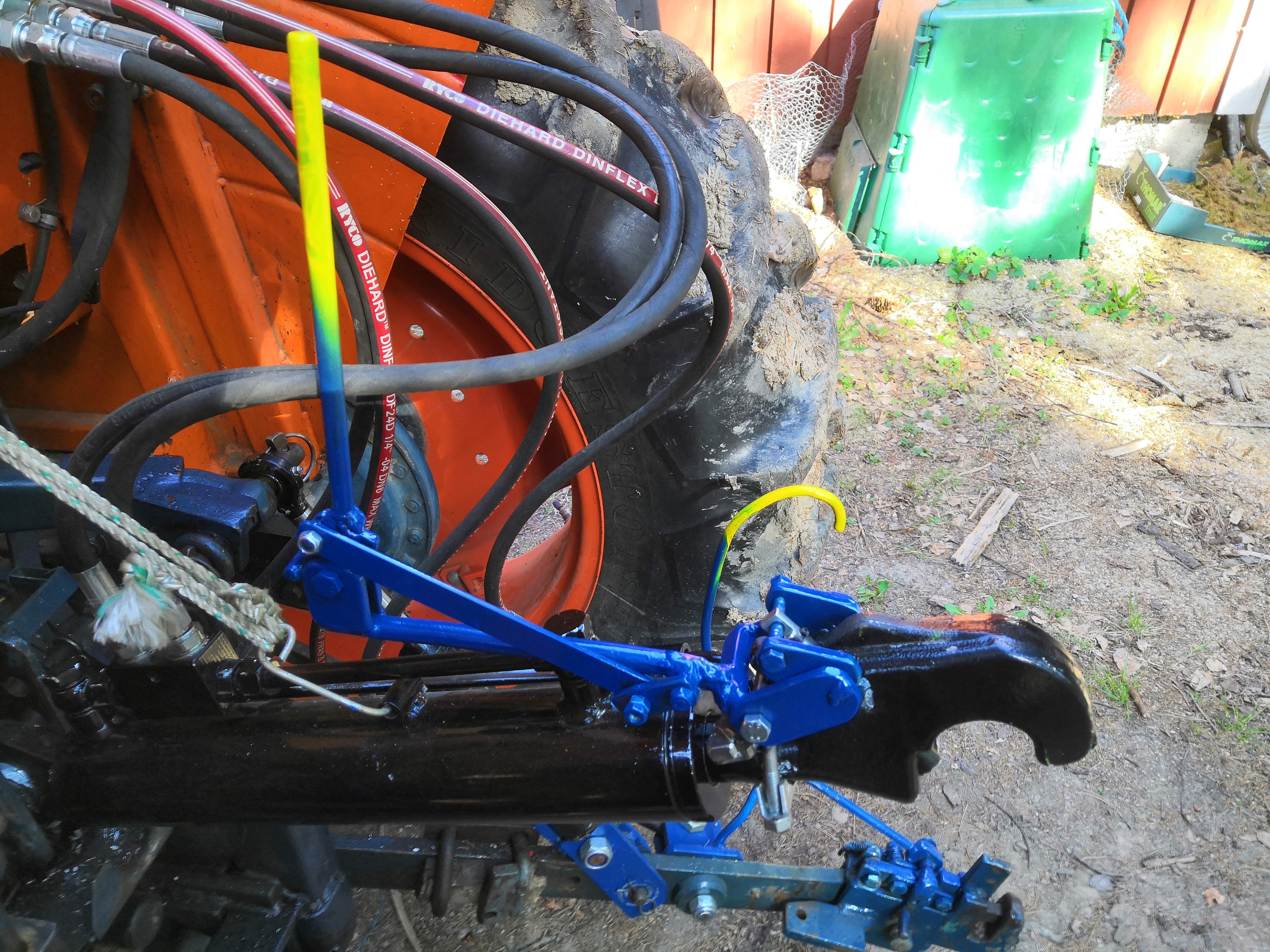

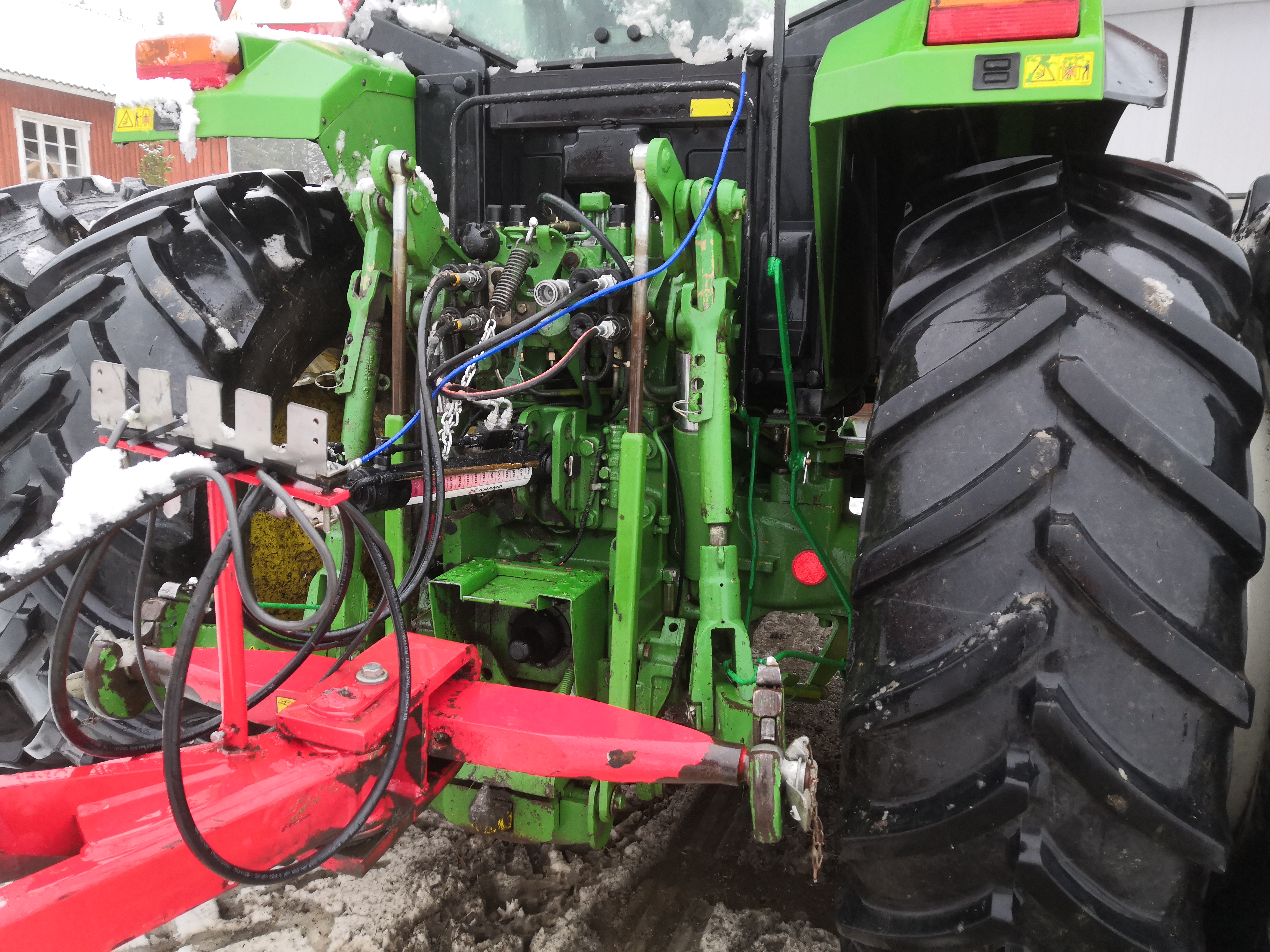

I made a new Top link for big tractors.
There is no ropes but a lever and links.
You can use it from the cabin.
I do not have JD now so I have to use my small Kubota as model.
For small tractors next is very good.
Markus
