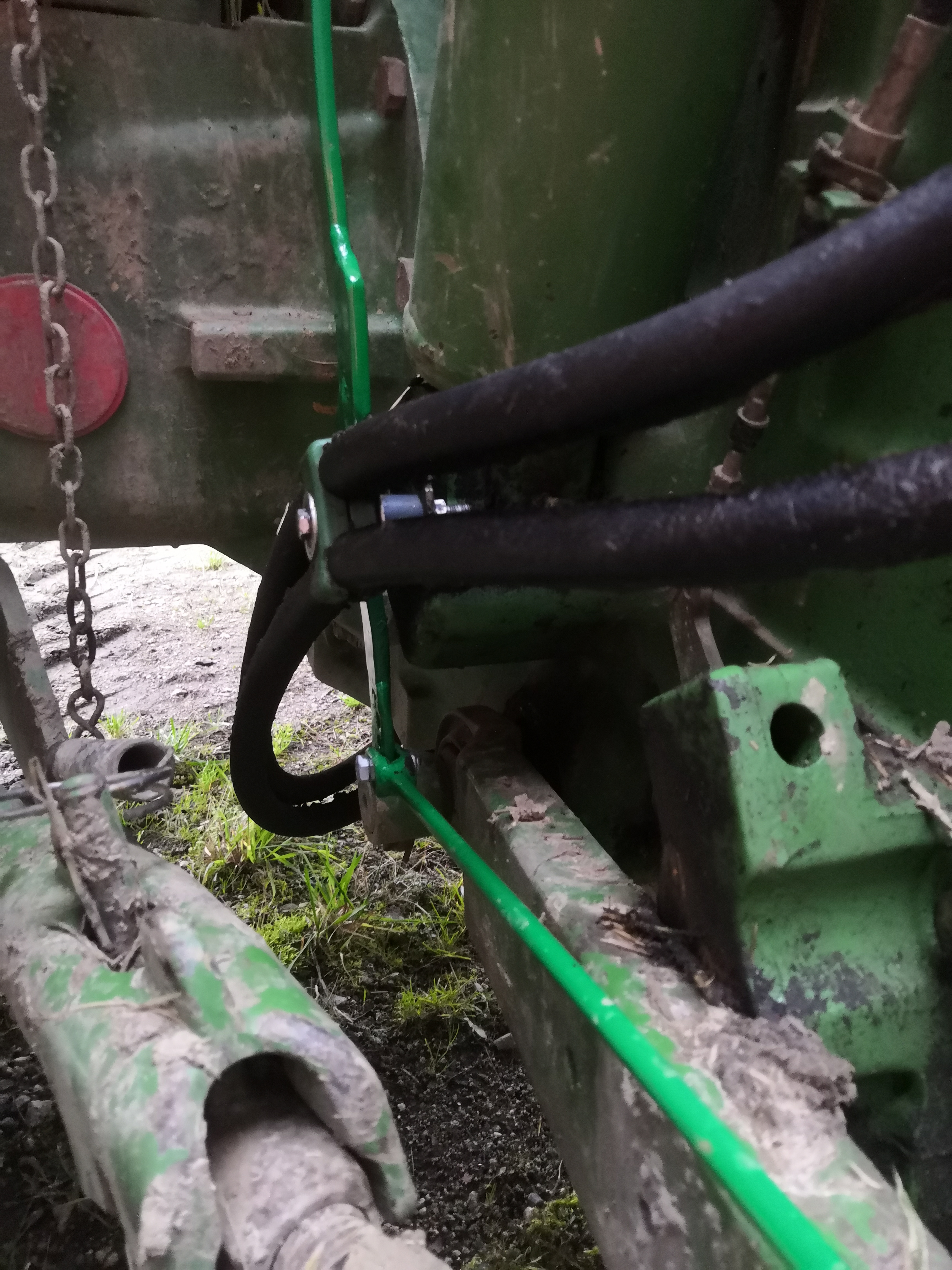

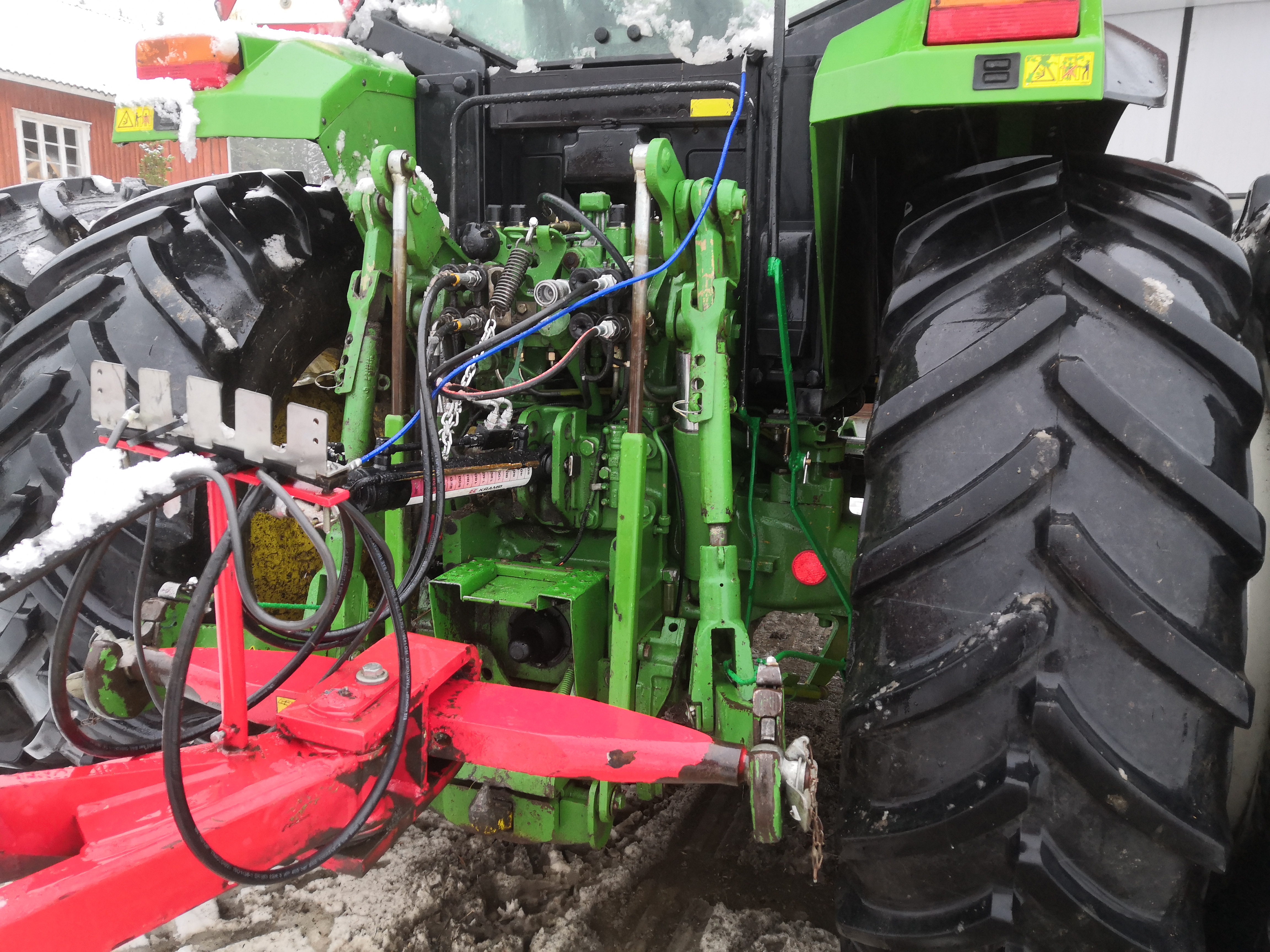

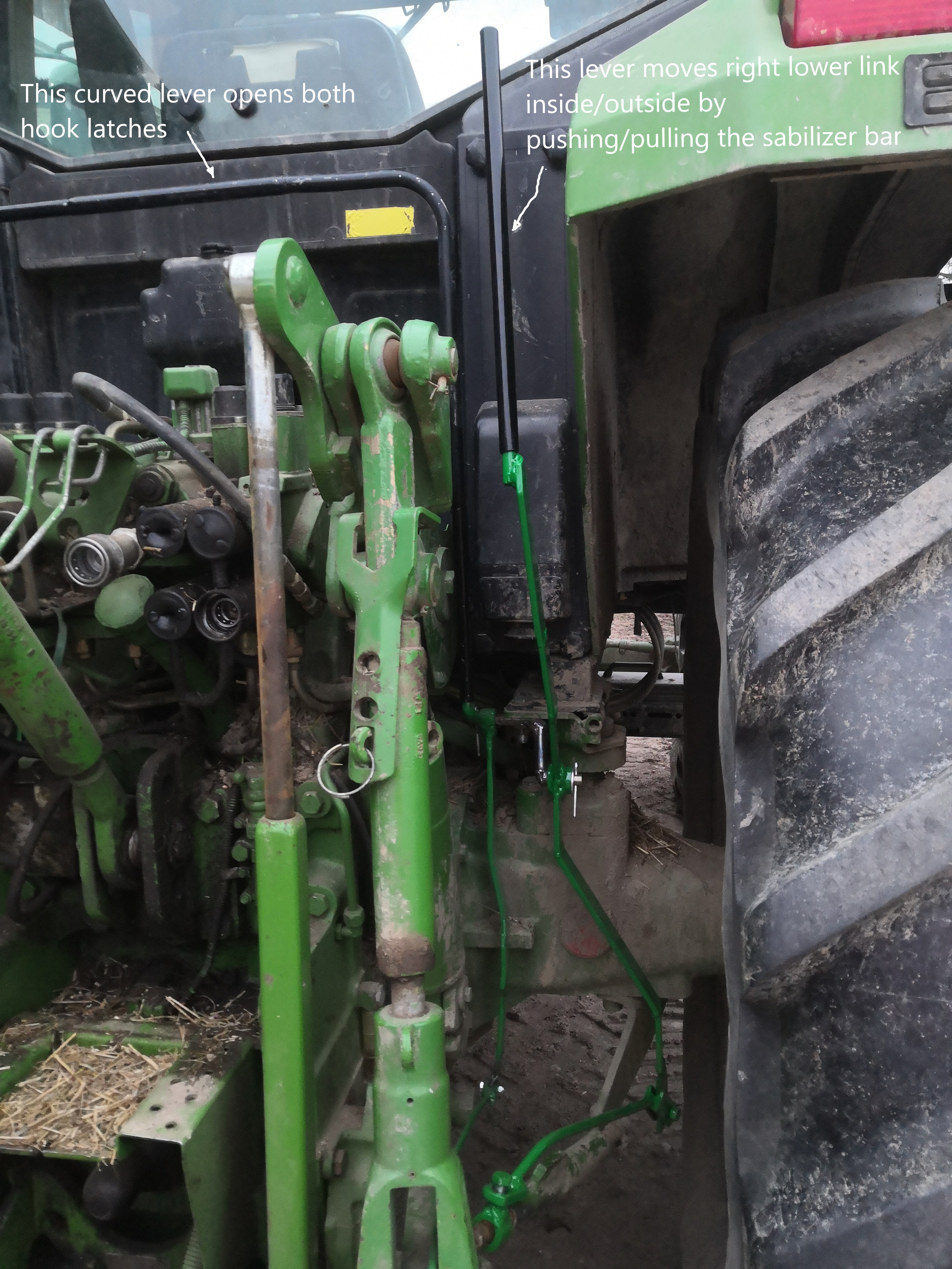

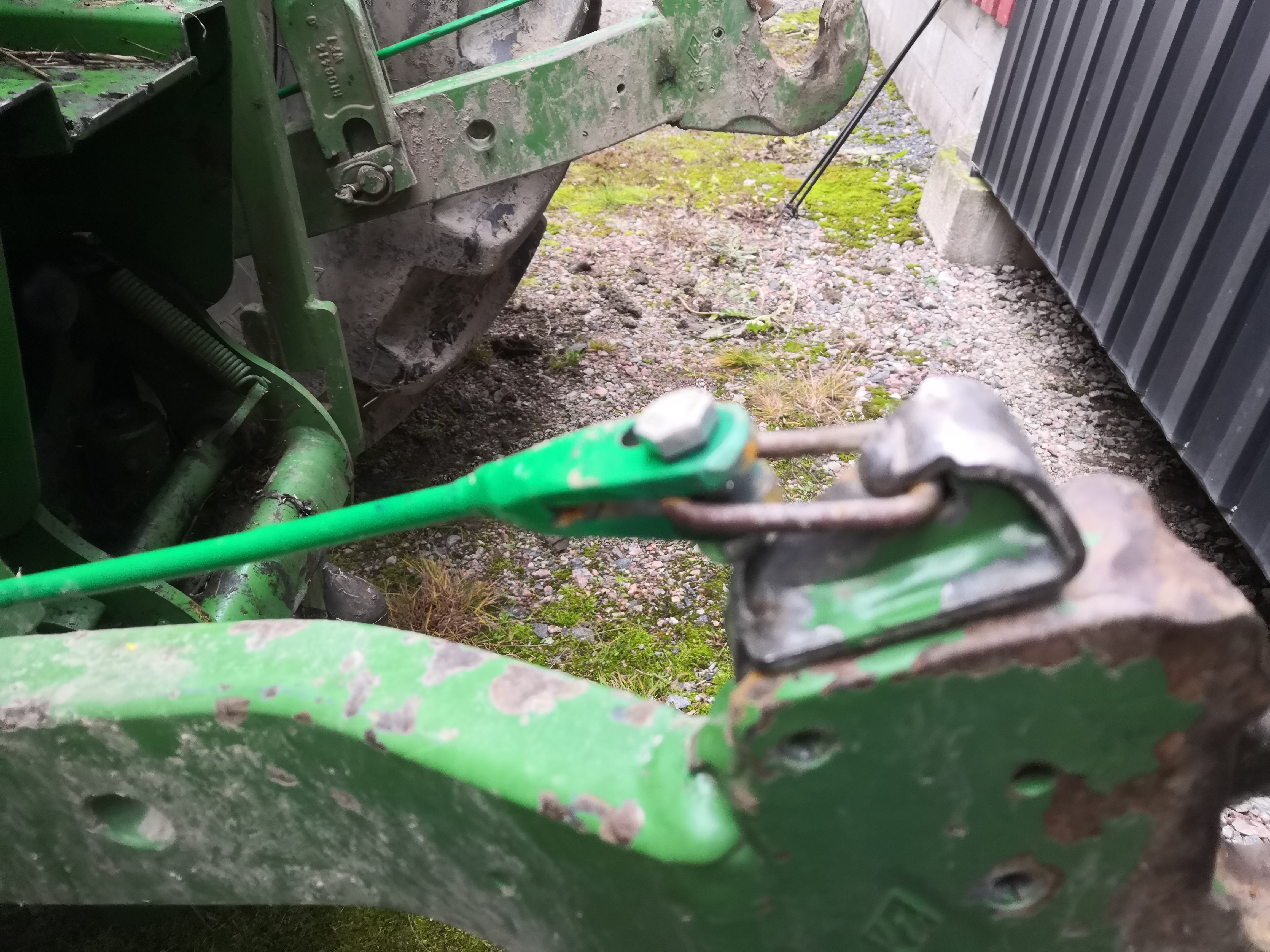

My next trial was to make lower links with quick couplers . Like Pad's or Walterscheid
To move the lower link from cabin I made this kind of stabilizer bar and lever to leveling bar.
Lower handle opens stabilizer bar and moving upper handle left-right
moves lower link right-left to proper place for hitching.
Here the yellow handle is for opening/closing the coupler.
My couplers are home made but works ok.

You may like more EURO style quick couplers to lower links and to top link?
They are simple and cheap and do not need much hydraulic.
But there are some faults that I do not like.
a)They need guidance for lower links.
b)They have ropes for couplers. These are often broken or absent.
c Hydraulic top link is heavy
So people operates at the back of tractor.
I wanted working from cabin.
Lets try something new.
Quick Couplers for 3-point hitch - YouTube
I appreciate all Your posts and opinions.
Thanks Markus
