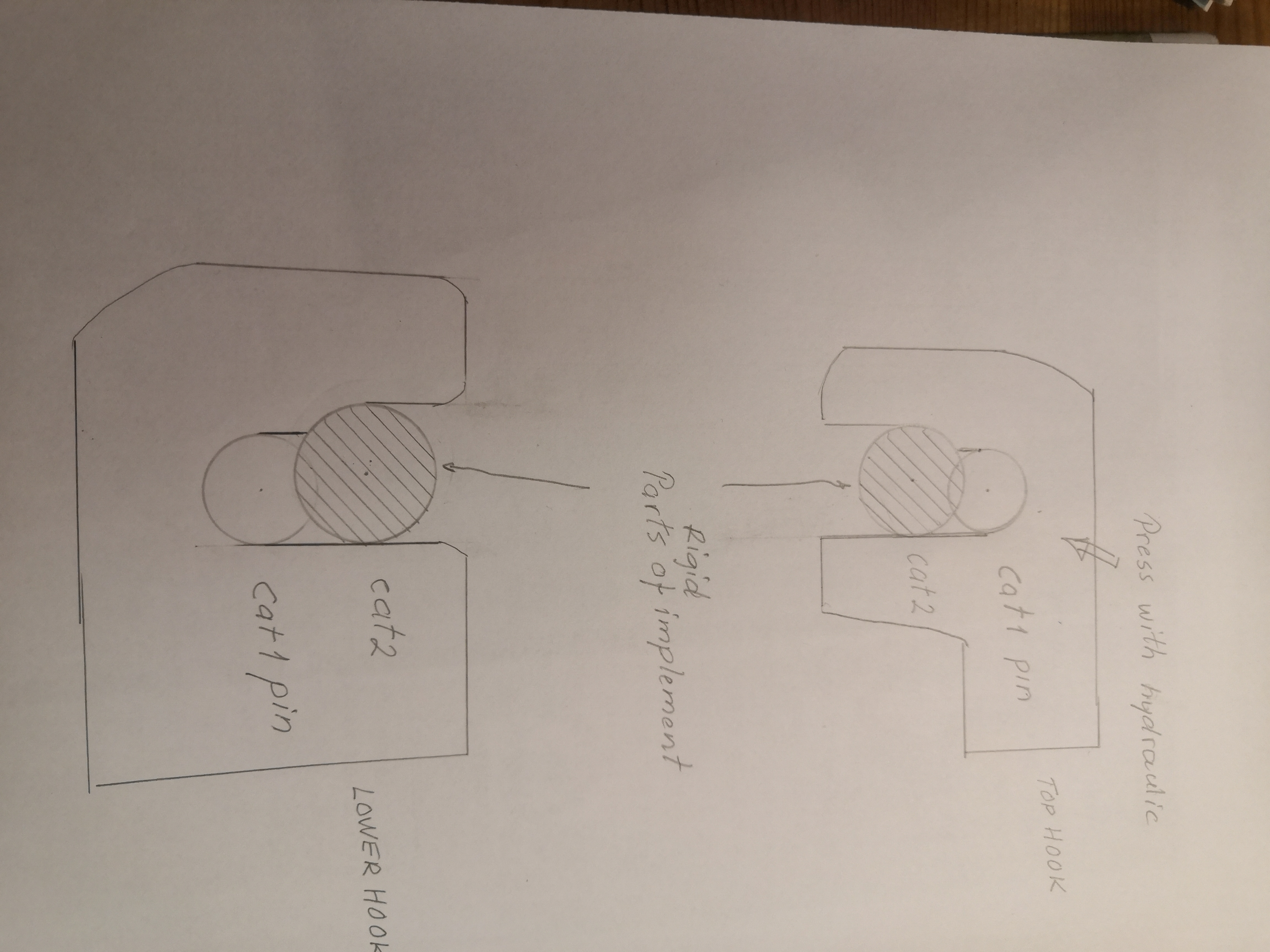

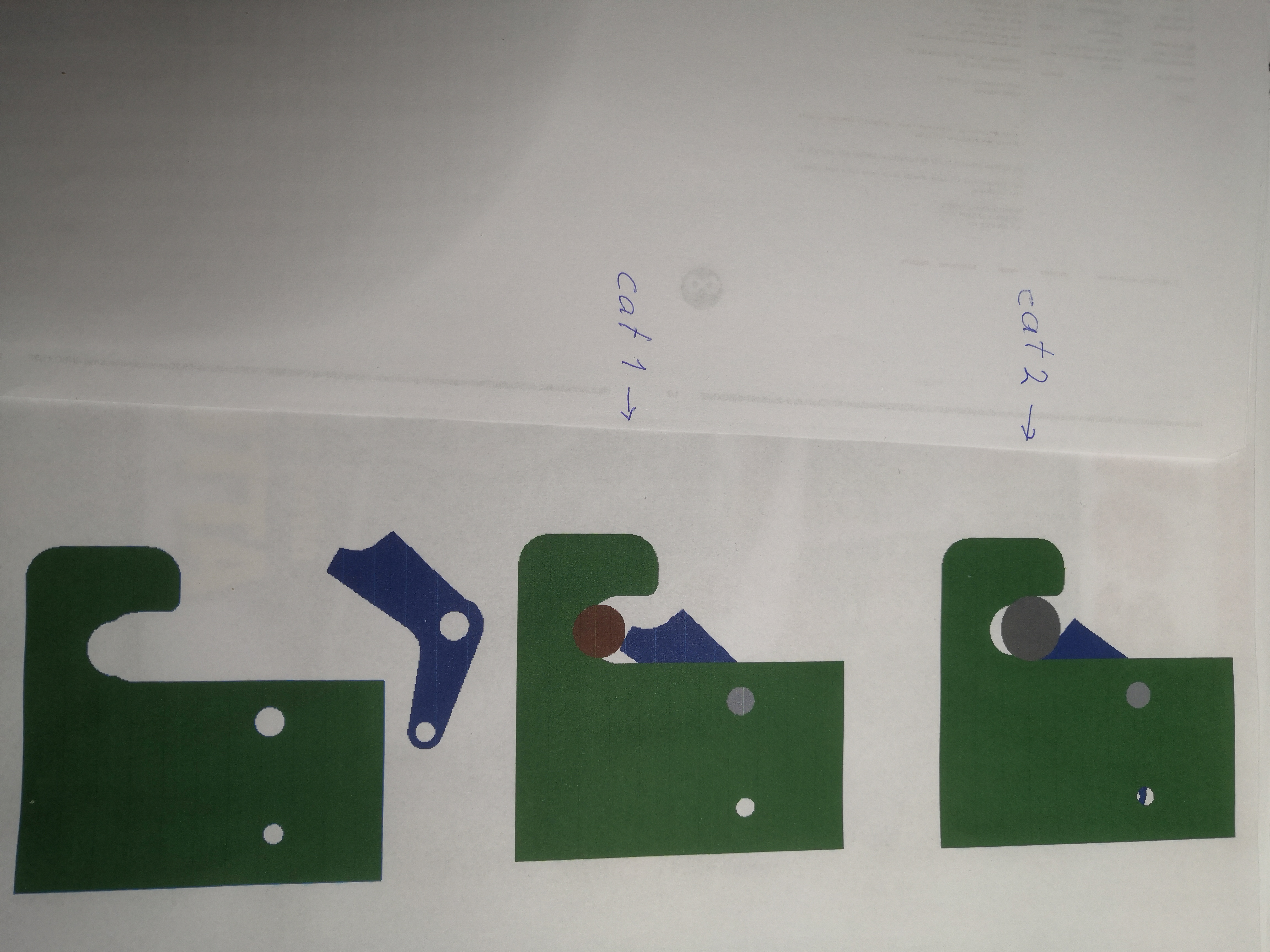

My NEW Weld on Euro Hooks and Balls
Weld on hooks and balls - YouTube
Markus
Great job! Much simpler and easy to use. Also doesn't extend further than it needs to, like the previous quick hitch.
I've found out that most cat 1 implements, don't have quite enough weight to push the latch on the lower hooks. I have to open the latch first, otherwise it will just lift the implement, instead of locking it in place.

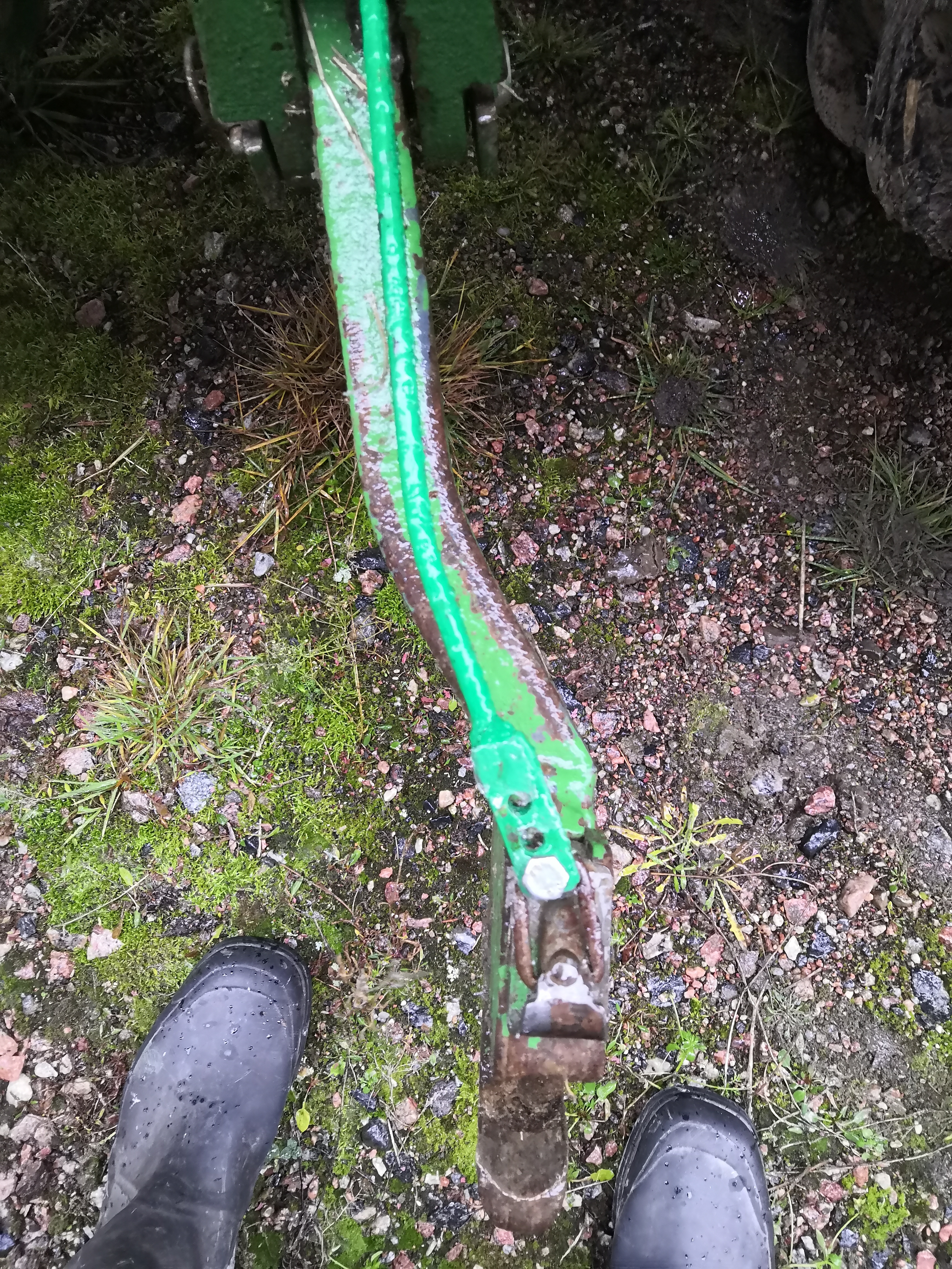

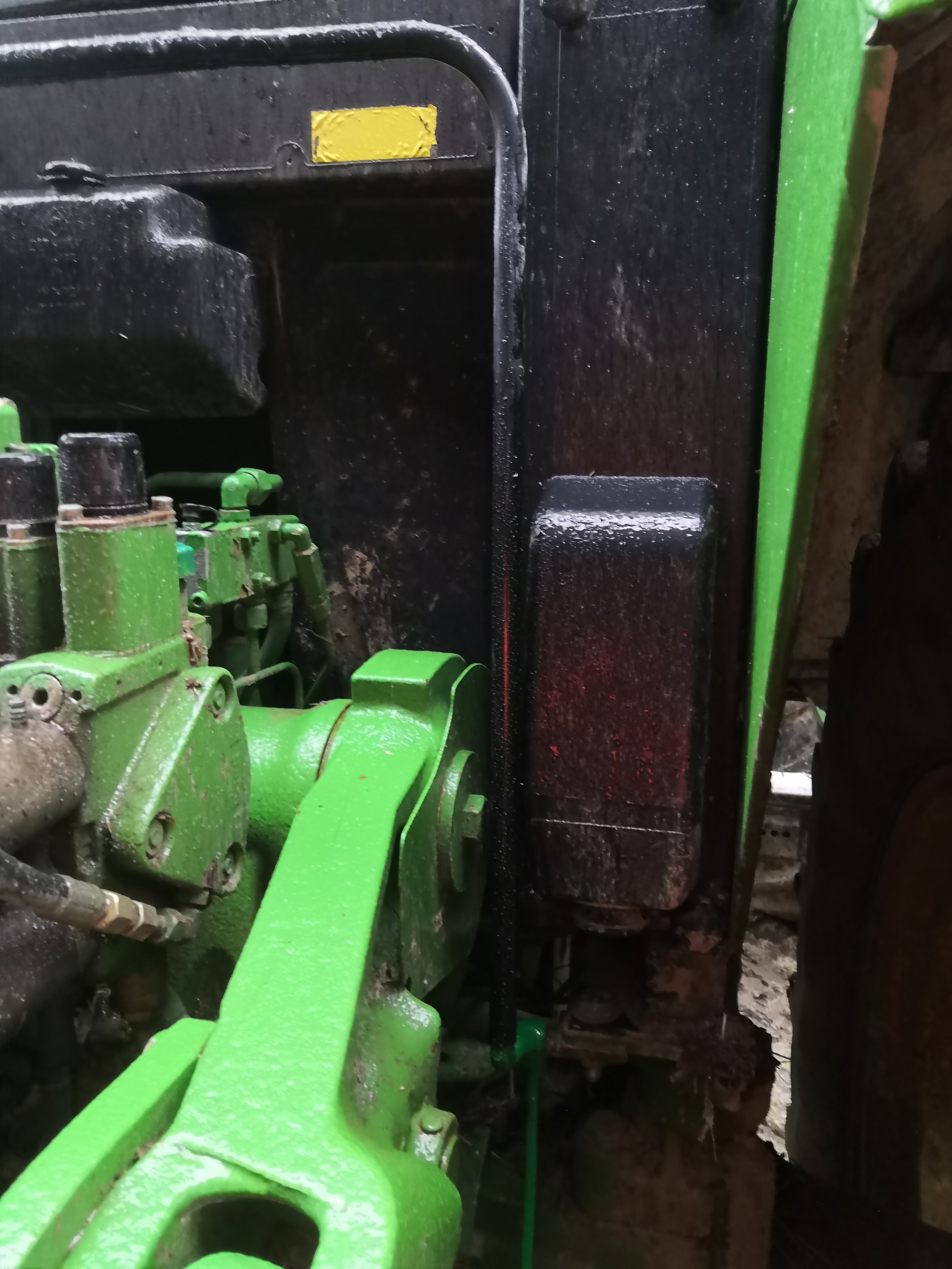

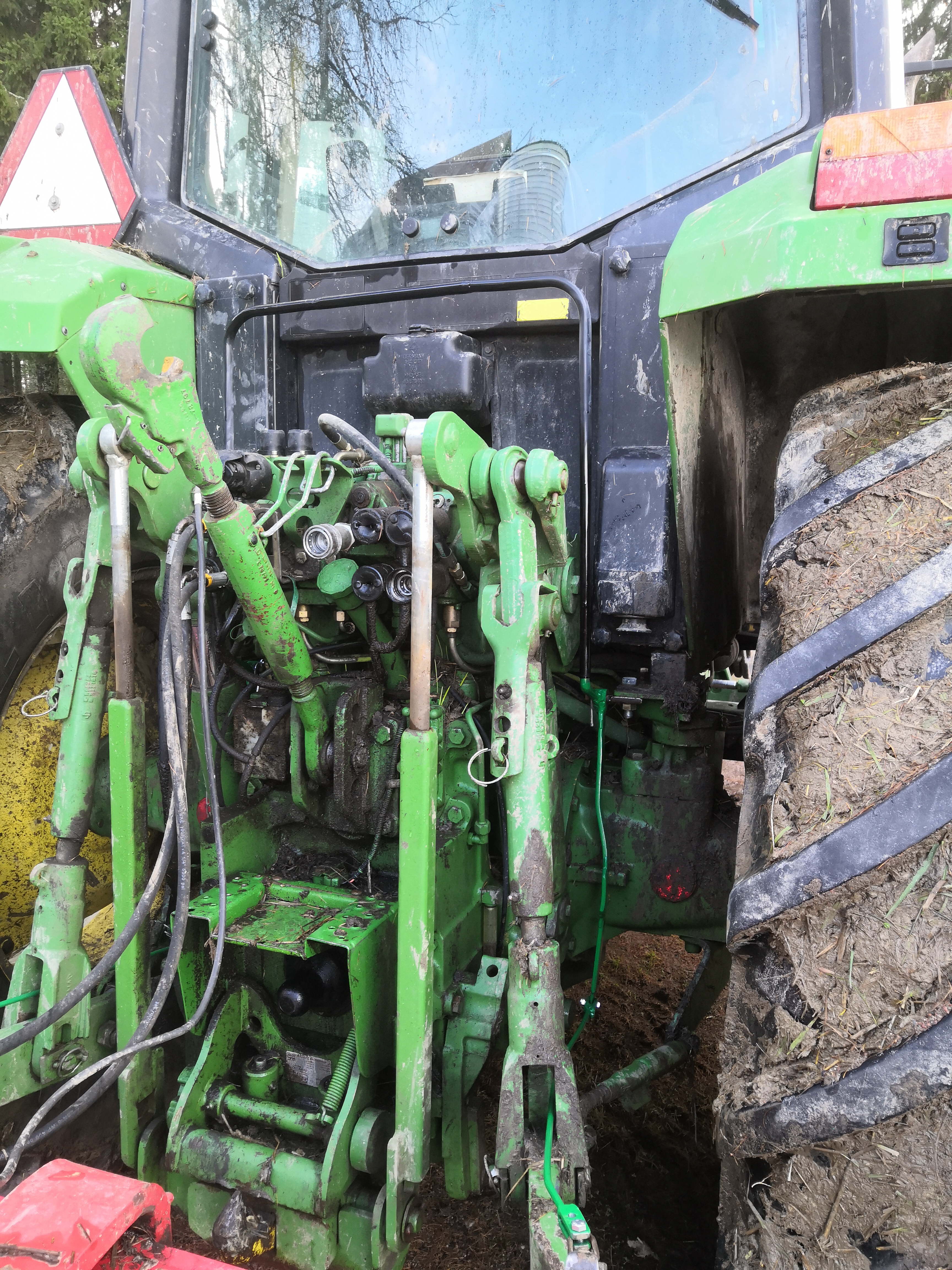

John Deere is ready now to be operated from its cabin for hitching/unhitching.
Before I made a linkage to open both hook latches together from the cabin for unhitching.
Now I have a new linkage to move the right lower link sideways from the cabin.
It makes possible to use two category equipment with the same tractor.
And non standard equipment too.
Parts are quit simply
And now it has a new hydraulic top link too.
I think that this is the most cheep way to operate from the cabin.
If you like then hydraulic stabilizer bars are good too but expensive.
I have made what I can. Now you must go on!

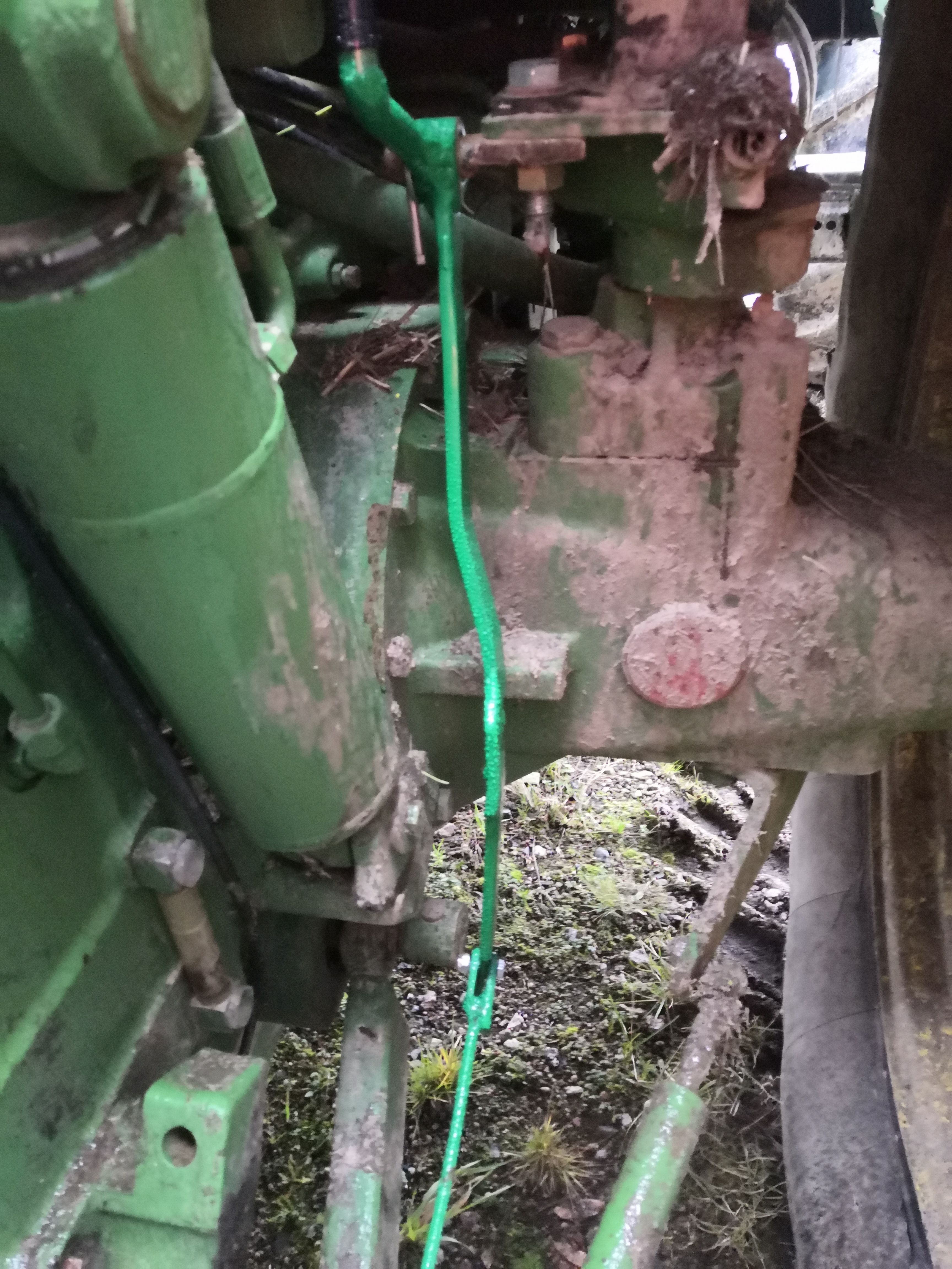

#37
New pictures of moving the stabilizer bar from the cabin when hitching the implement.
There is a new lever and linkage for the right spring loaded stabilizer bar and the lower link.
Left side locked stabilizer bar and hook latch opening rod.
This is my last video I have. Winter game to us. Hope getting better soon.
