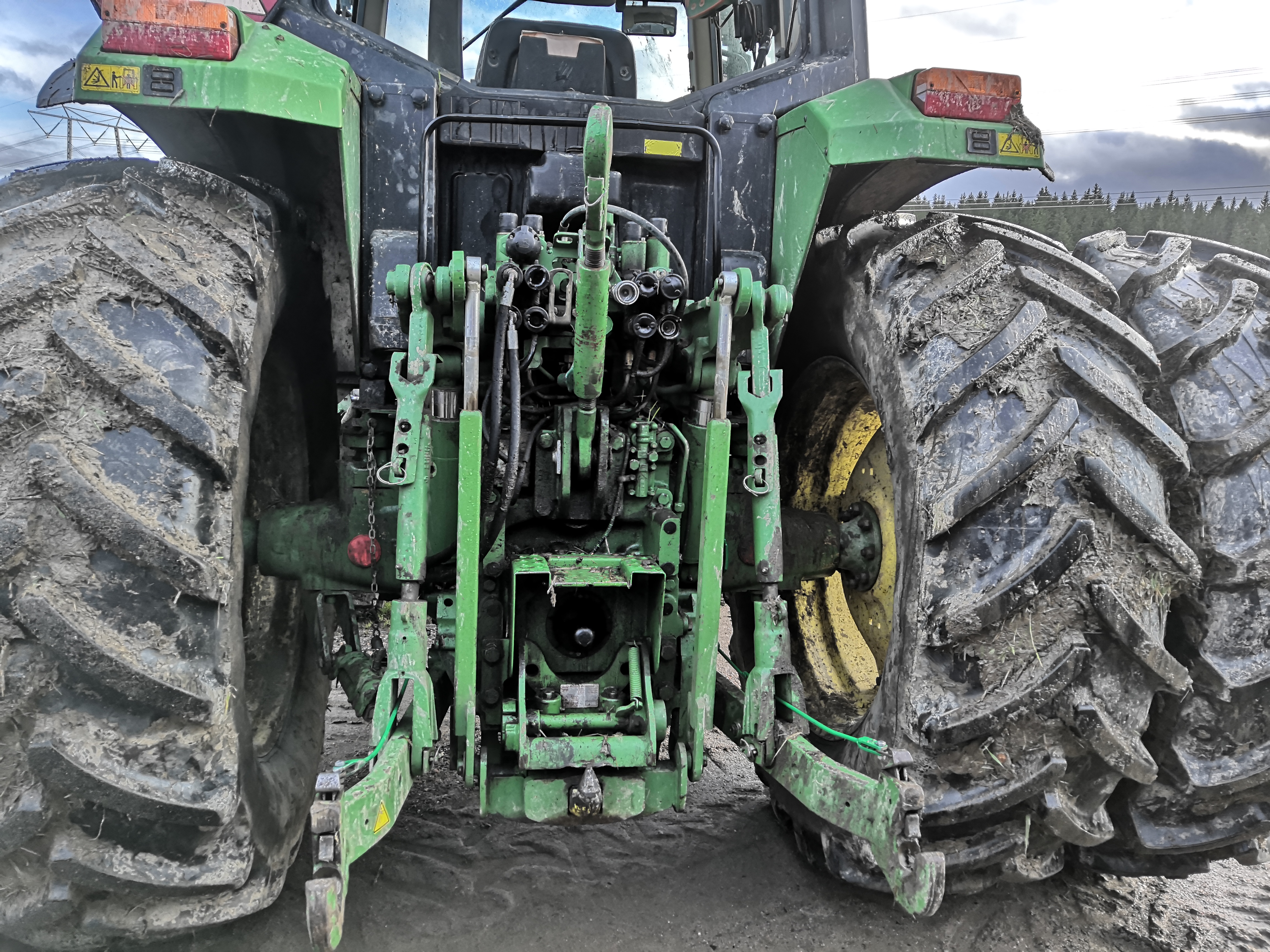

I have 4 spool valves for my 3-point hitch (and 3 more for all implements + 2 for the loader)
1 for the hydraulic top link
1 for the hydraulic leveling bar
and 2 for 2 hydraulic stabilizer bars
If all your implements have lower pins in the same distance and you use pin and hole stabilizer bars,
then you need only two valves, one for the hydraulic top link and another for the hydraulic leveling bar.

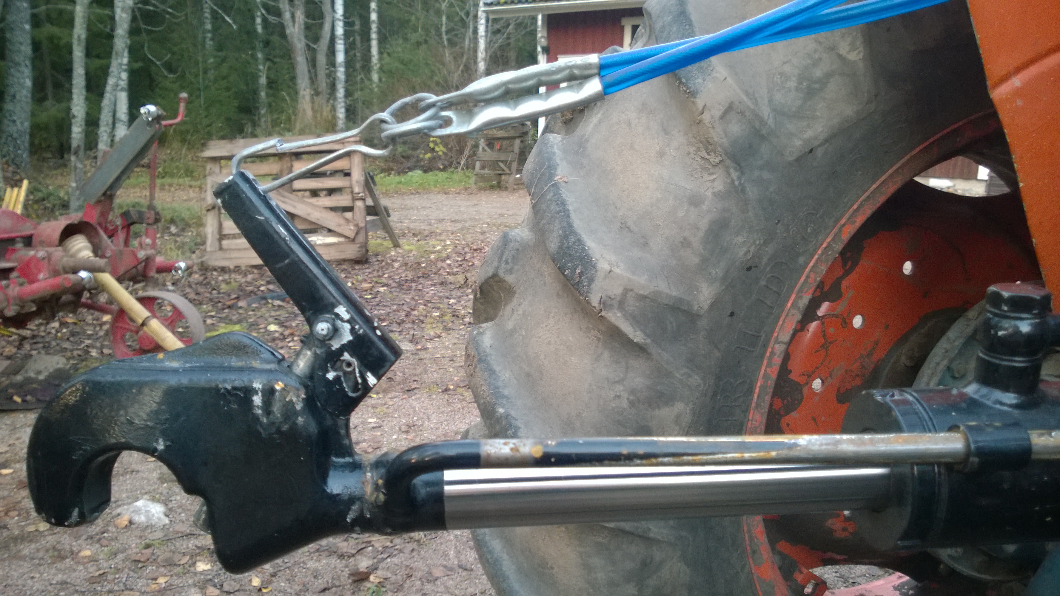

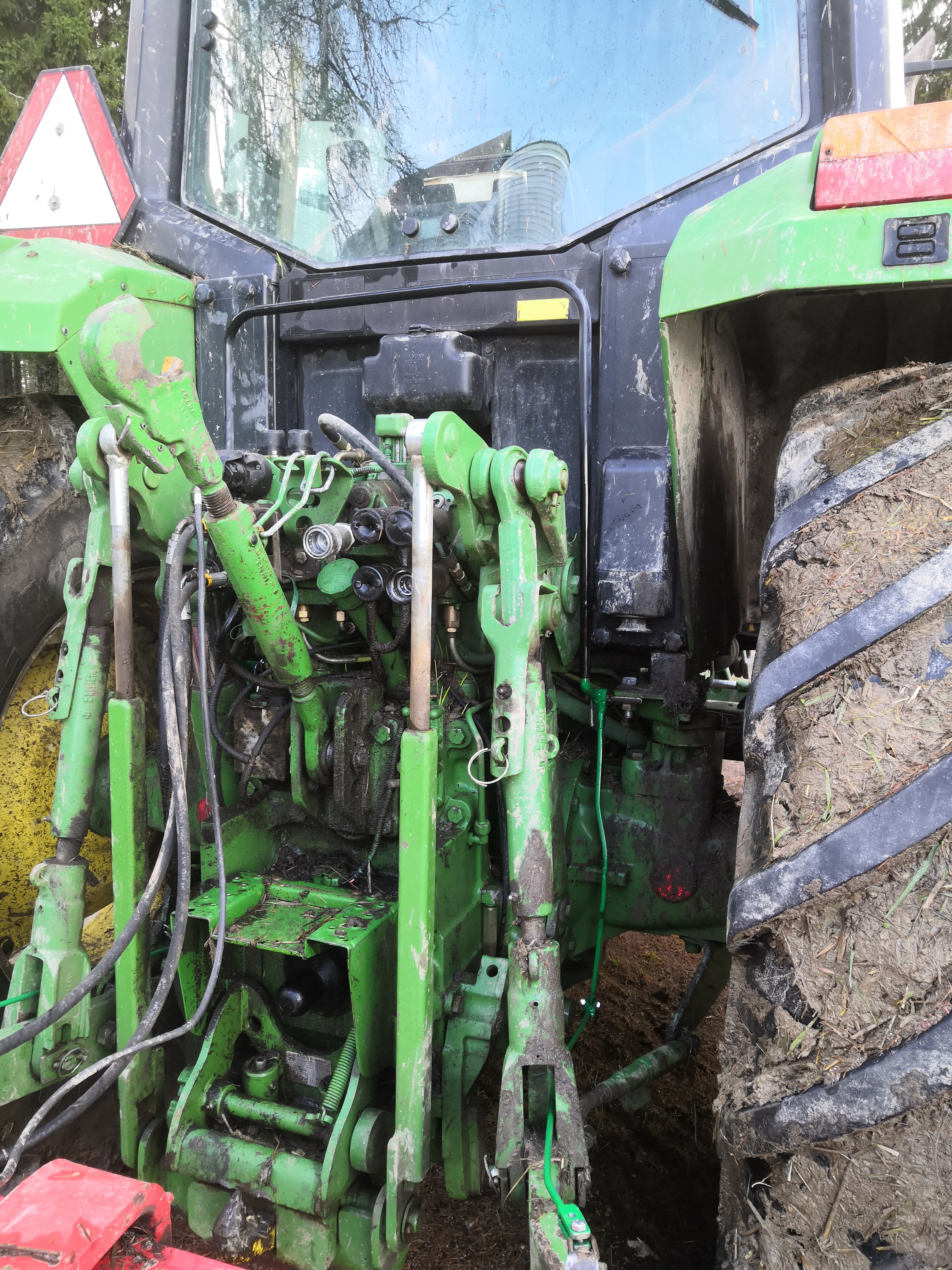

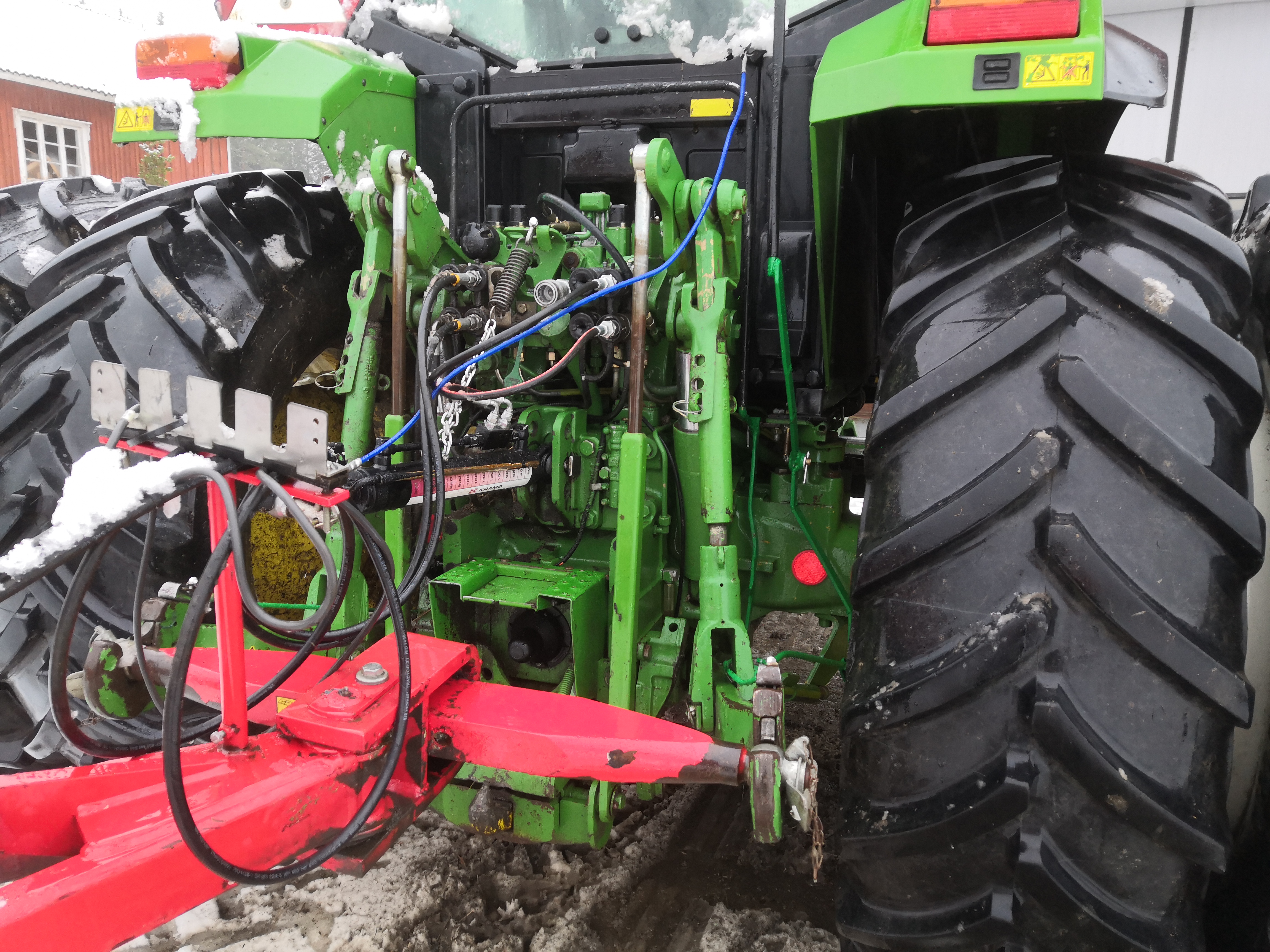

How to reach the levers? For small and medium tractors it is OK.
For bigger tractors we can use rope for the top link by open back window
With this blue rope we can guide the top link to top pin and both close and open its latch.
The pulling spring in the picture makes it easy to guide the top link.
I made my own lever system for opening and locking the top link latch because
the rope was hanging there and opening sometimes.
Long green lever opens both lift arm latches at the same time.
For biggest tractors it is possible to guide the top link as you write
with electric or hydraulic actuators and use solenoid for the latch of top link.
Weld on hooks and balls
Weld on hooks and balls - YouTube

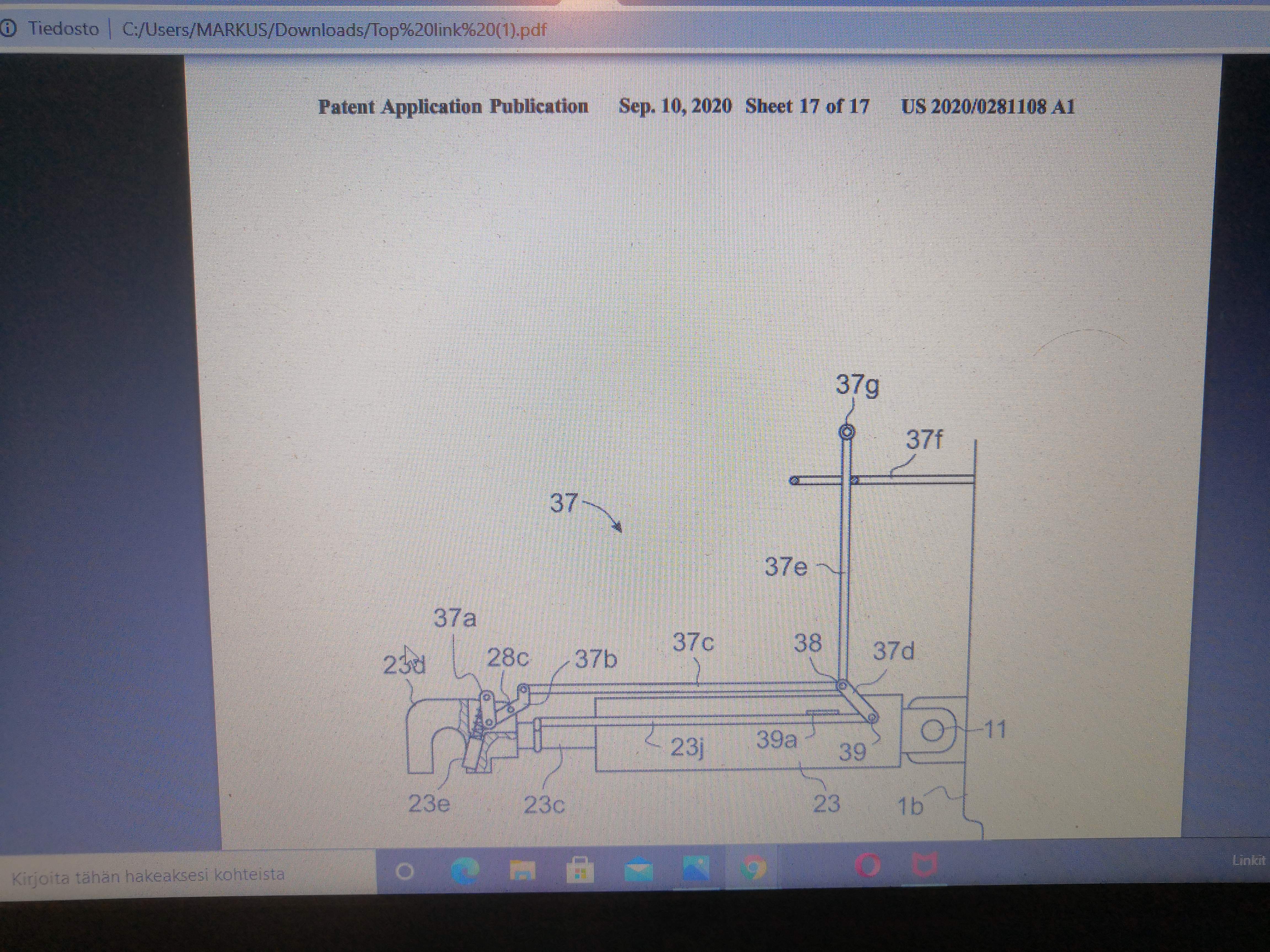

We can adjust the top link for BIG and LARGEST tractors from the CABIN by this mechanics too.
I have only this patent picture.
I only want to save lives of users of tractors.
In Sweden 1000 accidents only in one year recently.

Euro hooks are flexible and can be used from the cabin.
In Europa they use these by ropes .
Ropes are often broken at lower links. So driver has to go down to operate them.
Therefore I tried to to make more safe-
We need to go out of tractor only for PTO-shaft and hydraulic hoses
My Euro hooks:
Tractor weldable hooks and hook balls - YouTube

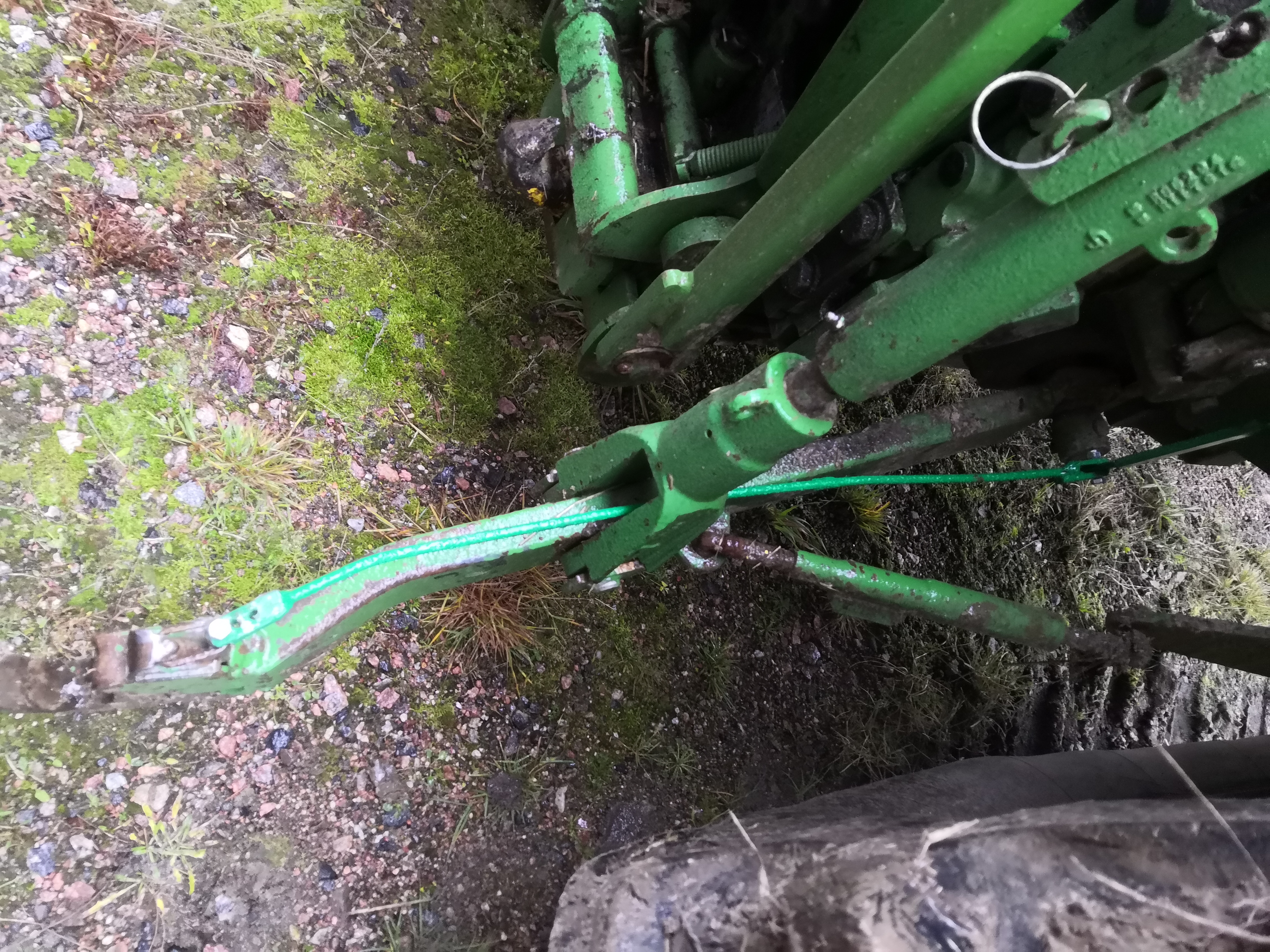

Some more pictures of my quick hooks:
I am waiting your opinions. Thanks!

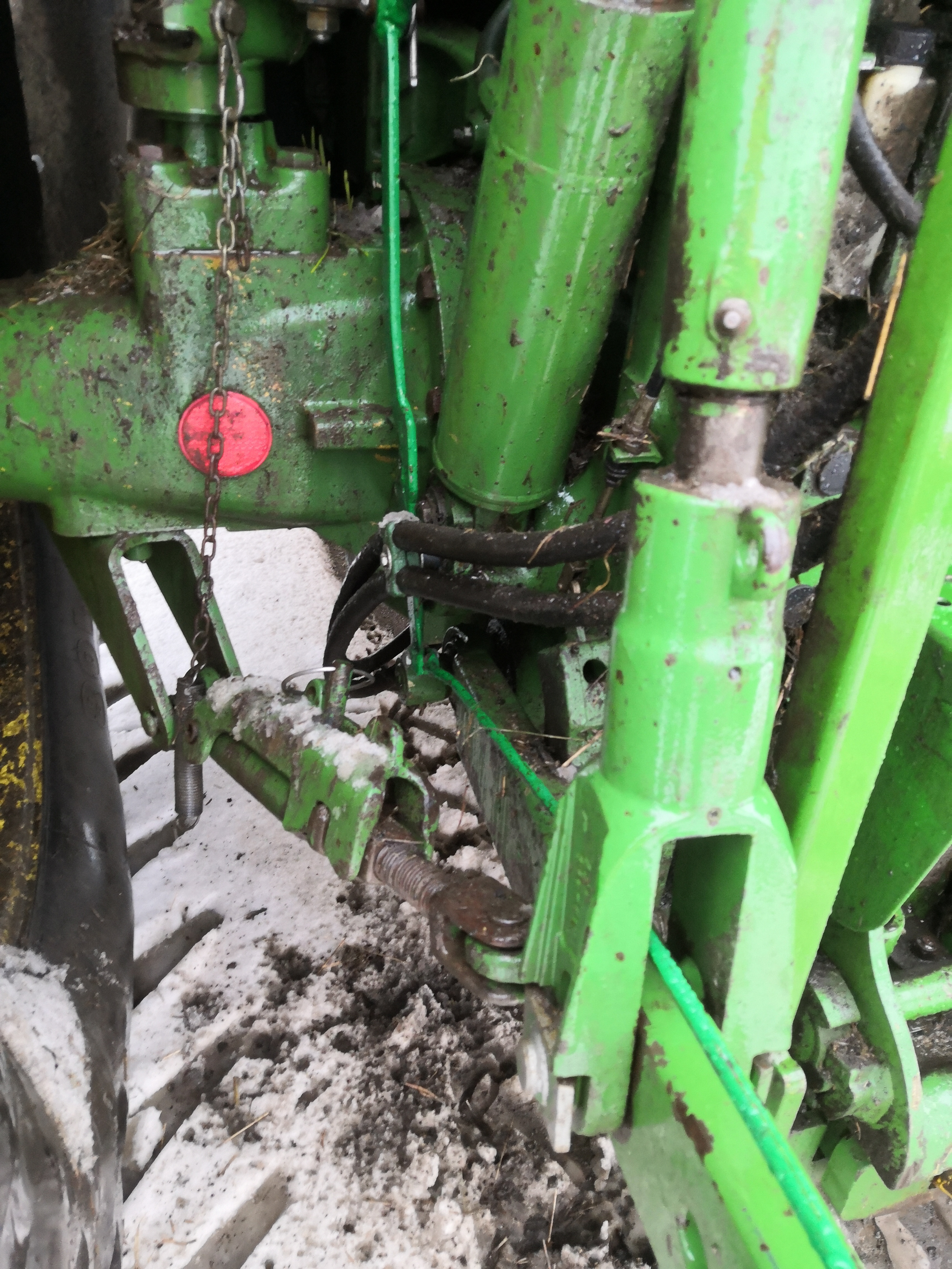

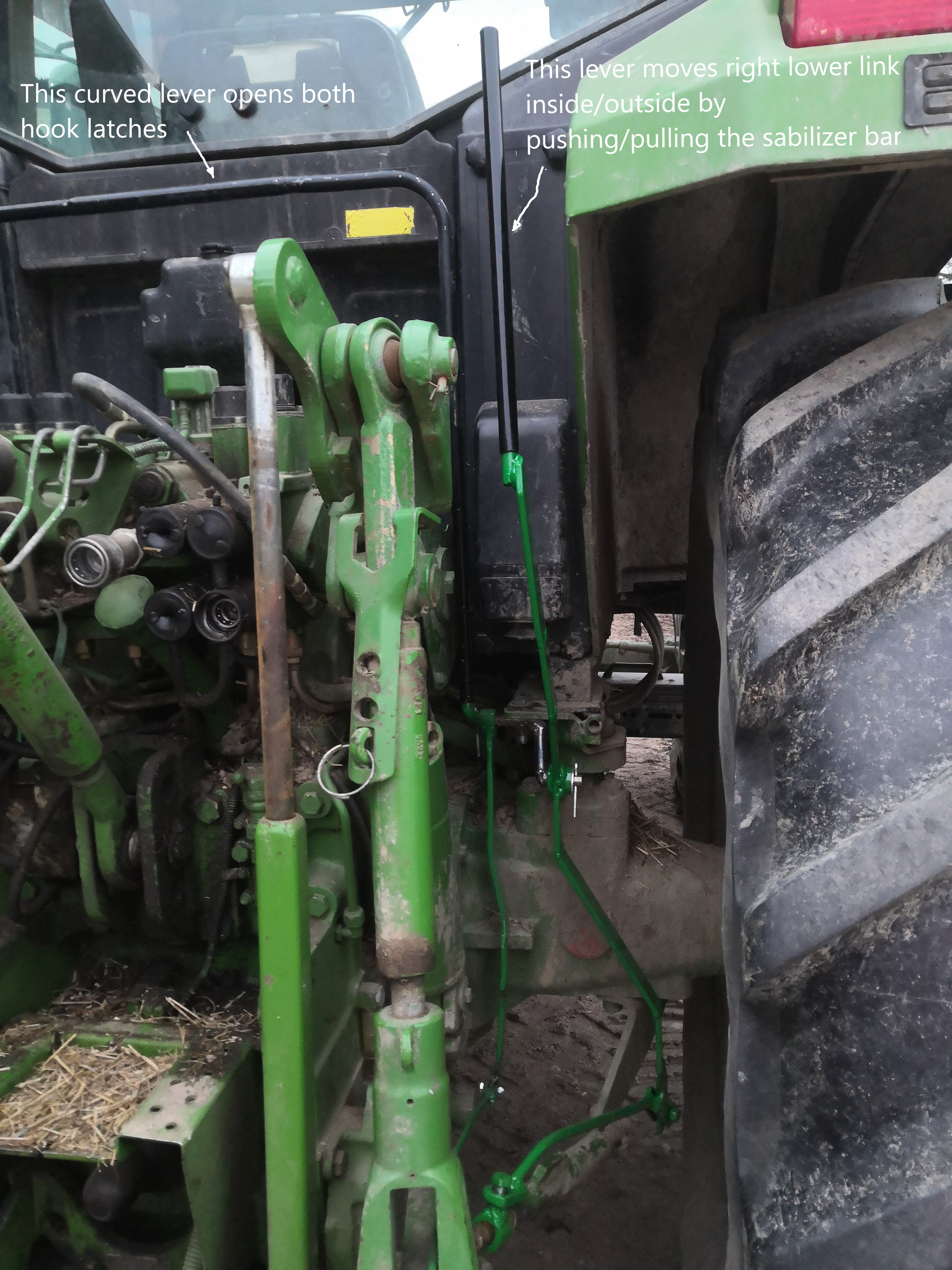

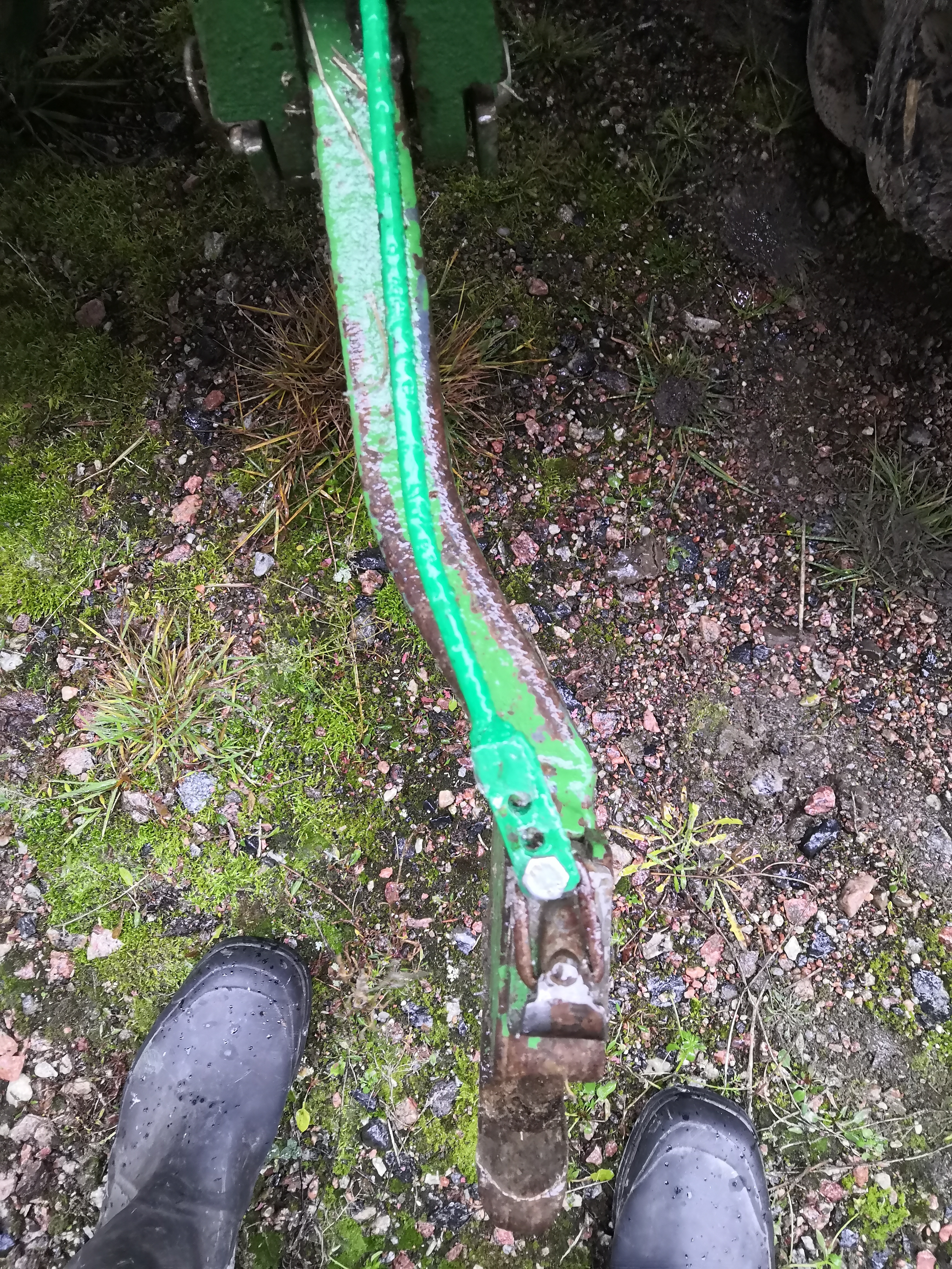

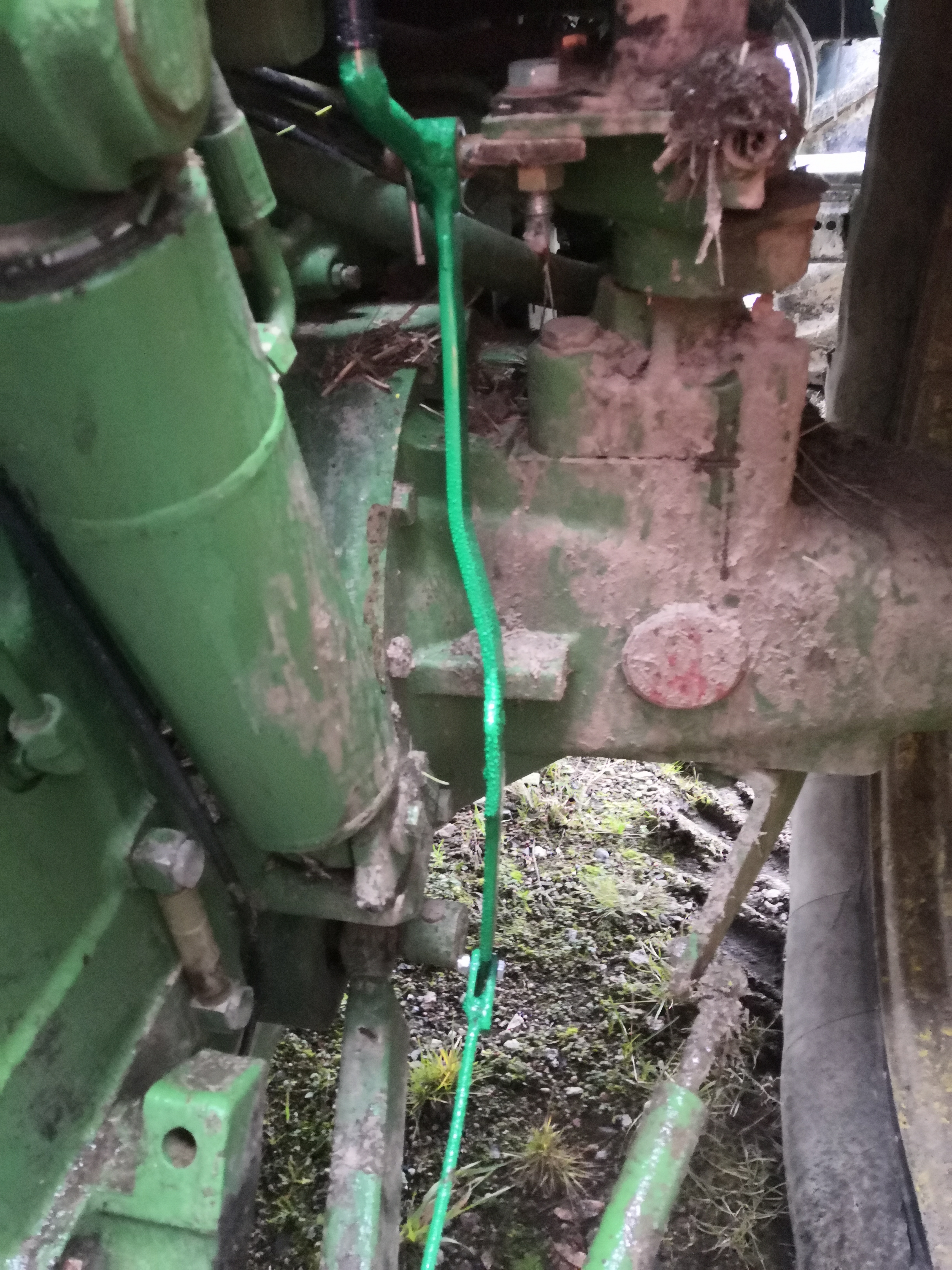

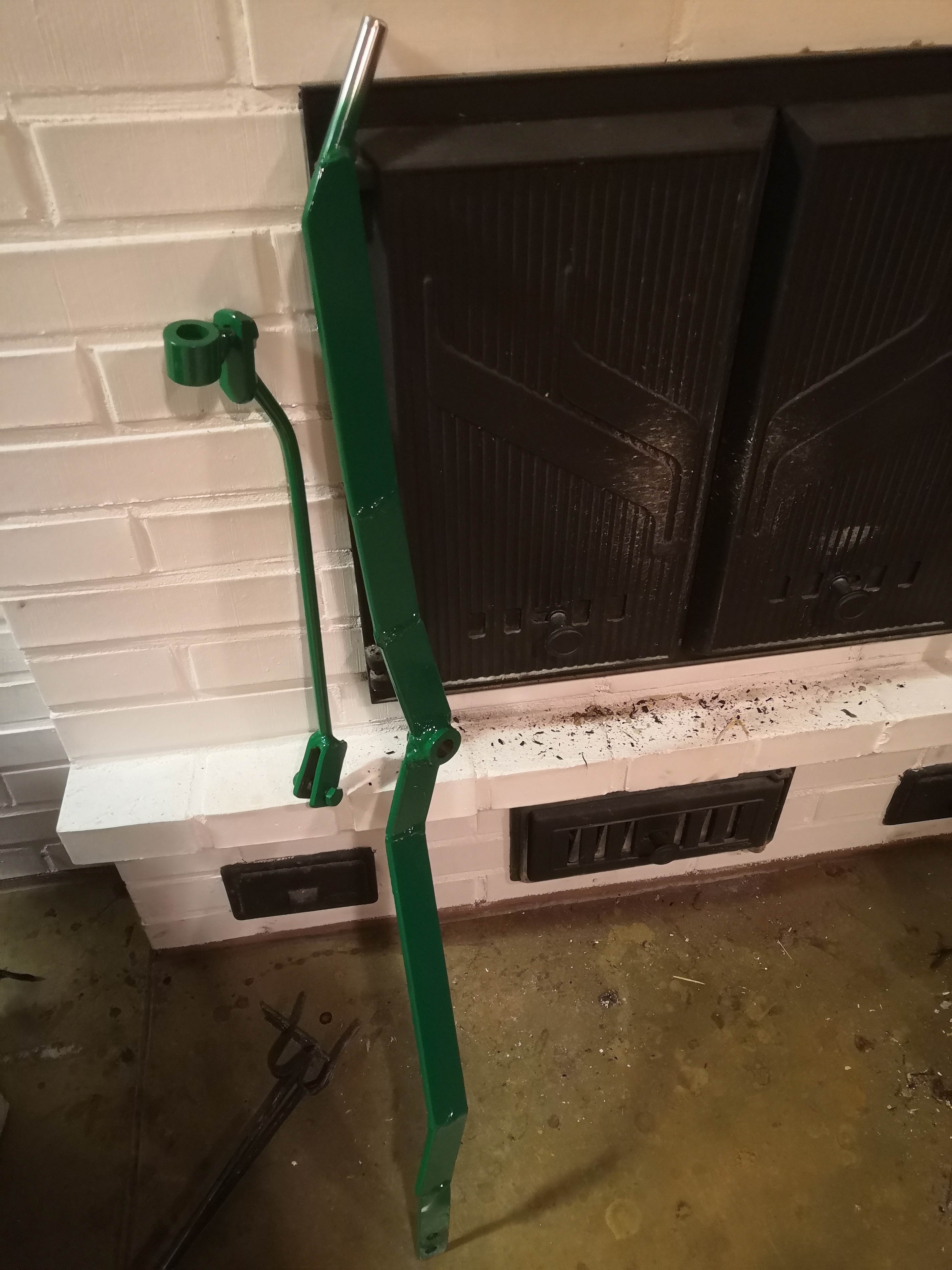

John Deere is ready now to be operated from its cabin for hitching/unhitching.
Before I made a linkage to open both hook latches together from the cabin for unhitching.
Now I have a new linkage to move the right lower link sideways from the cabin.
It makes possible to use two category equipment with the same tractor.
And non standard equipment too.
Parts are quit simply
And now it has a new hydraulic top link too.
I think that this is the most cheep way to operate from the cabin.
If you like then hydraulic stabilizer bars are good too but expensive.
I have made what I can. Now you must go on!
Good luck to you
Tractor Quick Hooks - YouTube
Markus

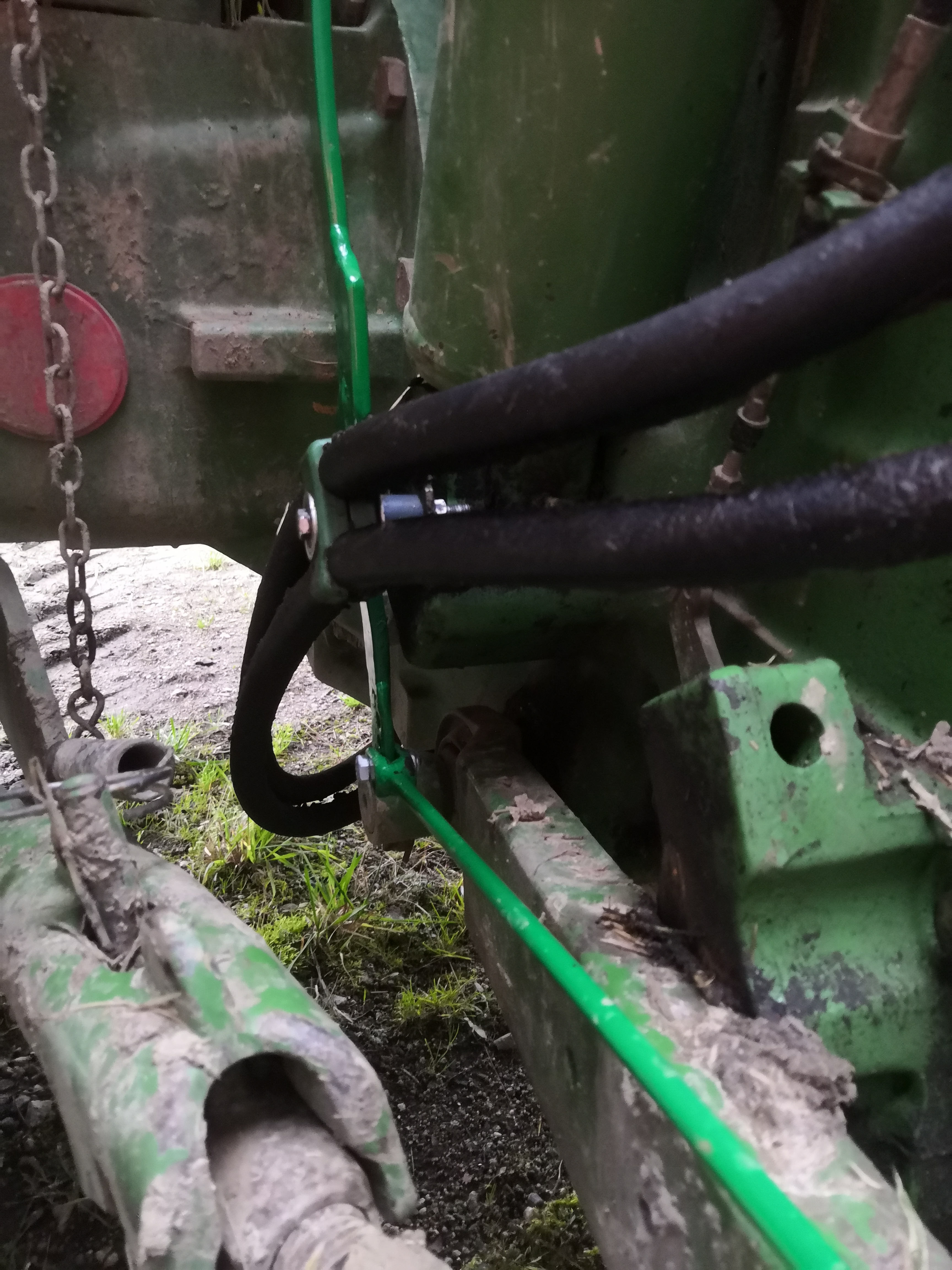

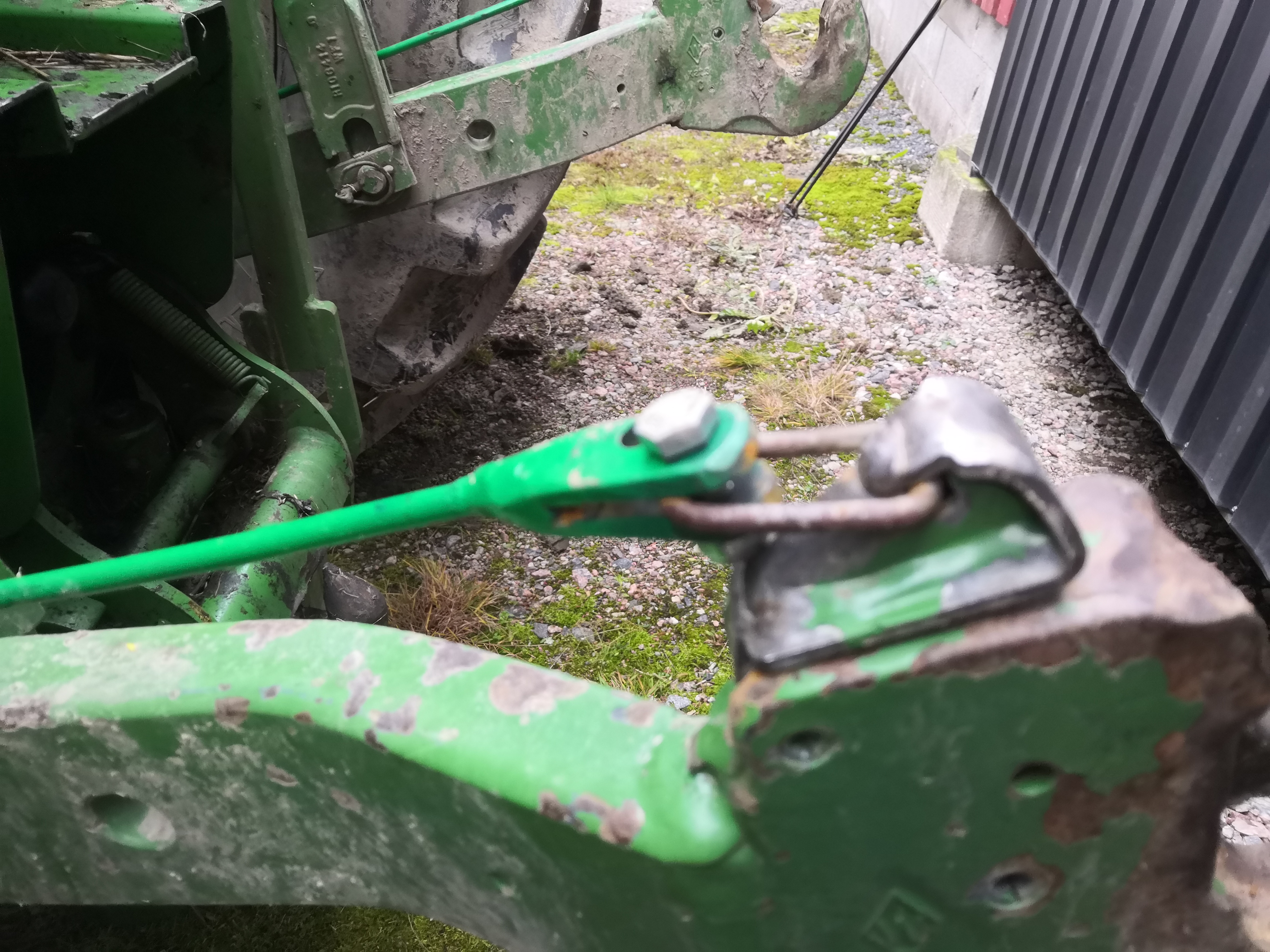

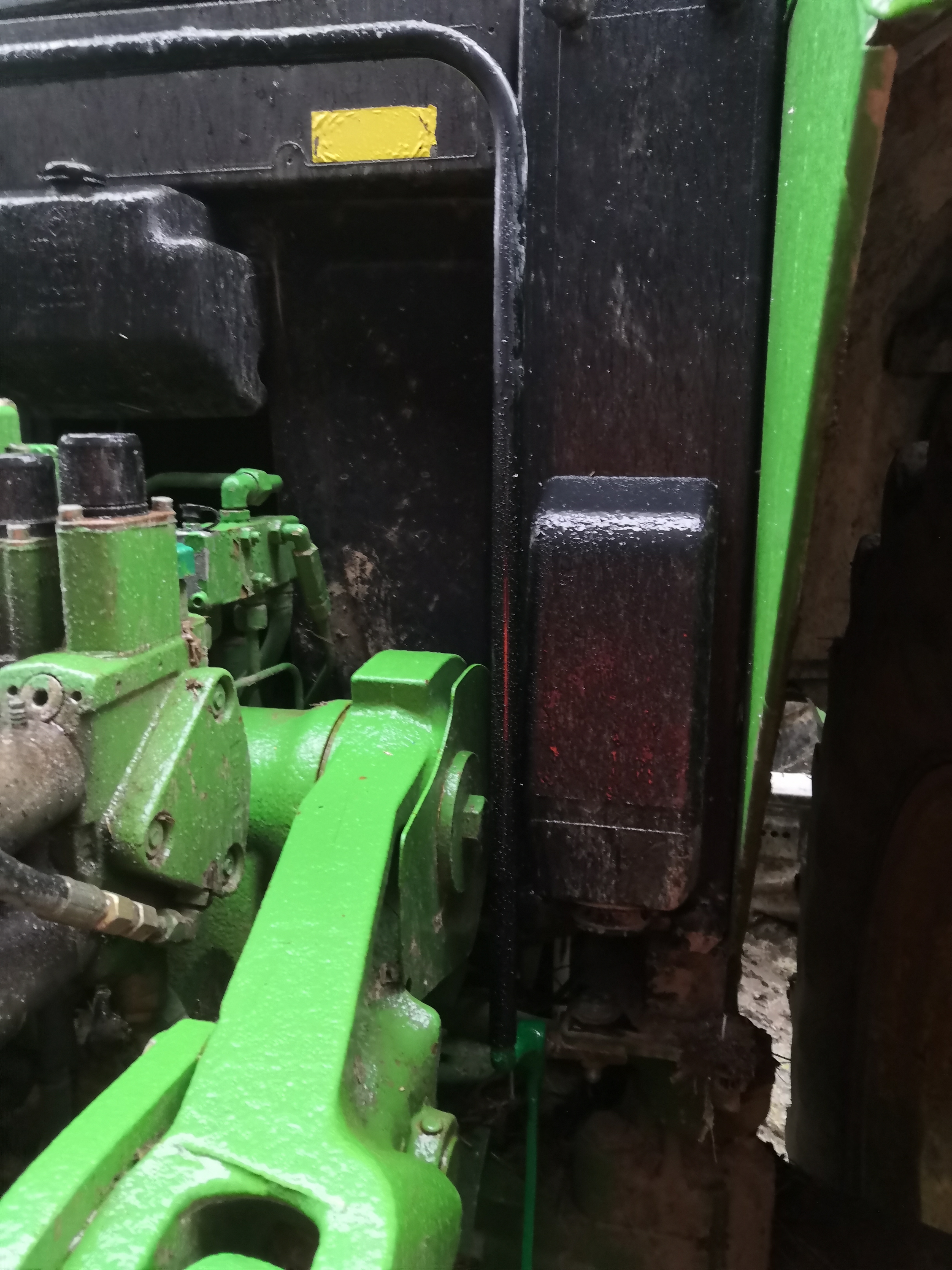

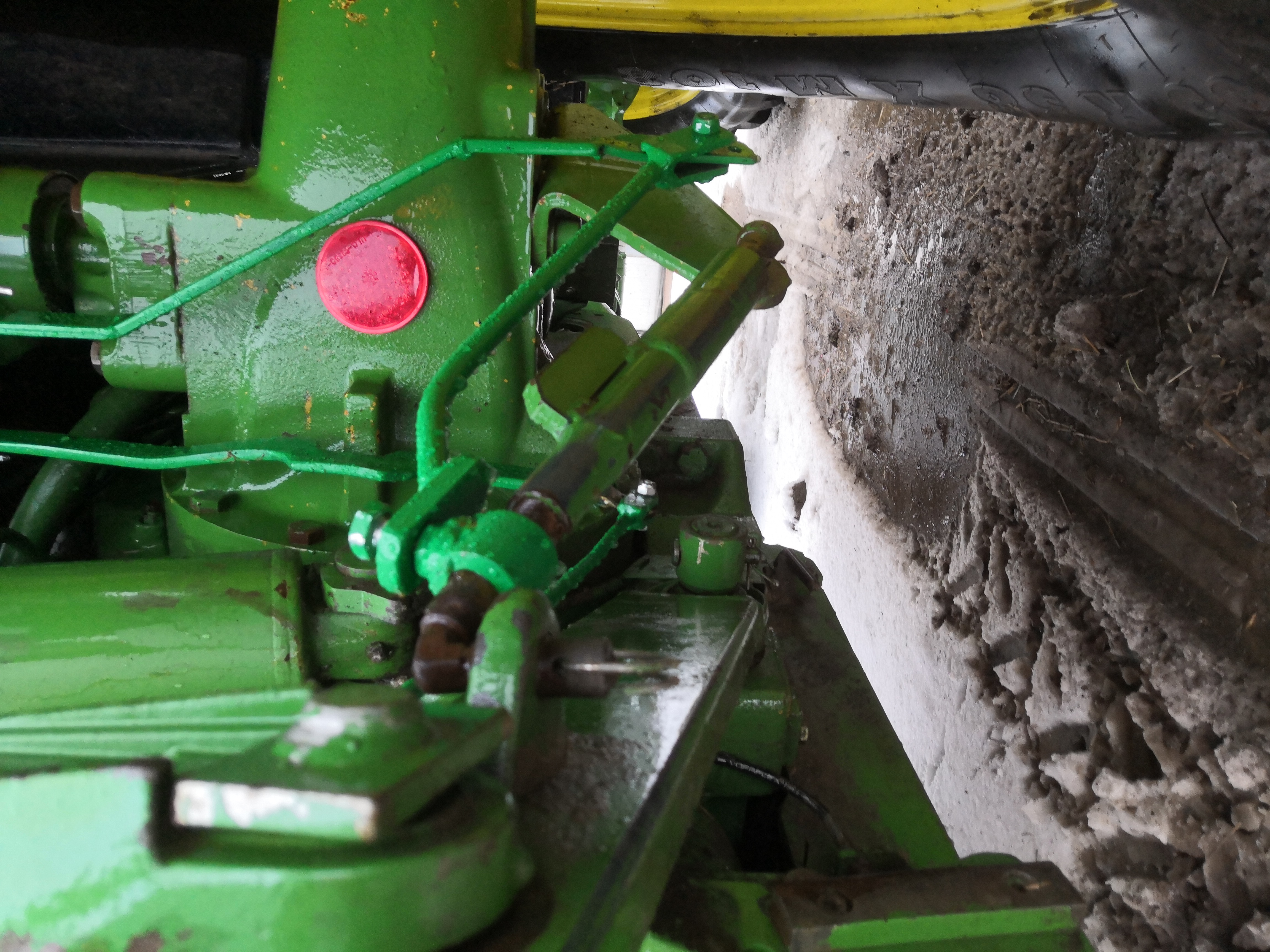

New pictures of moving the stabilizer bar from the cabin when hitching the implement.
There is a new lever and linkage for the right spring loaded stabilizer bar and the lower link.
Left side locked stabilizer bar and hook latch opening rod.
This is my last video I have. Winter game to us. Hope getting better soon.
