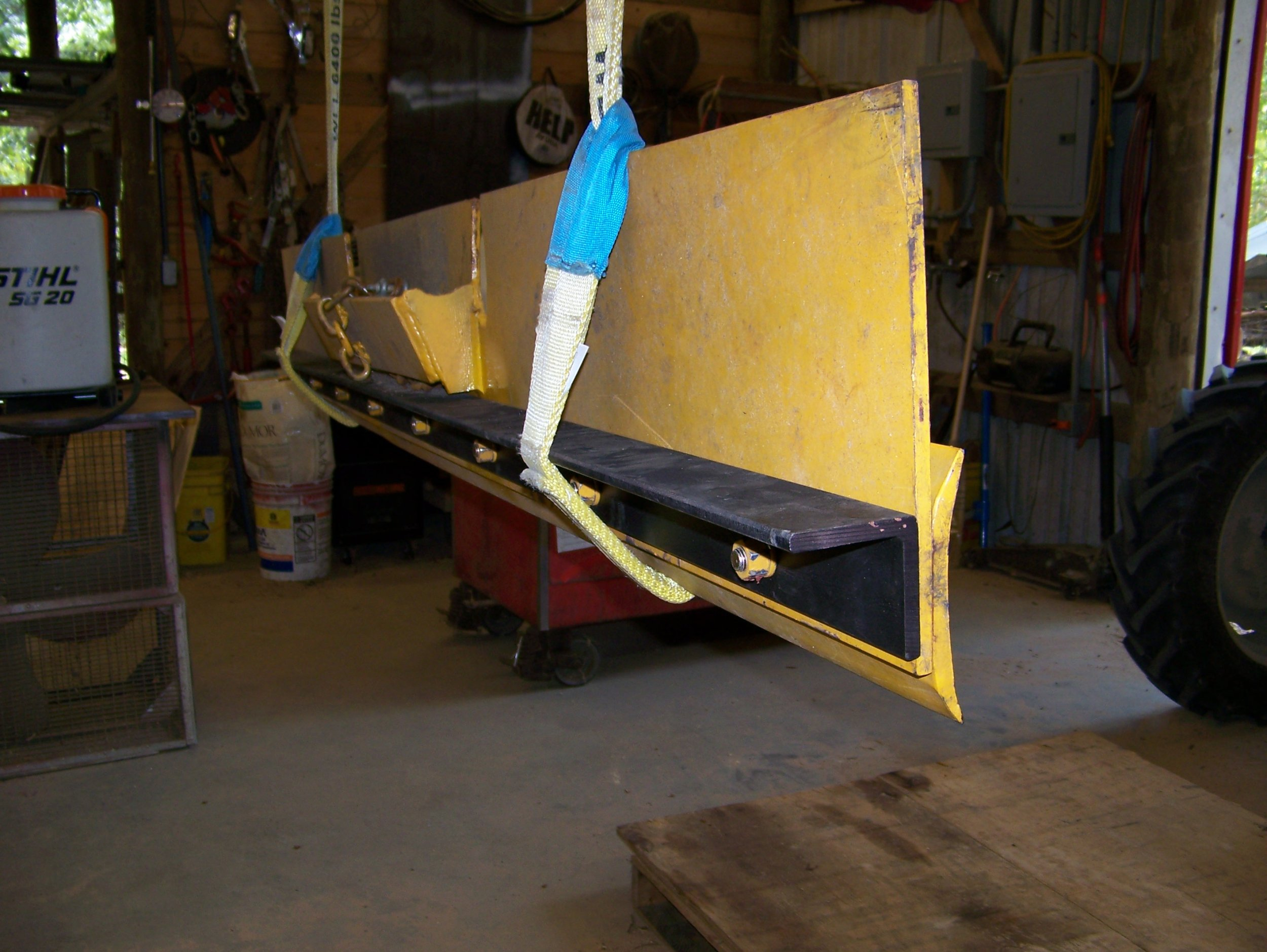

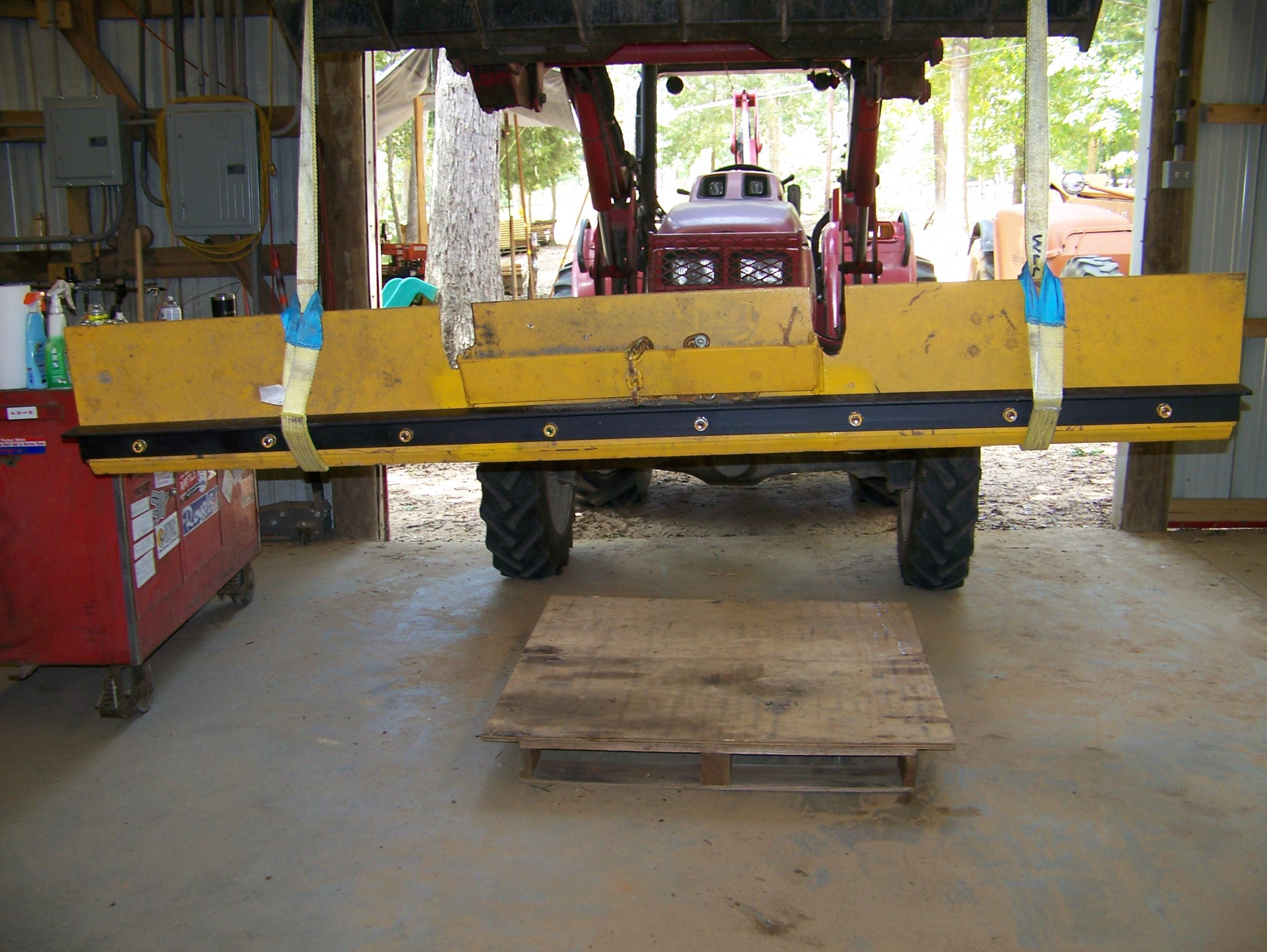

Got the CAT grader blade reinforced. 3x3x3/8th inch angle 8 foot long. I drilled #40 pilot holes and took it to my welding shop, were they punched the holes out for 5/8th inch plow bolts.

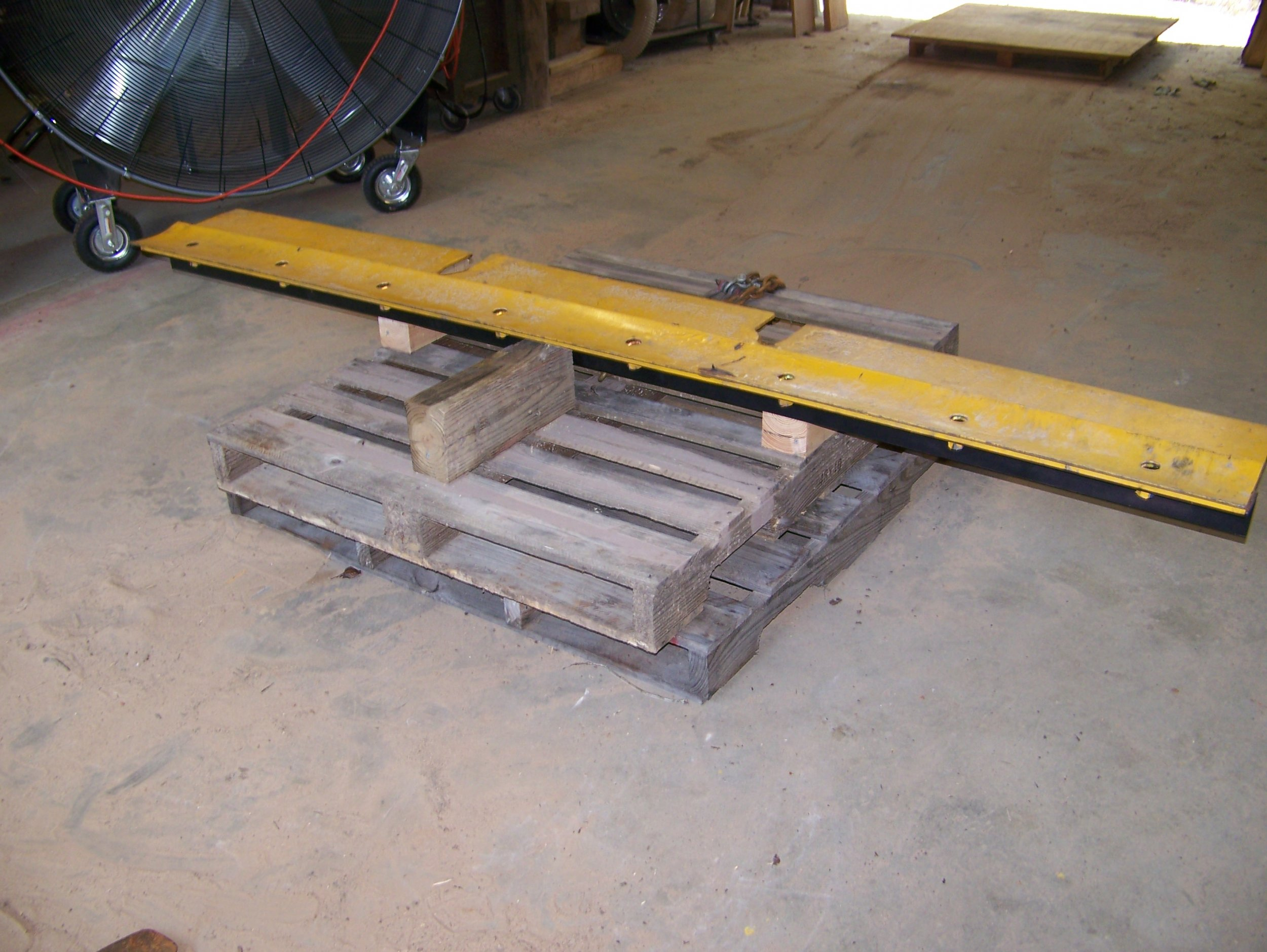

Made a transport cradle for the grader blade today. Now I can leave it outside. After a year or two, change out the bottom pallet.
With it positioned this way, I just curl the bucket level to the ground and crab in. If needed, I can slide
the blade a little, by hand, to get it in place, then chain it.
