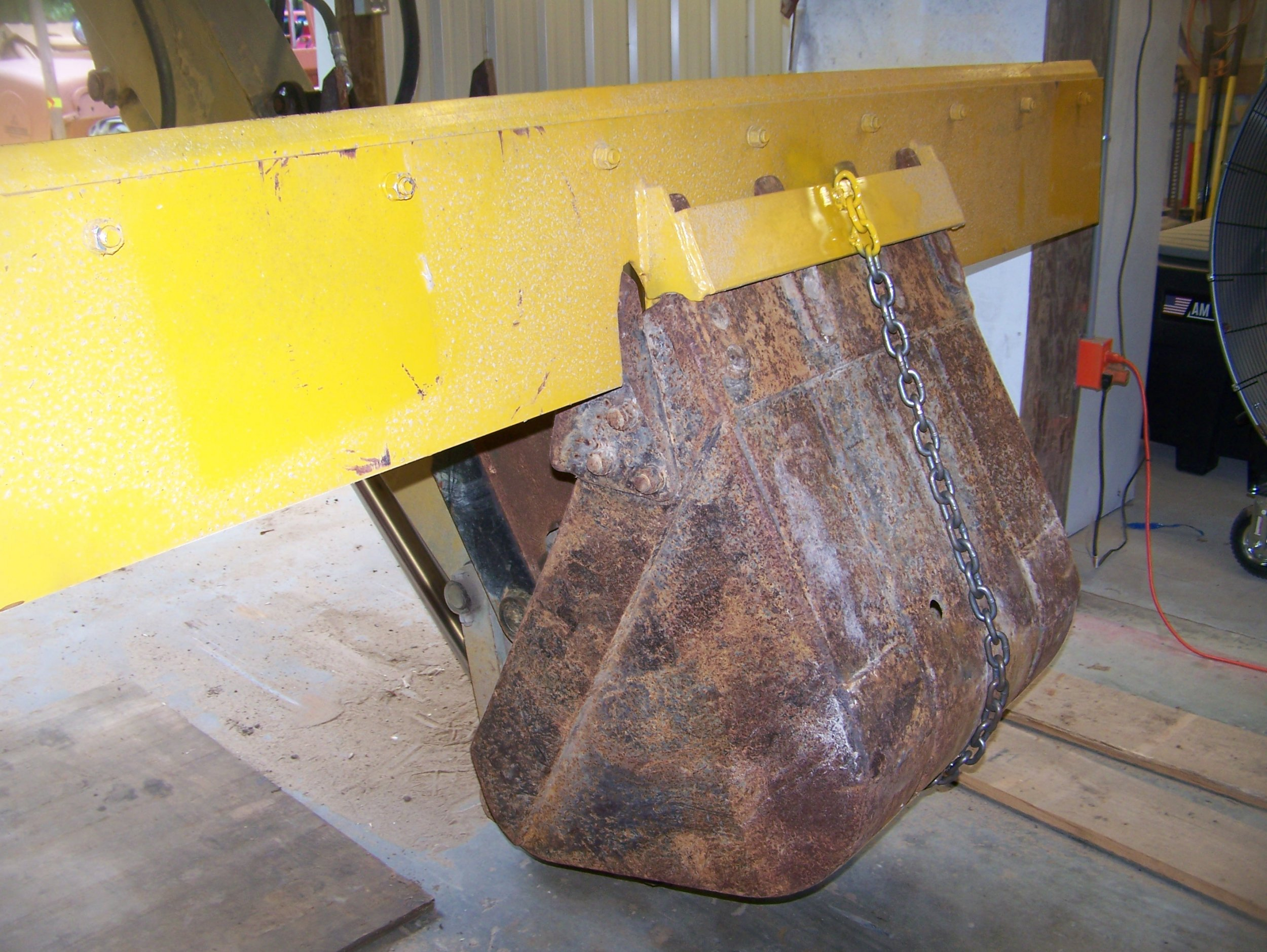

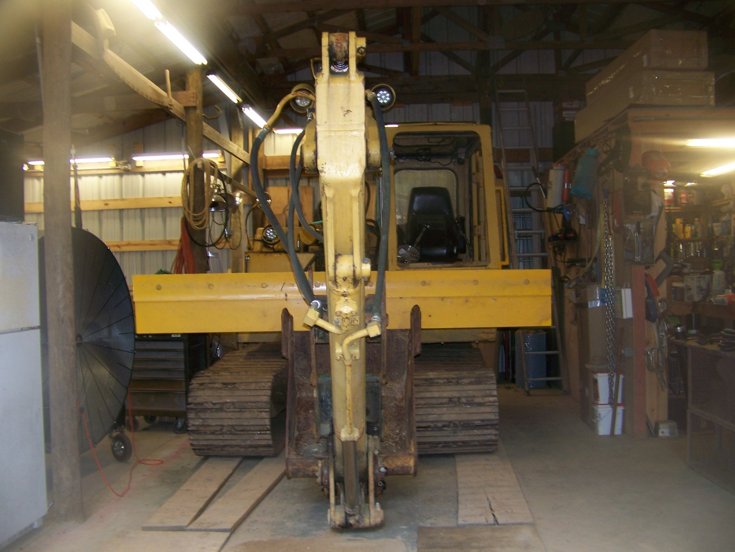

I welded the attach chain to the blade today. It is awesome.
However, I am going to add longer plow bolts and 3/8th thick 3 inch angle on back. Yes, I did tweak it. But I got it untweaked.

Seen that attachment. I don't think it would be compatible with the hyd. thumb. Not to mention running more tubing and another diverter valve plus more weight on an old, tired, turn table bearing. I have something like that on my telehandler, but the whole frame tilts and the fork carriage pivots.
Thanks! Years ago, I made a 6 foot one for my backhoe. Been wanting to build this 8 footer for 6 years.

That would be pretty handy. Is it stable enough with the mounting system?
It's the same mounting system I have been using for years on my backhoe. But this one is 3/8 inch thick. It's as strong as the teeth supporting it. Just need to reinforce the blade. My 6 foot one on the backhoe never bent because it would just pull the tractor backwards. But the CAT doesn't slide and thus the bent end. Just a pile of dirt straightened the blade back out. Ouch to my pride. Longer plow bolts are ordered and I can pick up the 3/8th inch angle tomorrow.
