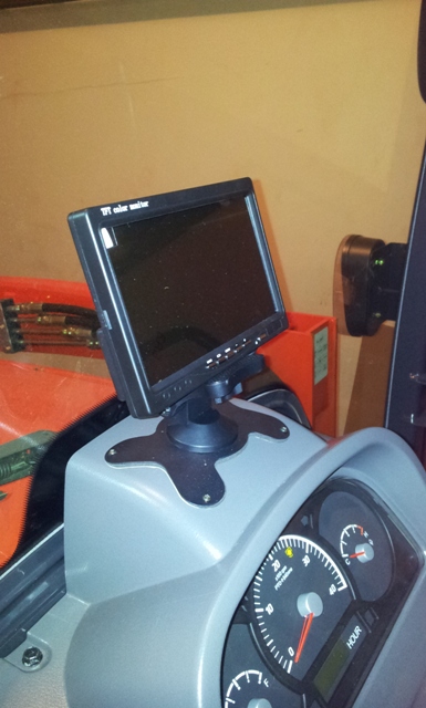

While we're talking about the NX-series fuse box, do you know what orange connector in the lower right of the attached pic is for? I'm guessing it's for the Kioti wiring harness for the 7-pin trailer kit.
Also, if you decide to relocate your back-up camera monitor from the door handle, here's how mine looks mounted to the dash/cowling with the original mount that came with it.

I was doing some road grading yesterday with a 7' box blade, and it was nice to be able to keep my eyes straight ahead at the same time I watched both the material in the BB and the track of the right side of the BB when grading to the edge of the road. When grading in reverse, I didn't have to twist around to see where I'm going. Very slick.
I did end up rerouting the monitor cable through the dedicated chase under the floor mat after I was able to pull the left interior fender cover. Much better installation than what I'd previously planned, which was to route it in a molded recess of the floor mat.

I don't see the attached photo. Under advanced, select and upload, then post. :)
Good job on routing the cable. Far safer there. FWIW, I did not want to obscure my forward view. For that reason I mounted the monitor on the right side door.
Edit: I see that you edited the attachment. As I recall from the service manual, the orange plug is the diagnostic plug. Only special connector and special software can use it. The seven (round) pin trailer connector plugs right into an unused plug behind your washer fluid reservoir without any additional fuses or relays needed (although I have not tested mine to see if it works, I did get a 7 pin to 7 blade adaptor from Hopkins though).
